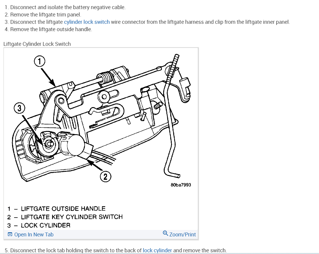

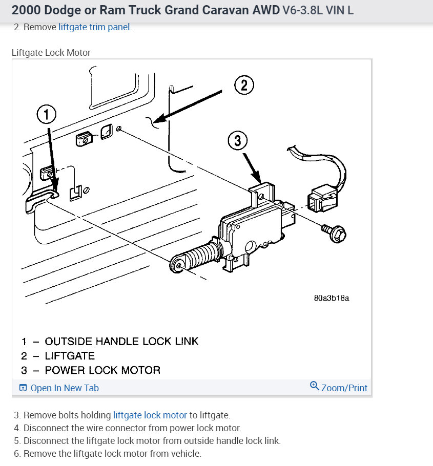

We only handle one problem per thread so please start a new question for the serpentine belt. I don't see a rear hatch emergency release so you will need to remove the inner panel from inside the car and work the latch, once open you can re-adjust the sticker to help the latch open more easily. Check out the images (below). Let us know what happens and please upload pictures or videos of the problem.

Thank you, Ken L, for the answer about my rear hatch being stuck shut. to open it i took out the little rubber seal/gasket in the center of the 2000 grand caravan, stuck a screwdriver through the hole - pretty much straight in - about 2 inches and felt around for something to lift up. it was easy to find and do. once i got it open i took out the screws holding the inside cover of the hatch, without taking the cover off i just lifted the cover (from the bottom of the cover, but it was up in the air because it was open) enough to pop free the two clips on each side underneath the cover that hold it on. then i just stuck my head in the opening and i could see that the little upside down shepherds hook (that moves with the accordion looking thing) had come out of where it connects and i put it back in. then i popped the cover back onto the two clips on each side, put back in the screws and voila it works fine now again, and it was very simple to do.
