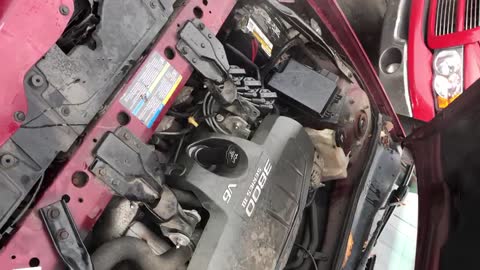

I went back yesterday, i put more oil and got another jump and the car came to life. i got help flushing the radiator out. the car wasn’t running hot. i change the air filter also (reduced power light went away). the car may need spark plugs (next project i guess).
Nov 8, 2019 at 7:03 AM
The battery is dead.
Did you have it running? If you did, does the engine make any noise while running?
Nov 8, 2019 at 7:54 AM

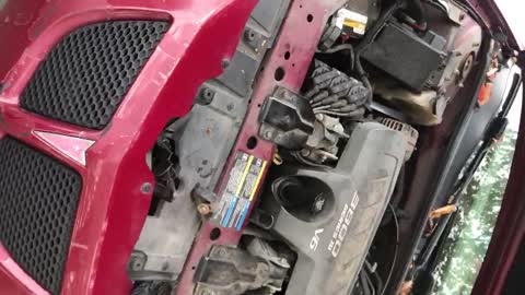

YOUNGHB
  • 4 POSTS
The battery was fine according to AutoZone. i believe she just needed some oil in her. i’m glad the engine didn’t lock. also glad i saw that ugly coolant. the video is during the flush..
Nov 8, 2019 at 6:54 PM
No, the battery is dead. Remember, they employ parts salesman not technicians. From your video, the battery does not have enough power to start.
Start there by either charging it to 12.6 volts or replacing it.
