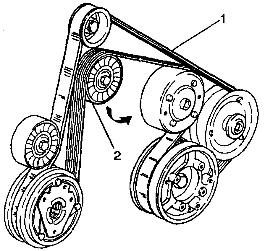

Is the tension on a 3800 motor serpentine belt adjustable
1998 BUICK PARK AVENUE
190,000 MILES • 3.8L • 6 CYL • 2WD • AUTOMATIC
DCKELLEY
  • 125 POSTS
My serpentine belt is loose on my car with the 3800 base. i bought a new belt but I'm not sure that's the problem. i checked the tensioner as best i know how. there is a lot of slack. when i but a wrench on the tensioner it seemed tight but when i pull on the belt the belt and tensioner move quite a bit. not sure whats normal. can the serpentine belt be adjusted in any way or am i looking at a new tensioner? going to put the new belt on tomorrow.

i also need a routing diagram for this car. i can't seem to find that information anywhere.

The belt is not adjustable. Tension is supplied by the serpentine belt tensioner. Although you feel tension when you place the wrench on it, chances are it is bad if the belt is loose.
First, here is a link that discusses belt routing for your vehicle:
https://www.2carpros.com/diagrams/buick/park-avenue/1998
Next, here is a link that shows in general how to replace a belt tensioner:
https://www.2carpros.com/articles/how-a-serpentine-belt-tensioner-works
https://www.2carpros.com/articles/serpentine-belt-tensioner-replacement
Here is a link showing how a belt is replaced:
https://www.2carpros.com/articles/replace-serpentine-belt
Now, your vehicle is a bit more tricky to replace the belt than most because one of the engine mounts needs removed to take the belt off. I am going to supply the directions for replacing the belt which is specific to your vehicle. All pictures attached correlate with these directions. You will need a jack to stabilize the engine so you can remove the mount. Make sure to follow the directions and be careful.

The accessory drive belt drives all engine mounted accessories. All driven accessories are rigidly mounted to the engine. Drive belt tension is maintained by a spring loaded belt tensioner. A belt squeak when the engine is started or stopped is normal and has no effect on belt durability. The drive belt tensioner can control belt tension over a broad range of belt lengths; however, there are limits to the tensioner's ability to compensate. Using the tensioner outside of its operating range can result in poor tension control and/or damage to the tensioner.
Important: Ensure that the wood block extends past the width of the oil pan in order to avoid damage.
See Picture 1

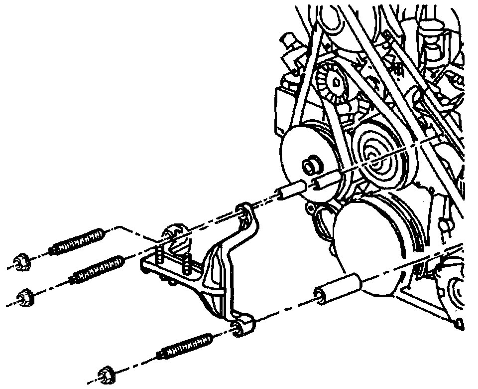

1. Use a jack with a block of wood on the jack under the oil pan in order to support the engine.
2. Remove the engine mount to engine mount bracket nuts.
3. Remove the engine mount bracket front upper and lower nuts.
4. Remove the engine mount bracket front upper and lower studs and spacer.
See Picture 2

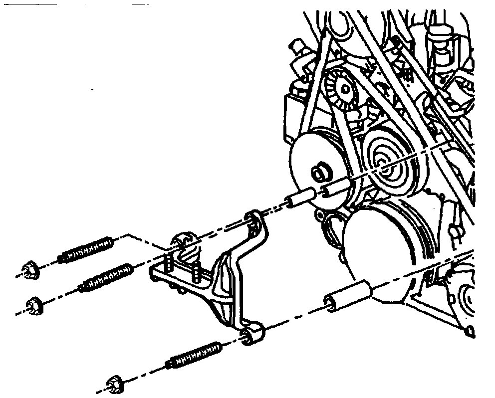

5. Lower the engine as necessary and rotate the tensioner to remove the drive belt.
See Picture 3
6. Remove the drive belt.

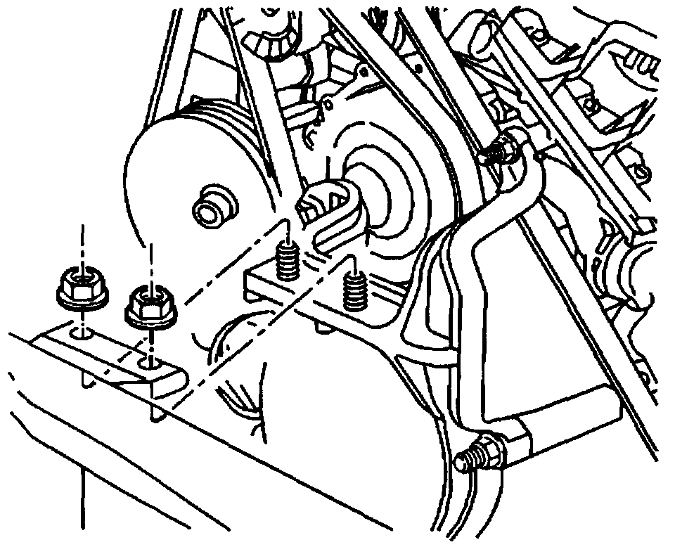

INSTALLATION PROCEDURE
See Picture 4
1. Install the drive belt.

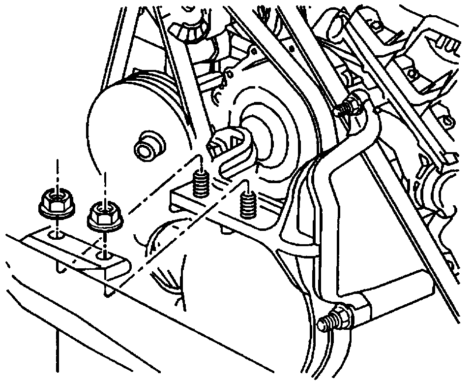

See Picture 5
2. Install the engine mount bracket front upper and lower studs and spacers.
