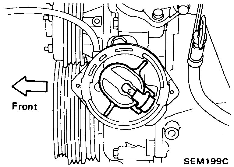

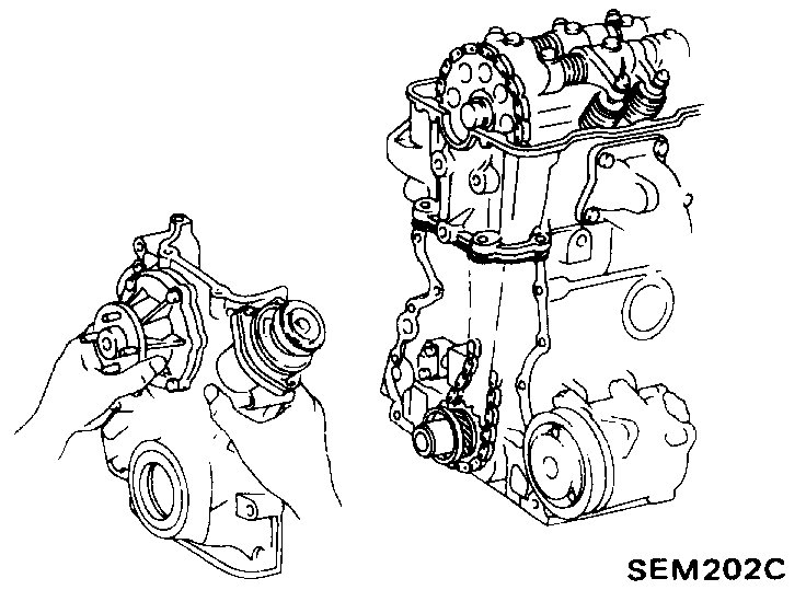

Setting TDC- Distributor
Pic 2
6. Set No.1 piston at T.D.C. on its compression stroke.

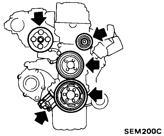

7. Remove the following parts.
External Parts Removal
Pic 3
^ Power steering pump, idler pulley and power steering pump brackets.
^ Compressor idler pulley.

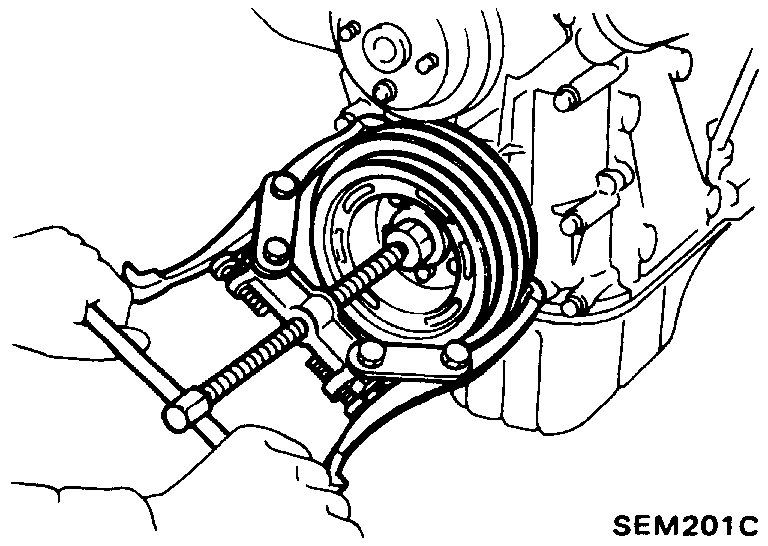

Removing Crankshaft Pulley
Pic 4
^ Crankshaft pulley.

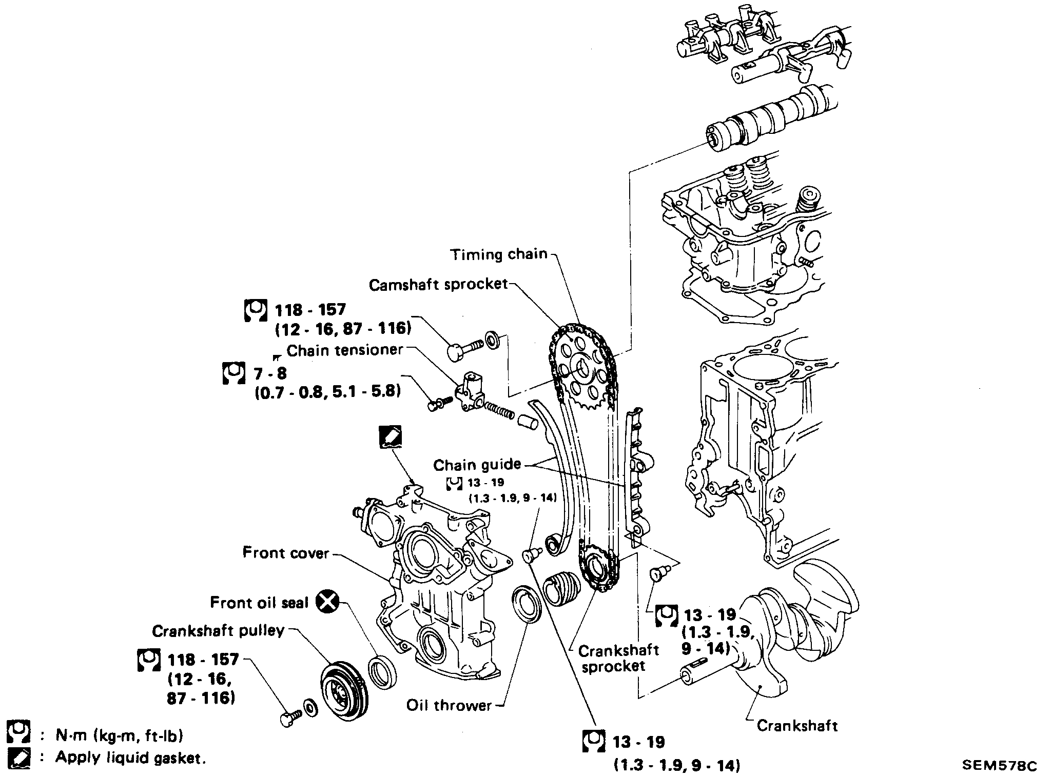

9. Remove front cover.

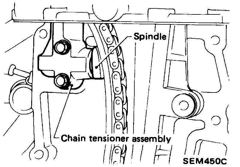

Timing Parts- Locations
Pic 7

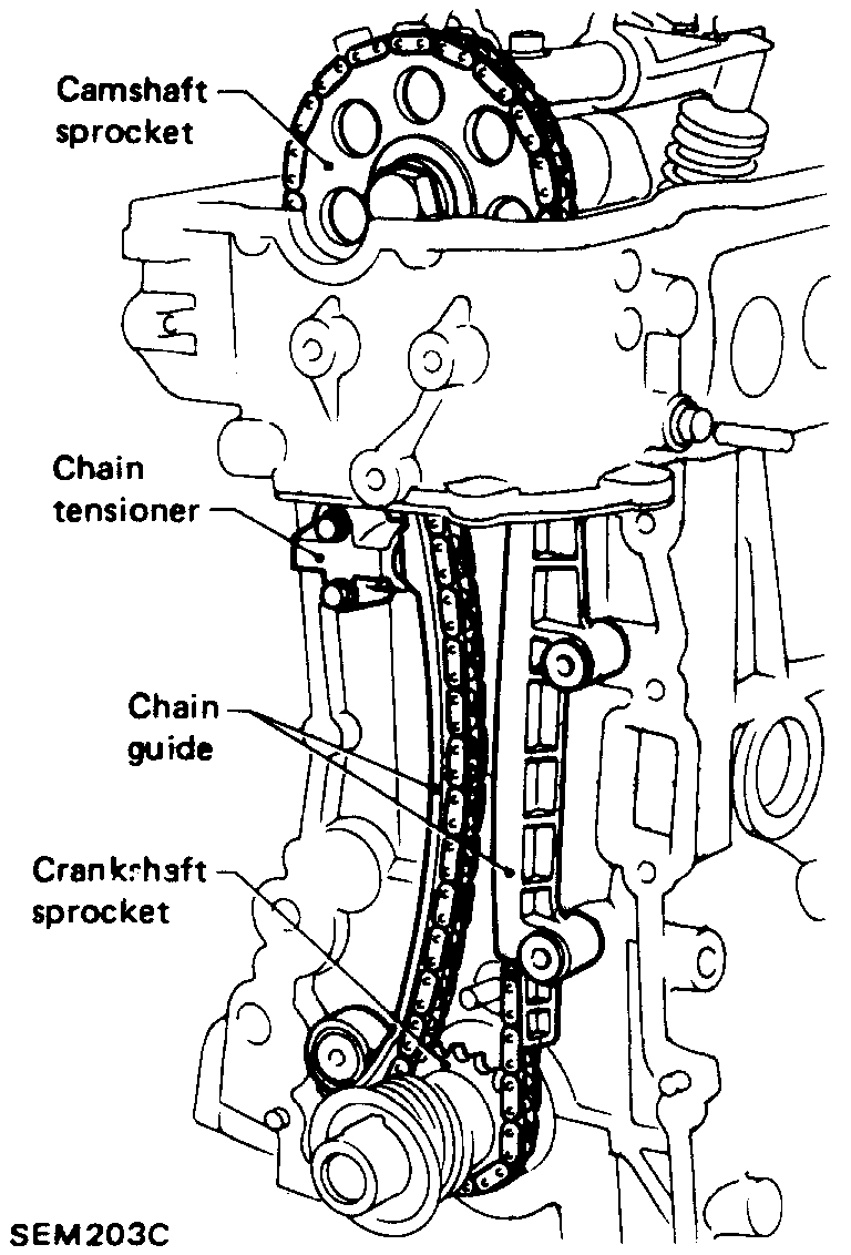

10. Remove the following parts.
^ Chain tensioner.
^ Chain guides.
^ Timing chain and sprocket.
^ Oil thrower, oil pump drive gear and crankshaft sprocket.

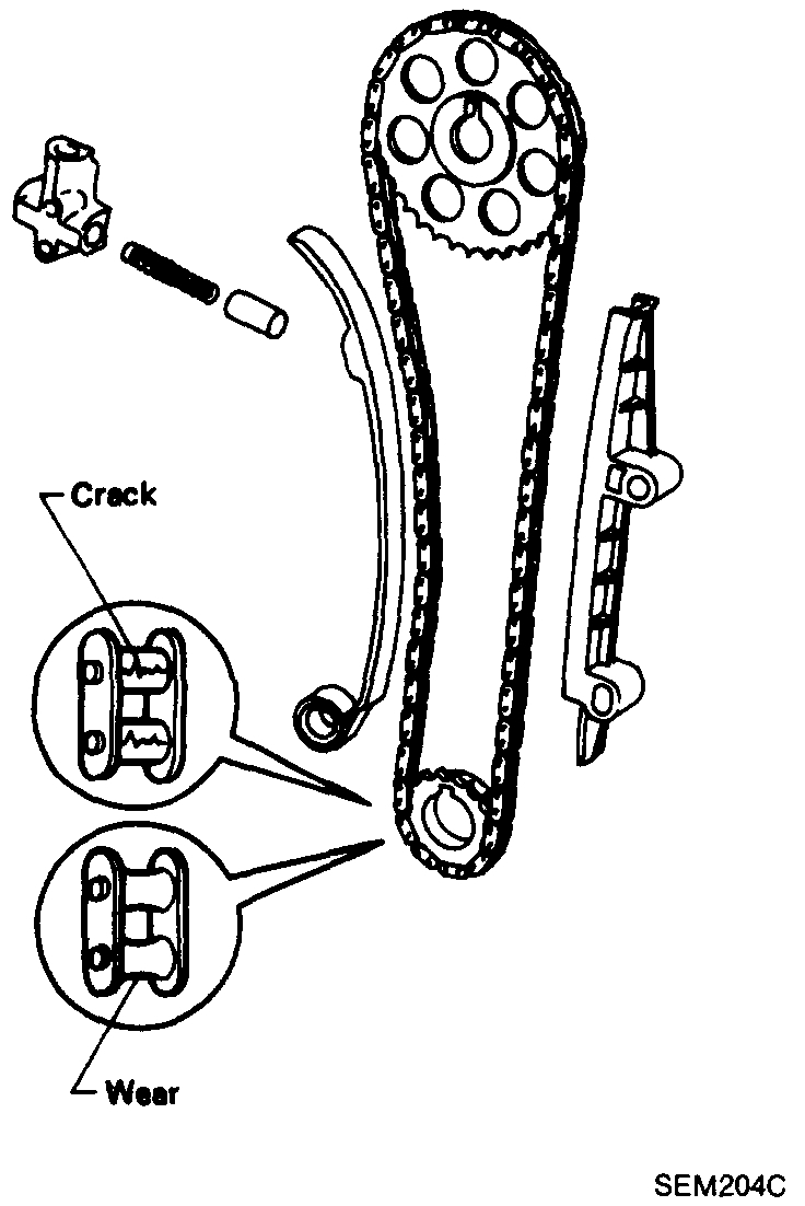

INSPECTION
Timing Chain Component Inspection
pic 8
1. Check for cracks and excessive wear at roller links. Replace If necessary.

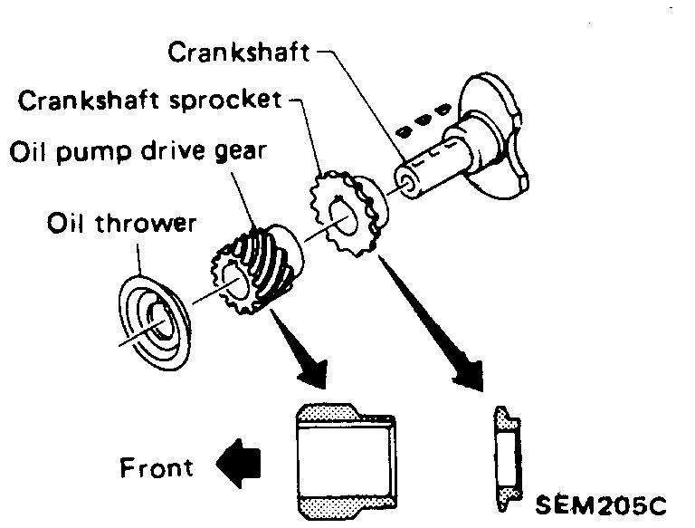

Front Of Crankshaft
pic 9
1. Install crankshaft sprocket, oil pump drive gear and oil thrower.
^ Make sure that mating marks of crankshaft sprocket face engine front.
2. Install camshaft sprocket.
3. Confirm that No.1 piston is set at T.D.C. on its compression stroke.
4. Install timing chain.

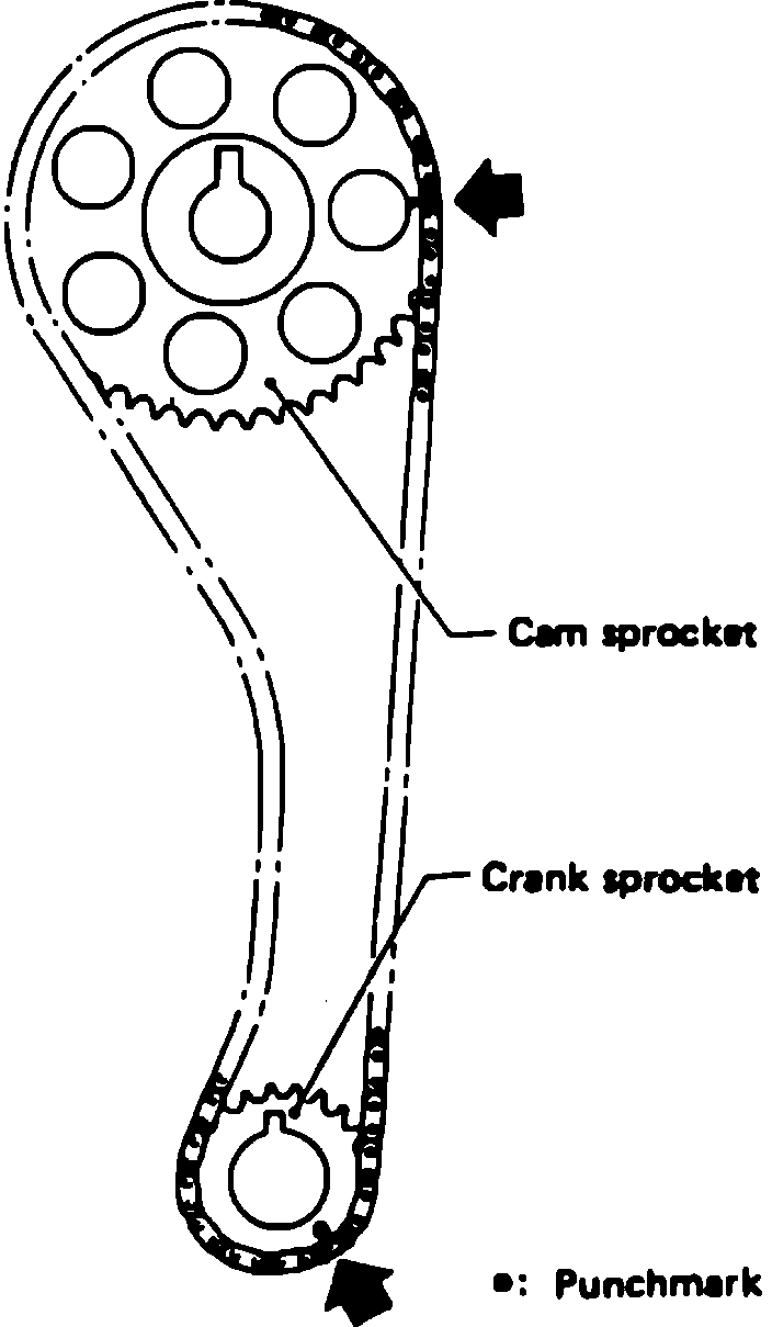

Fig. 3 Timing Mark Alignment.
pic 10
^ Set timing chain by aligning its mating marks with those of crankshaft sprocket and camshaft sprocket.
Tightening Camshaft Sprocket Bolt
pic 11

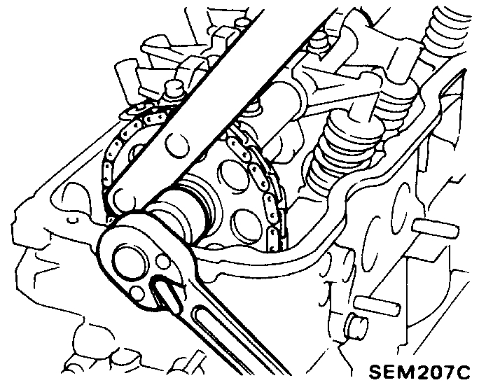

5. Tighten camshaft sprocket bolt.

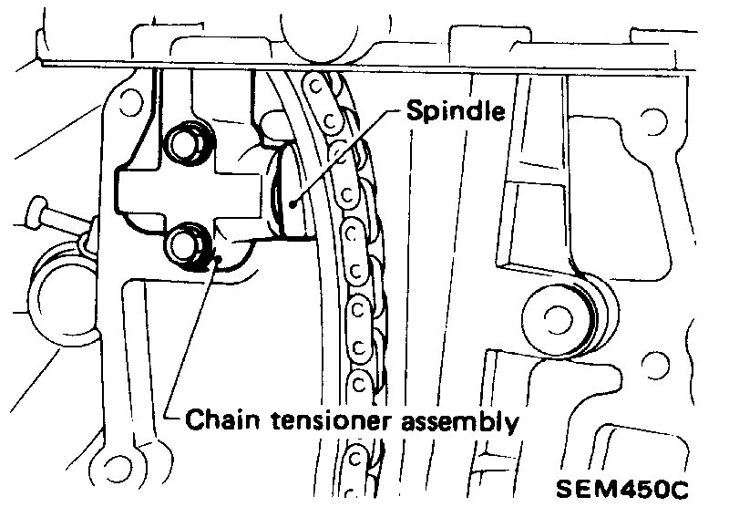

Timing Chain Tensioner
pic 12
6. Install chain guide and chain tensioner.

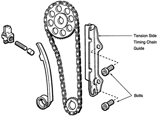

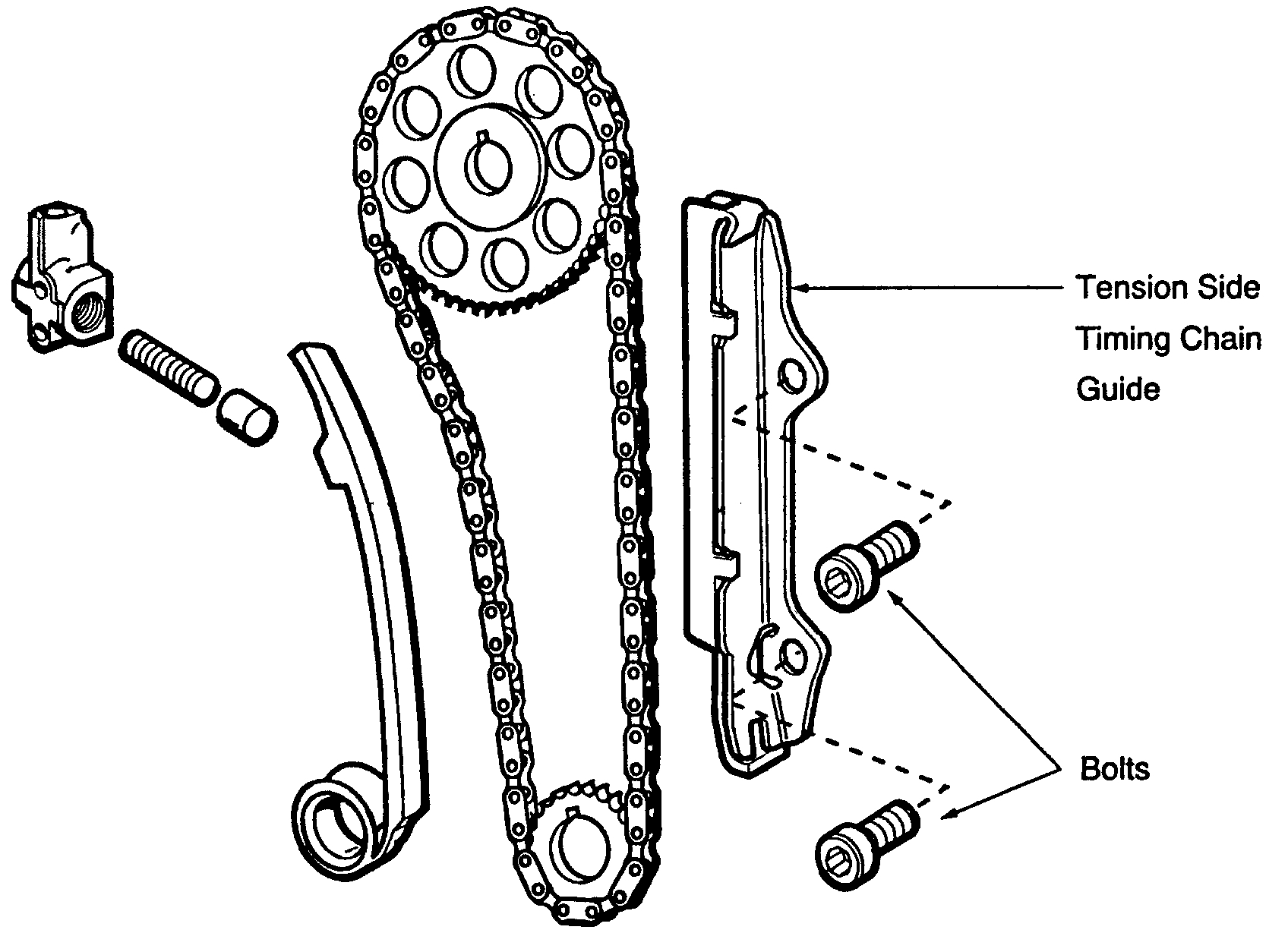

CAUTION: SERVICE INFORMATION
pic 13
If servicing the timing chain or replacing a long block, check to see if it has the steel-backed tension side guide. If not, please replace it with the countermeasure guide, including the two bolts listed. Due to the changes made to the guide, new style bolts are required. Refer to TSB 95027.

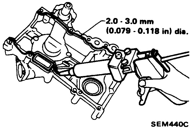

Applying Sealant To Front Cover
pic 14
7. Apply liquid gasket to front cover.

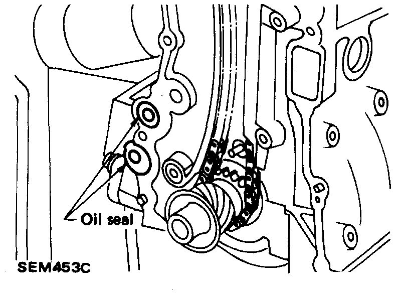

Front Cover Oil Seals
pic 15
^ Do not forget oil seal.

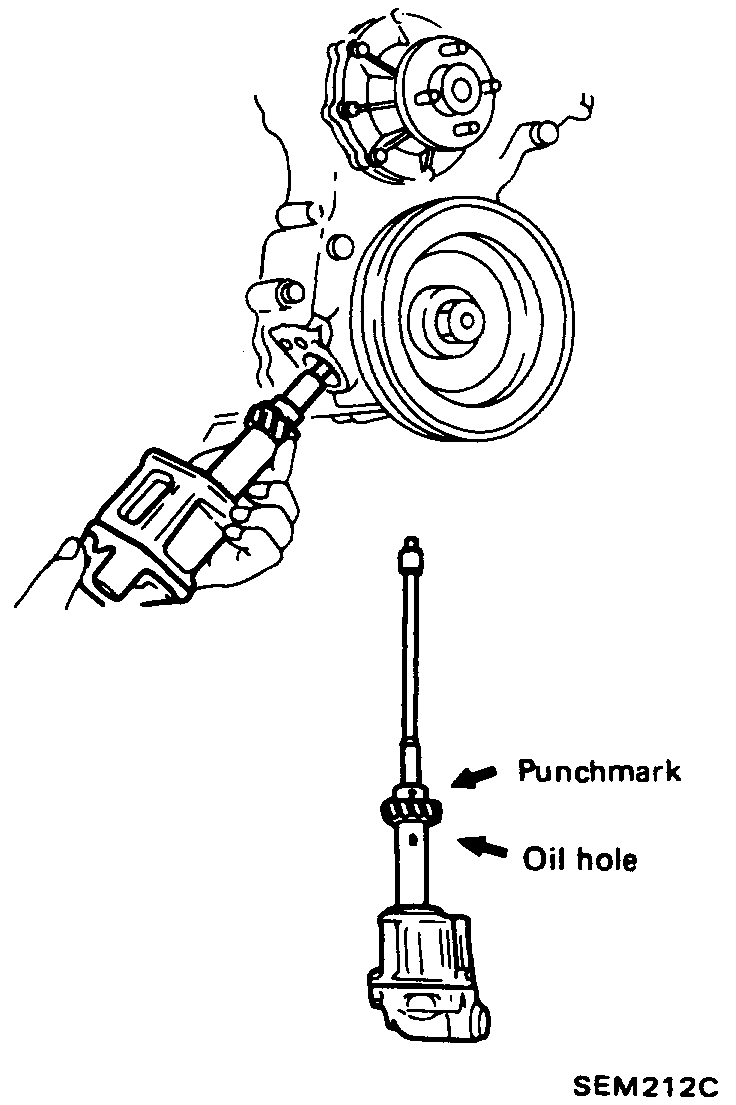

12. Install oil pump and distributor driving spindle with new gasket in front cover.
Installing Oil Pump
pic 16
a. Assemble oil pump and driving spindle, aligning punchmark on driving spindle with oil hole.
Distributor Driving Spindle
pic 17
b. Make sure that driving spindle is set as shown in image.
13. Install distributor.
pic 18
14. Make sure that No. 1 piston is set at T.D.C. and that distributor rotor is set at No.1 cylinder spark position.
