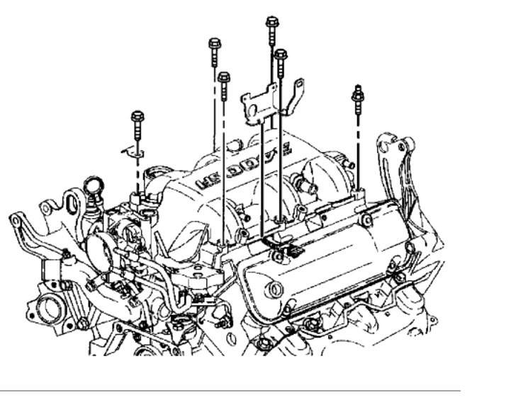

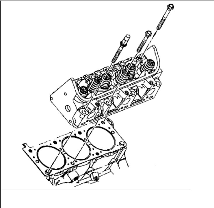

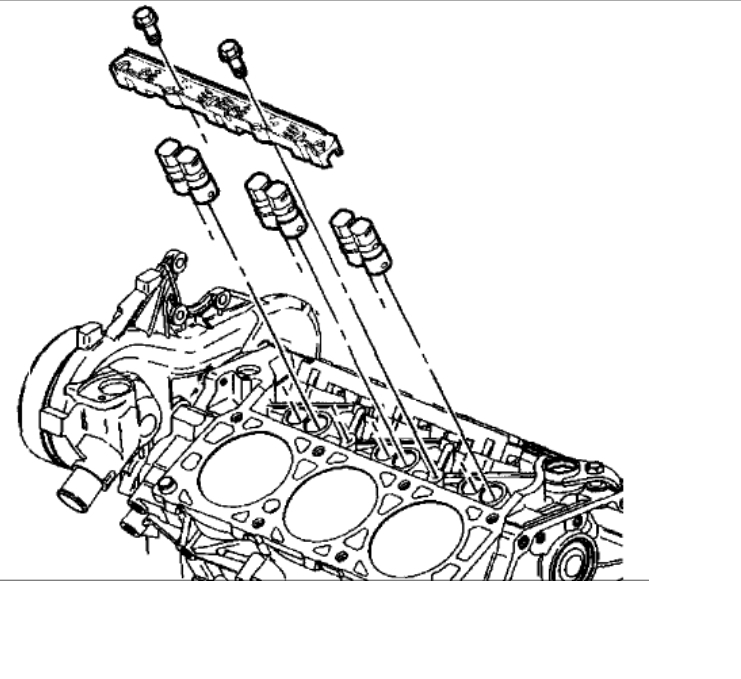

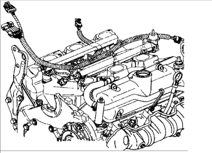

Does anyone have a diagram of the position of the engine, and any associated bolts and brackets, on a 2003 Chevrolet Malibu that would confirm or refute the need to remove the engine in order to replace its valve lifters?
Oct 10, 2017 at 9:27 PM

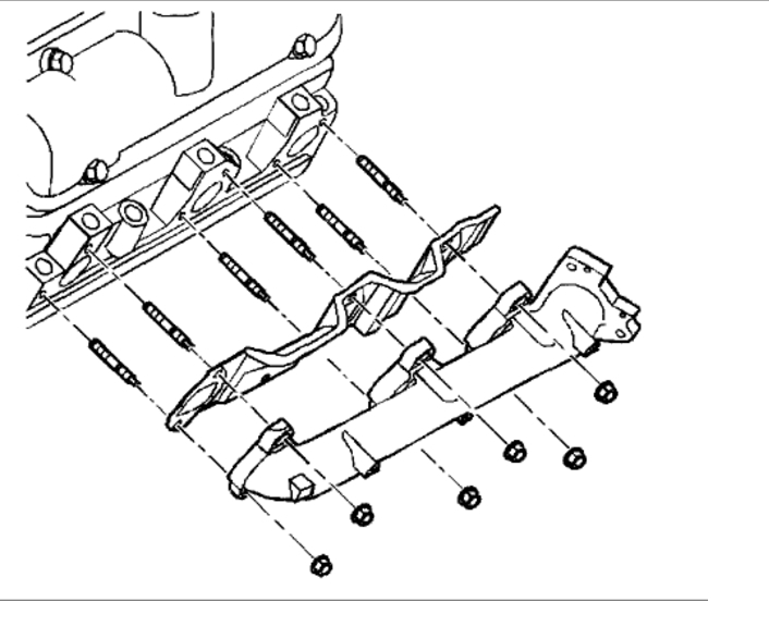

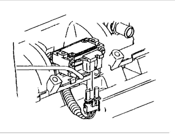

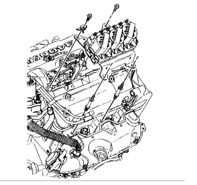

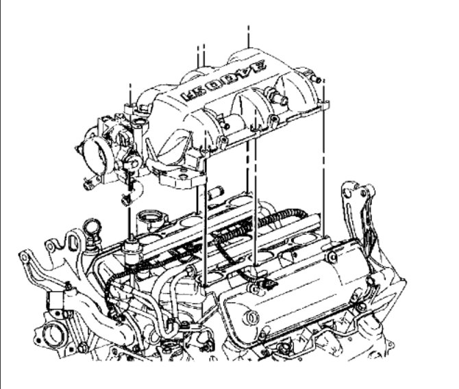

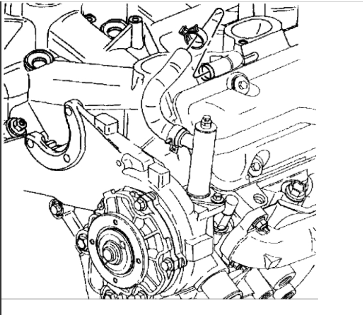

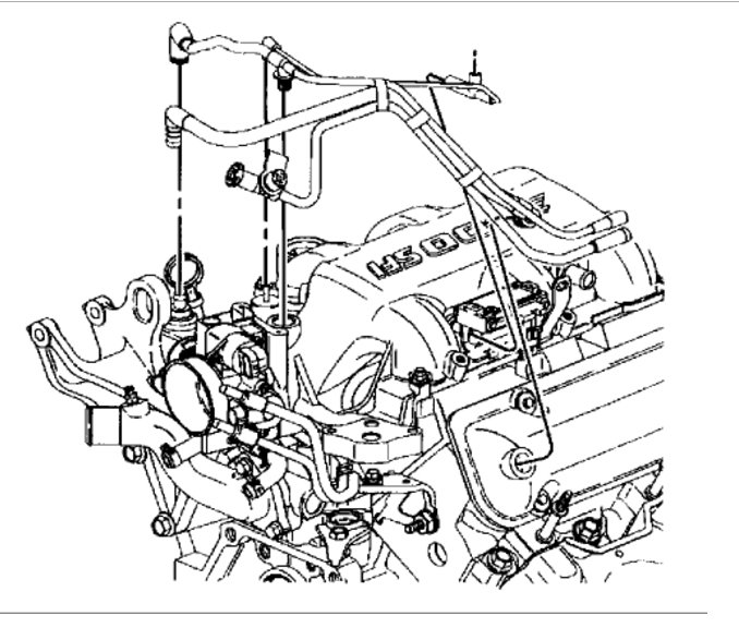

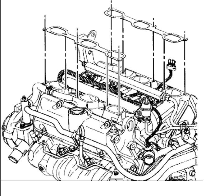

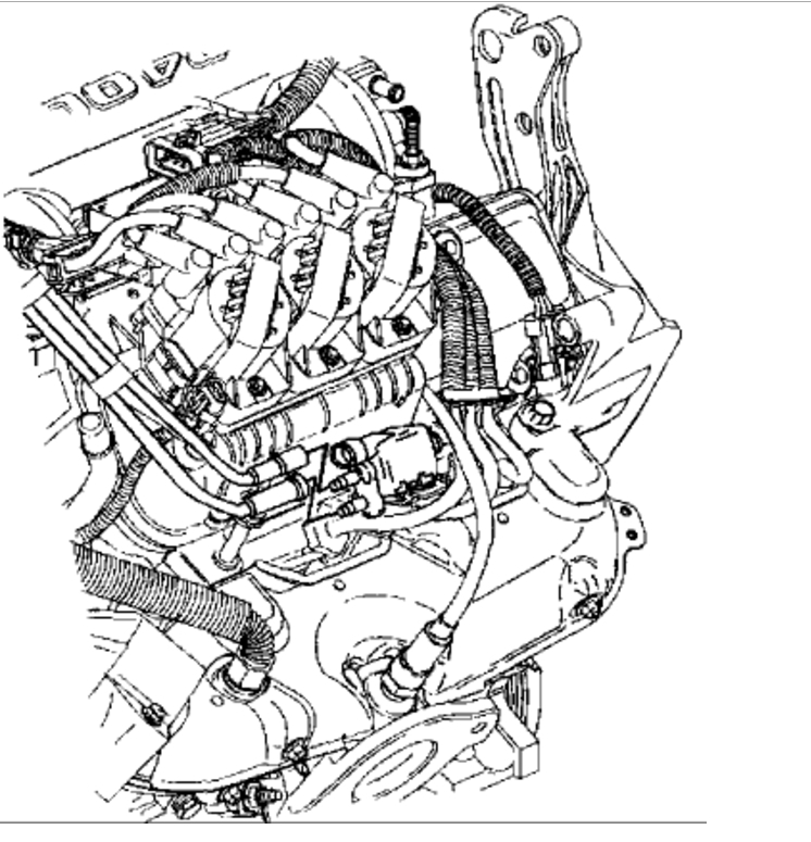

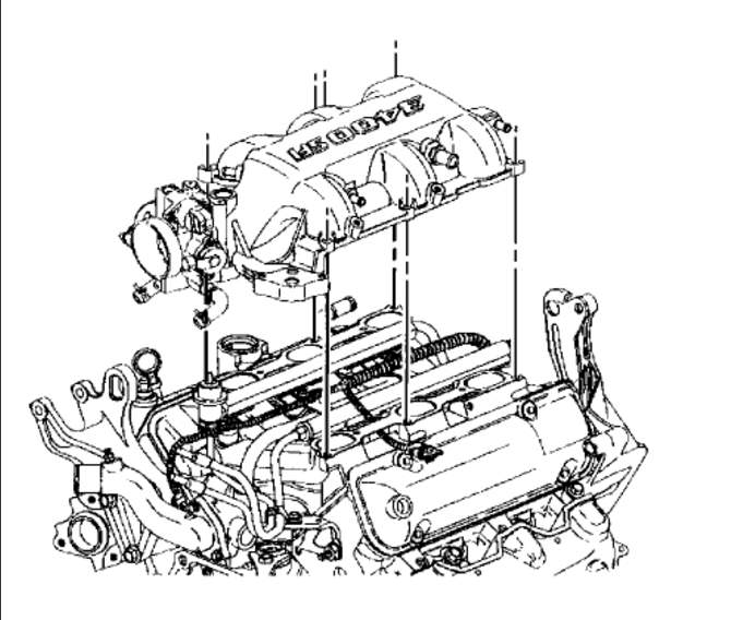

I do not think you need to remove the engine to do the job but you do need to remove the cylinder heads.
Here is a diagram that shows the heads off when doing the job (below):
Oct 11, 2017 at 11:09 AM

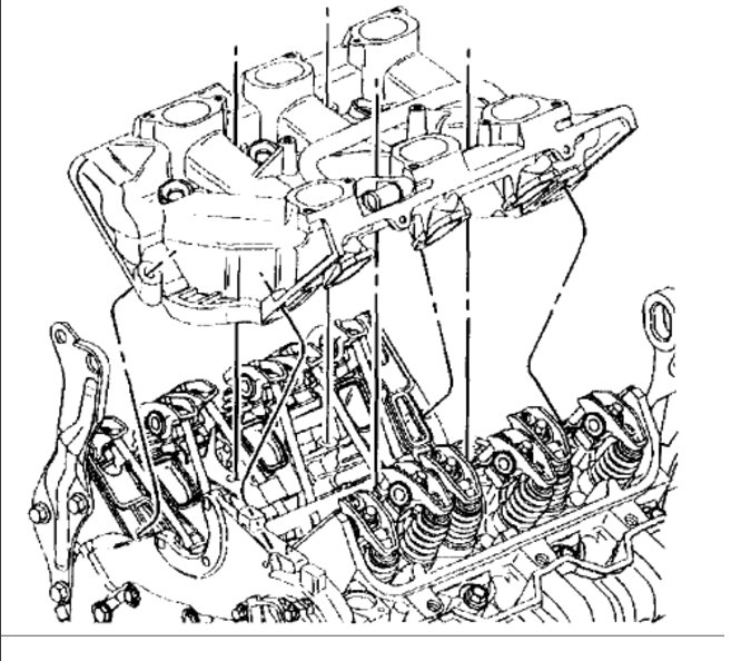

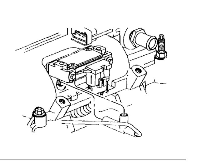

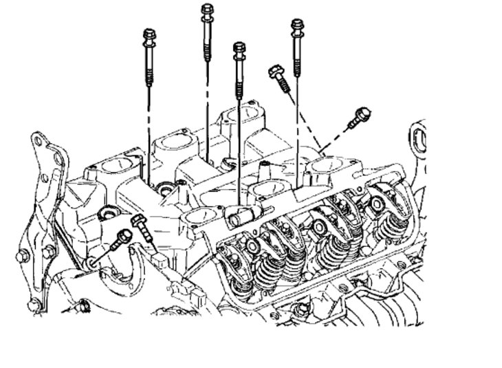

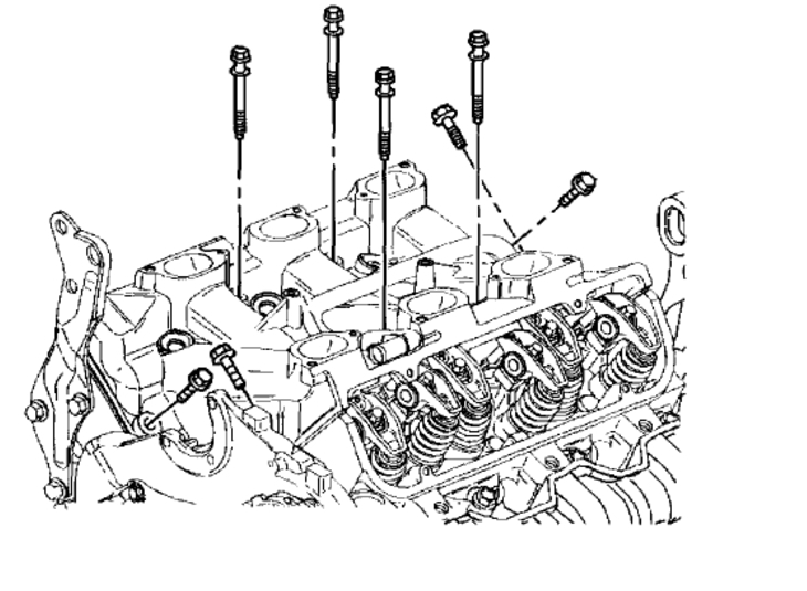

Thanks for all the assistance. I think I may just go ahead and replace the Head Gasket without doing any testing. There is a leak, for sure, and it's not visible. Can someone tell me the parts required for this job. Obviously, (1) Head Gasket. Are new bolts required, as well?
Oct 28, 2017 at 2:45 PM

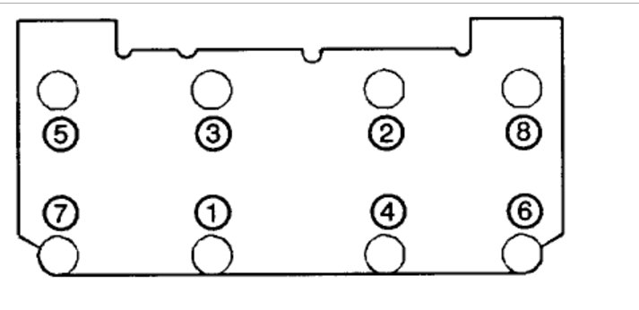

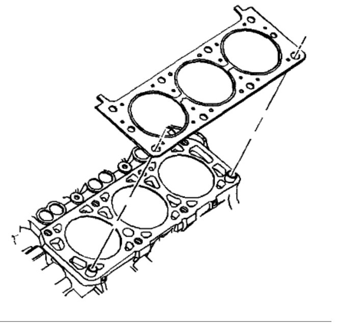

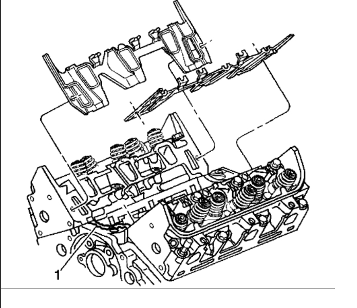

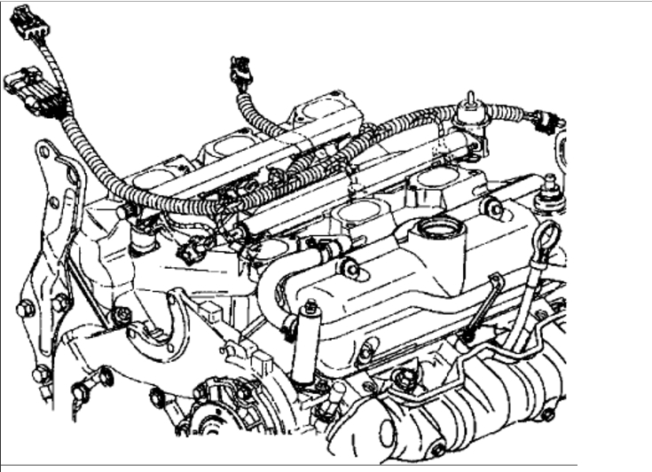

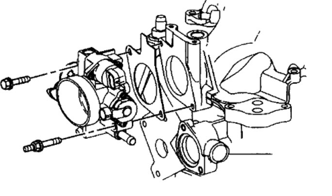

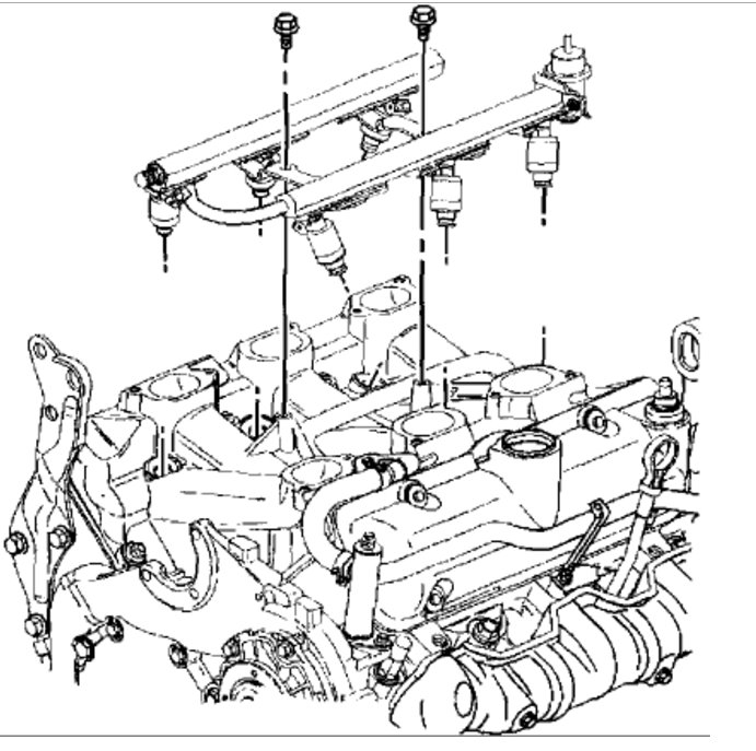

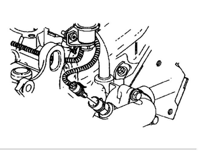

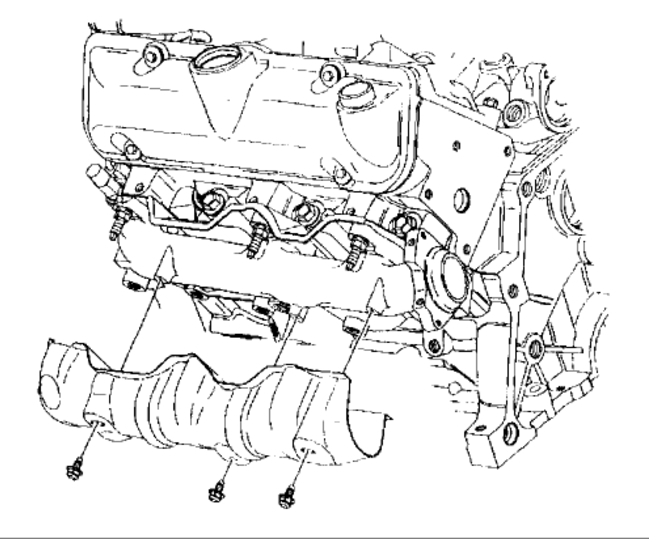

You should install new head bolts, spark plugs and have the heads resurfaced or the new head gaskets are more prone to leak. You should change the oil and filter as well. Here are some more diagrams to help you get the job done.
Install the cylinder head bolts.
Tighten the bolts to 60 Nm (44 ft. lbs.) in the sequence shown.
Use the J36660-A in order to tighten the bolts an additional 95 degrees.
Oct 28, 2017 at 5:47 PM
