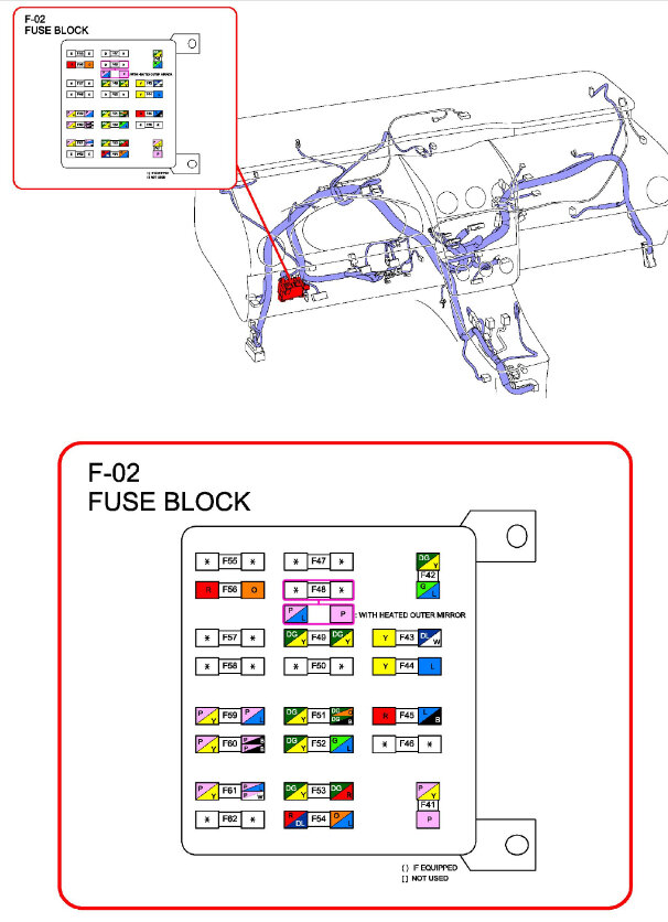

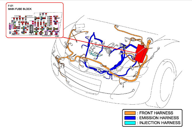

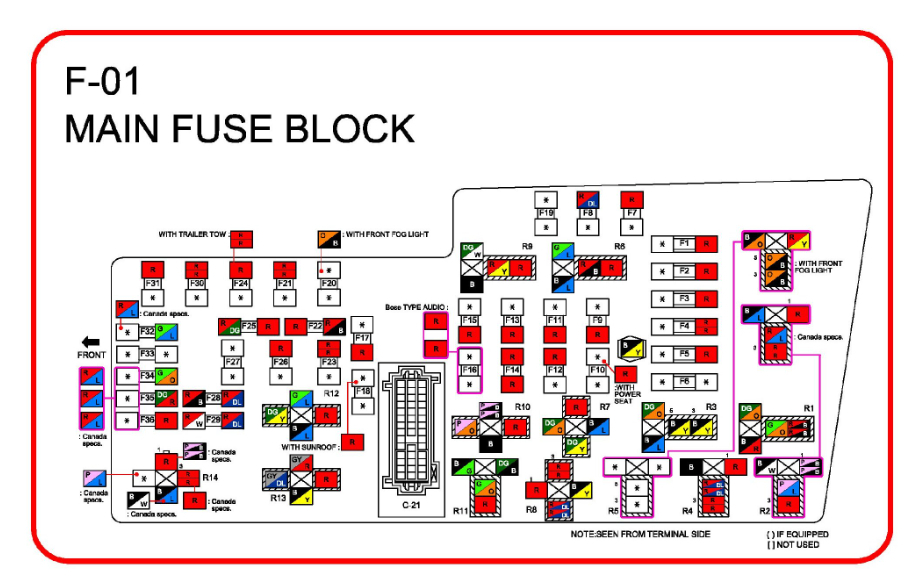

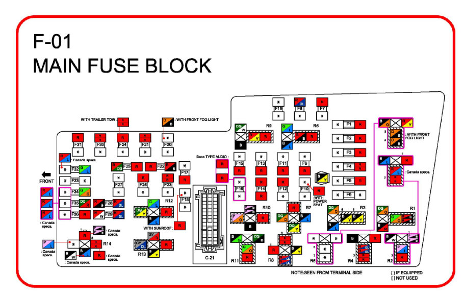

These codes are lost communication codes, so we lost power or ground. I would clear all the codes and then turn the system on without starting the engine or driving the car, then run the codes again. This will give us the most prevalent codes which we will go after first. Here are the fuses and locations. Check out the images (below). Please let us know what happens.
