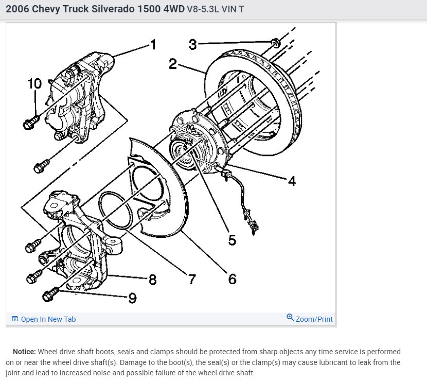

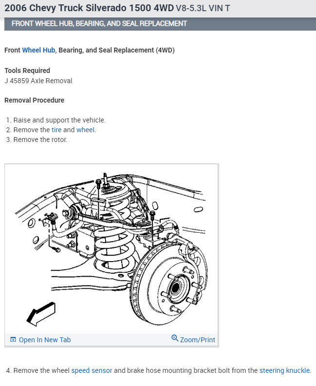

Hub bearing broke. Hub bearing broke. Can a hub bearing from a 2004 trailblazer be used on the truck listed above?
Jun 11, 2022 at 5:49 AM
SQM
CERTIFIED EXPERT
6,383 POSTS

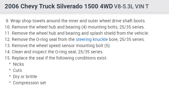

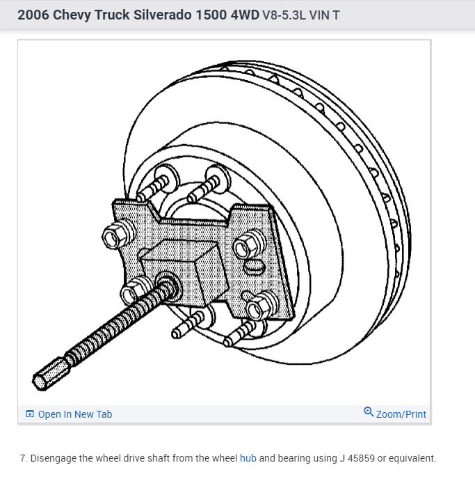

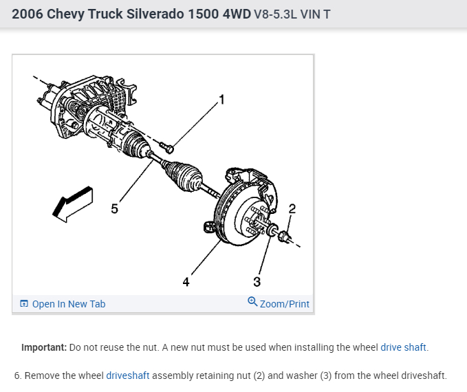

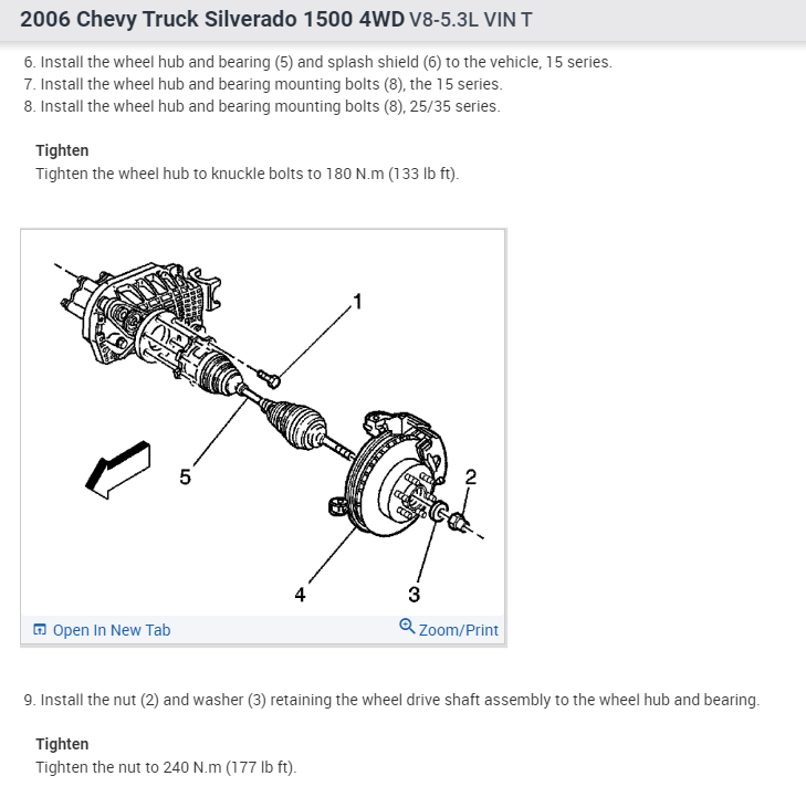

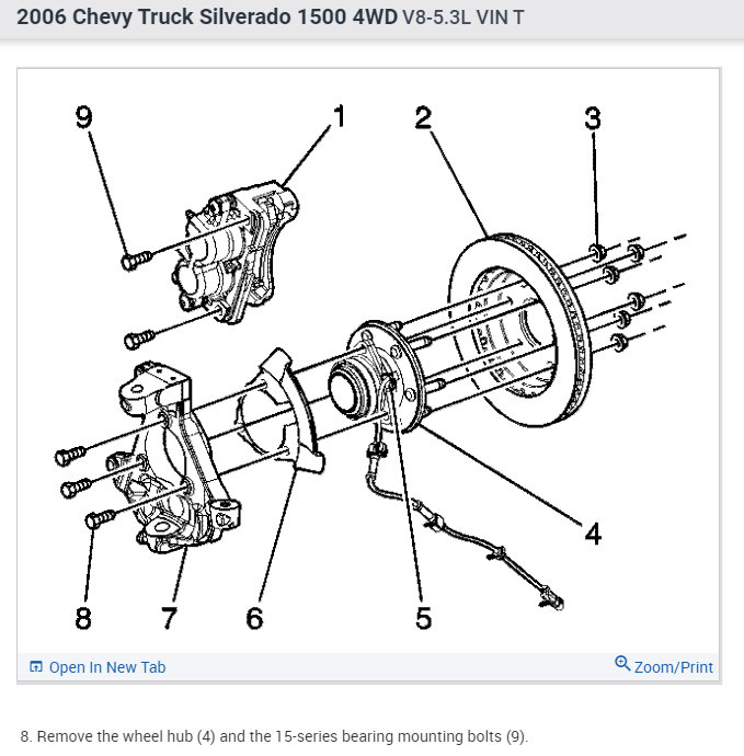

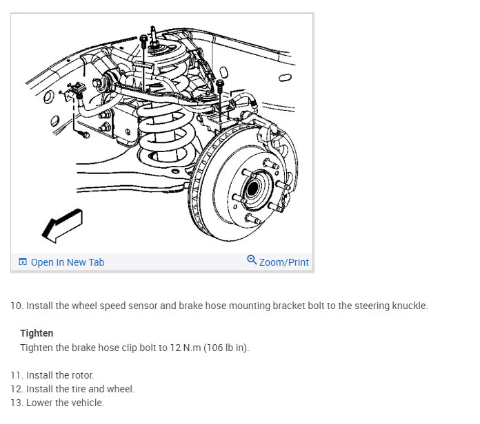

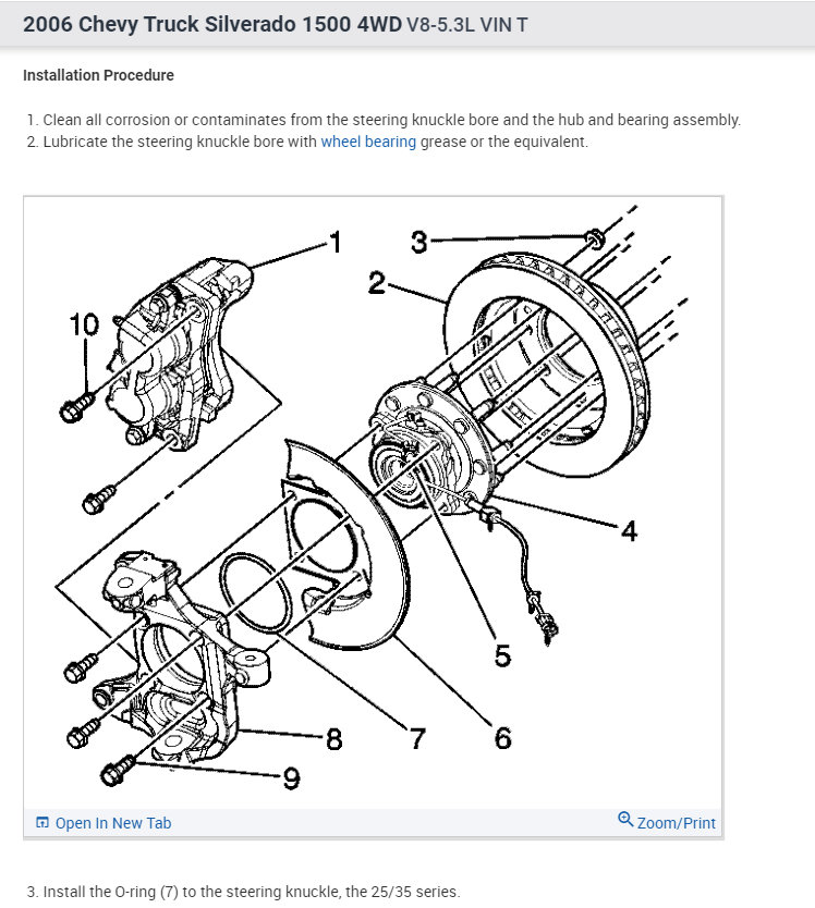

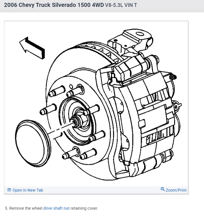

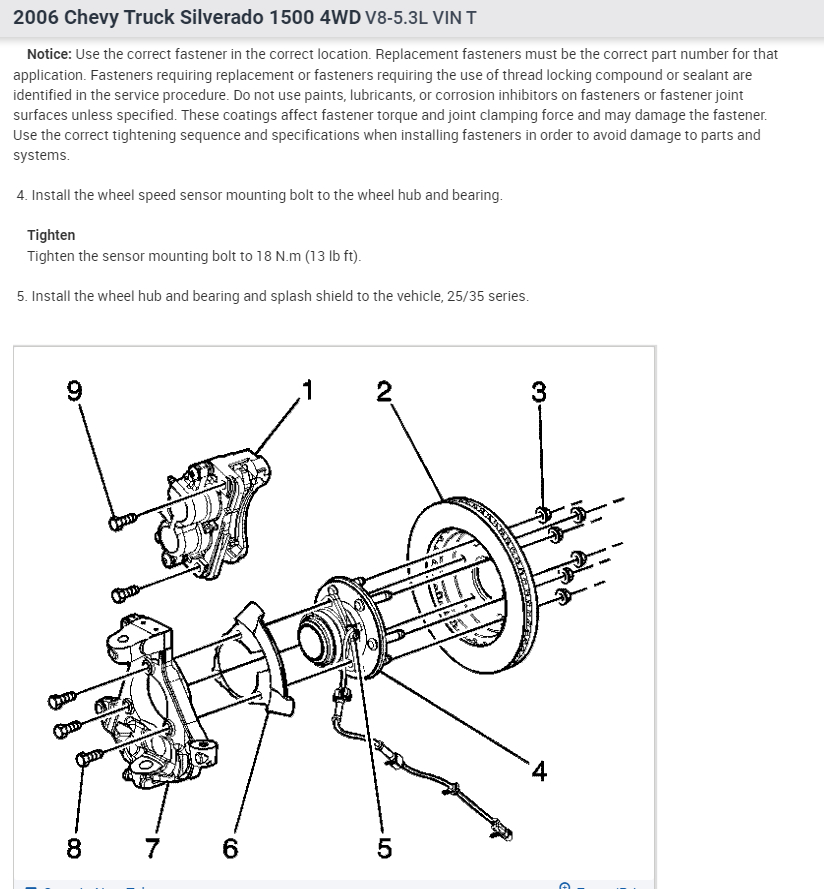

These are not interchangeable. They are completely different, especially the Silverado which is a 6-lug and Trailblazer is a 5-lug hub.
Here is a helpful guide on replacement:
https://www.2carpros.com/articles/bearing-hub-replacement
I have attached the diagrams below for your reference.
Let me know of any questions.
Thank you.
