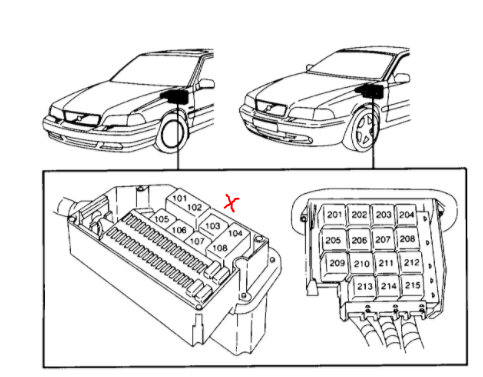

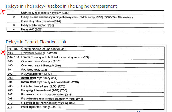

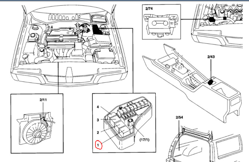

One more question. Which fuse should I pull before starting to disable the fuel relay? I am conflicted here. My manual says 11and 12 are the injectors and pump but i have also seen people who say 8 which is listed as control modules/engine auto transmission. 8 is the larger 60A and 11 and 12 are 10A and 20A. Sorry, I am sure you know all of that. I am just explaining what I see and heard.
