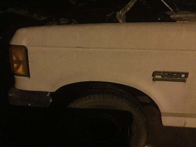

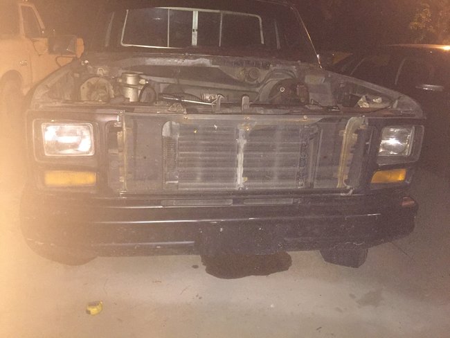

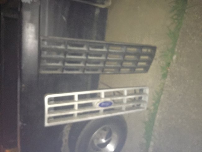

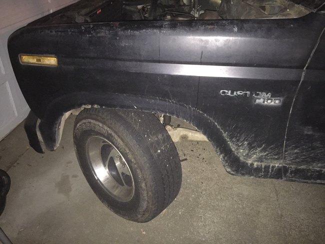

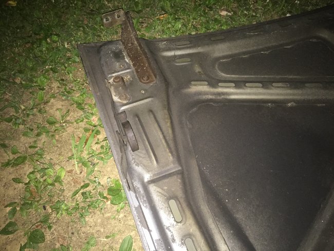

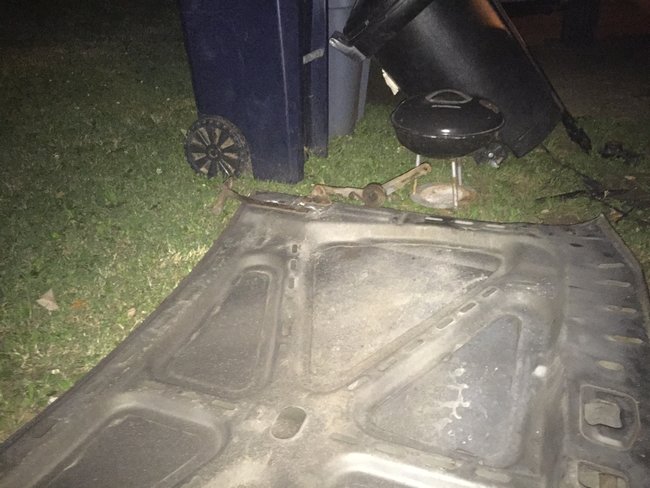

Will my 1981 F100 custom front fenders, hood, grill,head lights all fit onto my truck listed above custom? By looking at it all bolts look like they would line up, I but cannot find any question like this online. Also the cab rear window, is that interchangeable with the F100's window? Going to replace doors on 250 from the 100 as well. I already know those are going to switch over.
I measured the Hood of both trucks and they are the exact same size. Bolting positions of both hoods is the same as well. I have been told if the doors and hood match the whole body matches.

This is the truck listed above.
Jun 22, 2016 at 6:24 AM

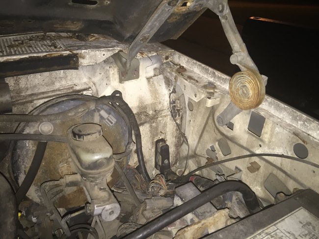

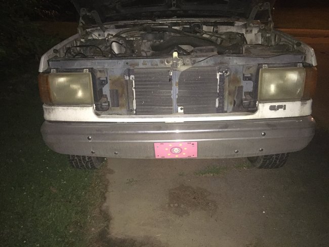

Already took hood off of 1981 F100 before looking this up online. Last picture here is the front of the truck listed above, I forgot to add in the post above.
Jun 22, 2016 at 6:26 AM

Thanks, I decided to phone a salvage yard instead of going in person.
They told me the parts will not interchange as individual parts but I could replace the entire front of the 88 with the front end of the 81. Frames are the same and so are all bolt holes.
