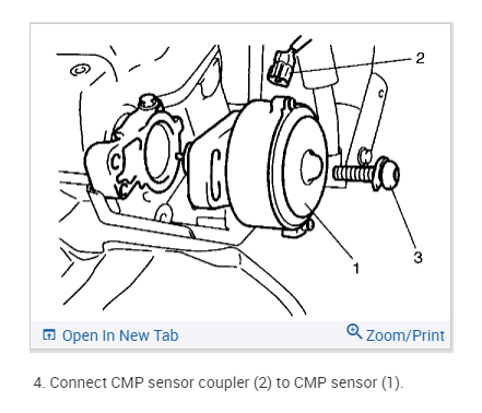

camshaft position sensor location needed. please, thank you.
Jan 27, 2023 at 12:42 PM
CERTIFIED EXPERT
110,175 POSTS

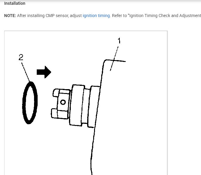

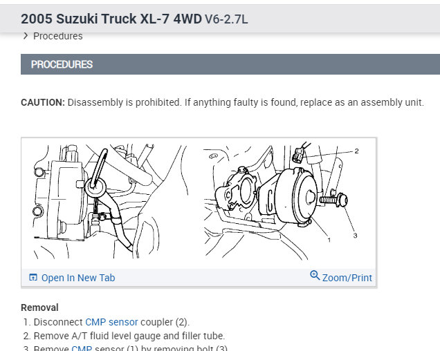

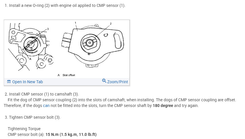

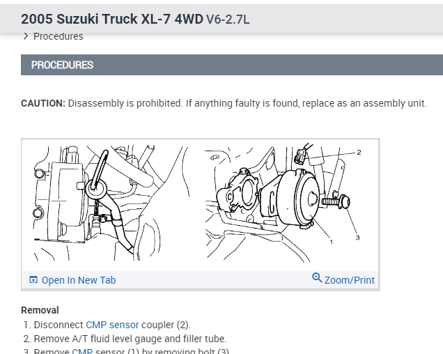

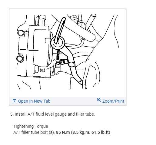

The sensor is located right in front of the transmission dip stick tube. See pics below.
The pics below are for the removal and replacement of the camshaft position sensor. Let me know if this helps or if you have other questions.
See pics below.
