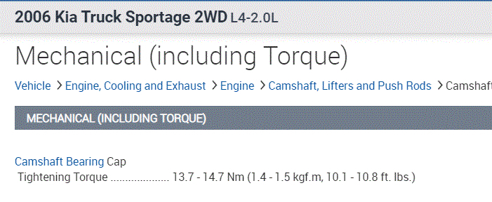

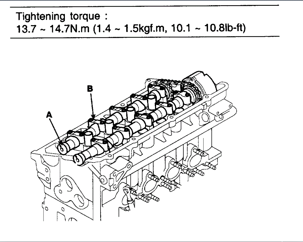

Surprisingly, the manual doesn't provide a sequence. It does give the torque spec. I attached it below.
If I was doing this, I would suggest starting at center and work outward. Tighten to 1/2 the final torque and then go back and tighten to the specifications.
Make sure the cam bearings/caps are fully lubricated before you install the caps.
See pics below.
