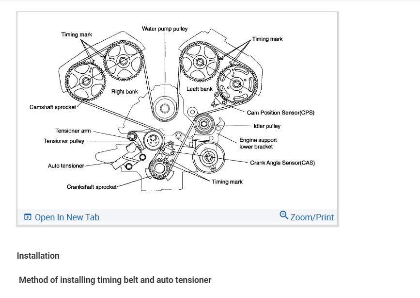

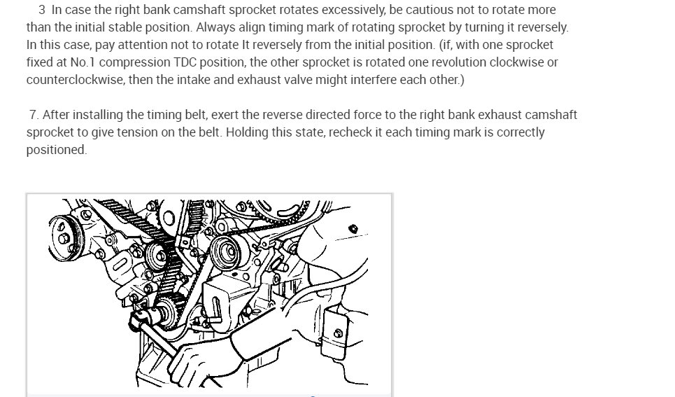

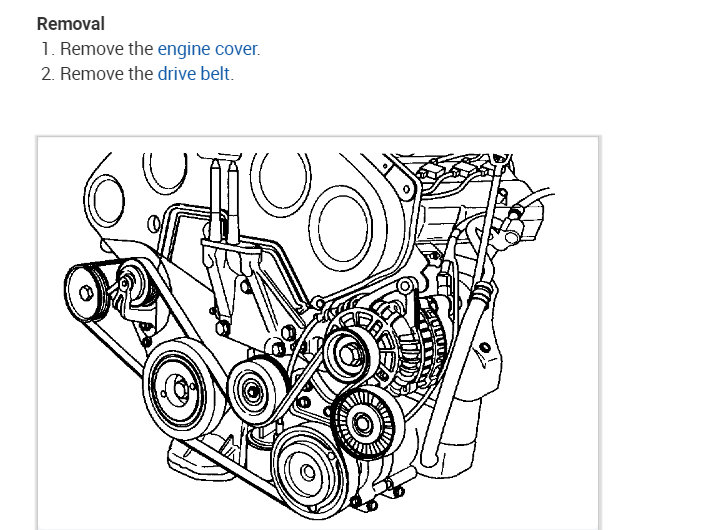

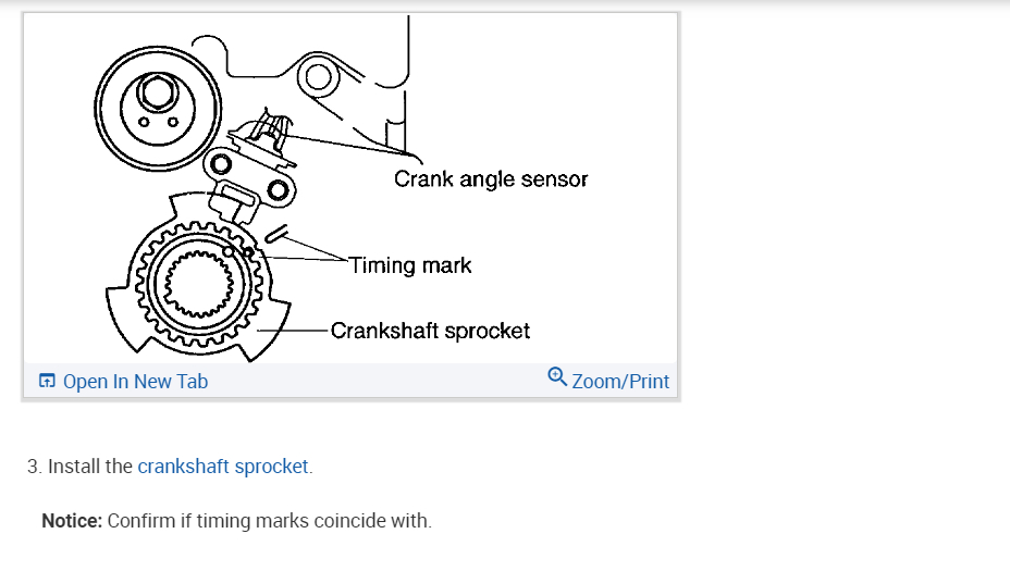

please provide complete timing marks and details?
Oct 14, 2019 at 9:19 PM
SCGRANTURISMO
  • 4,897 POSTS

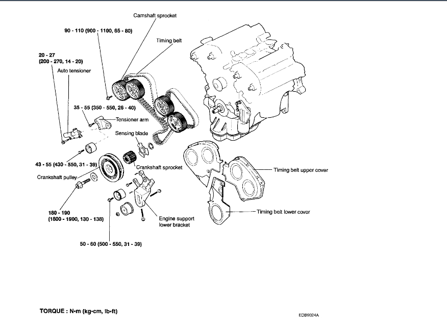

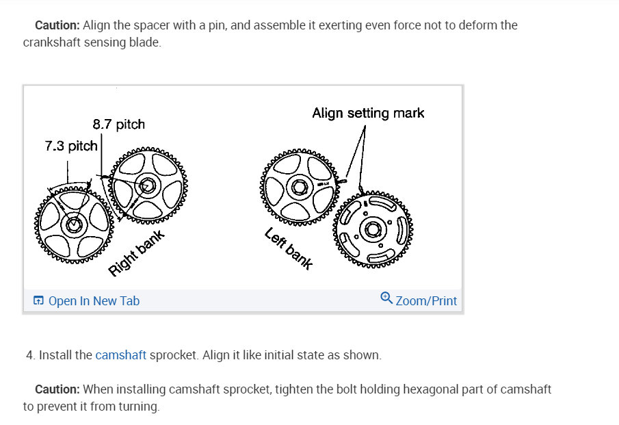

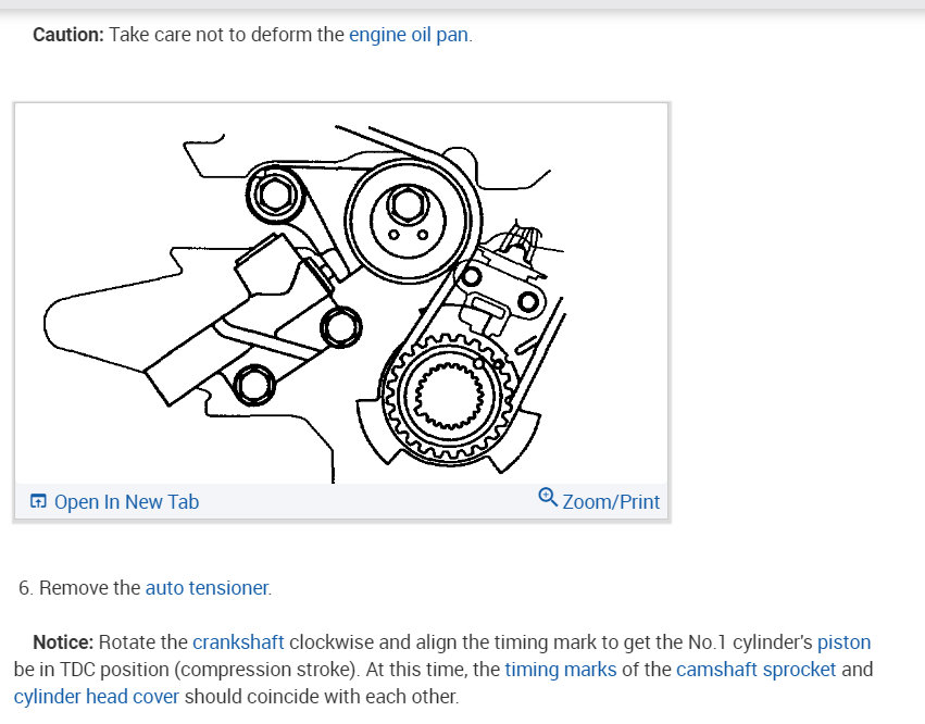

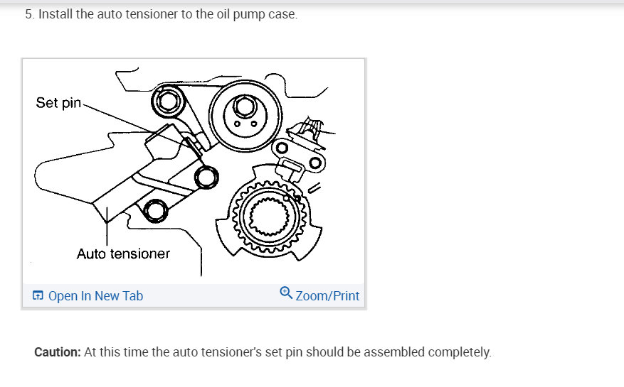

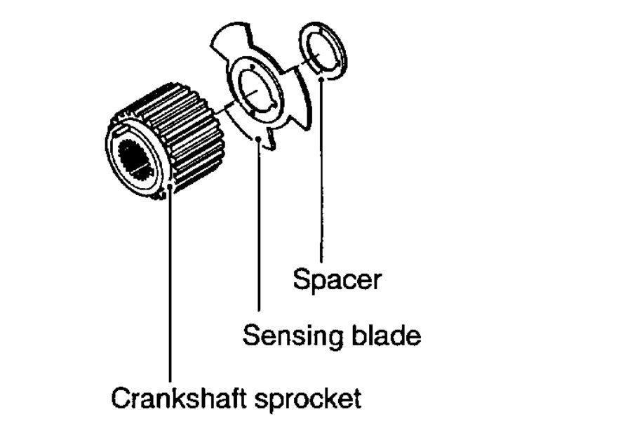

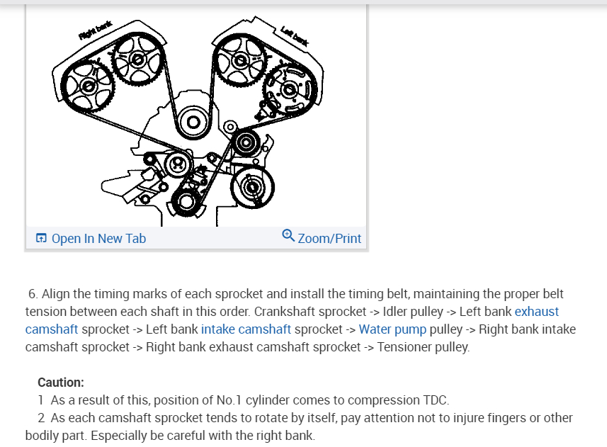

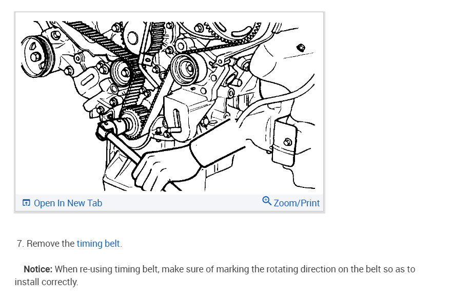

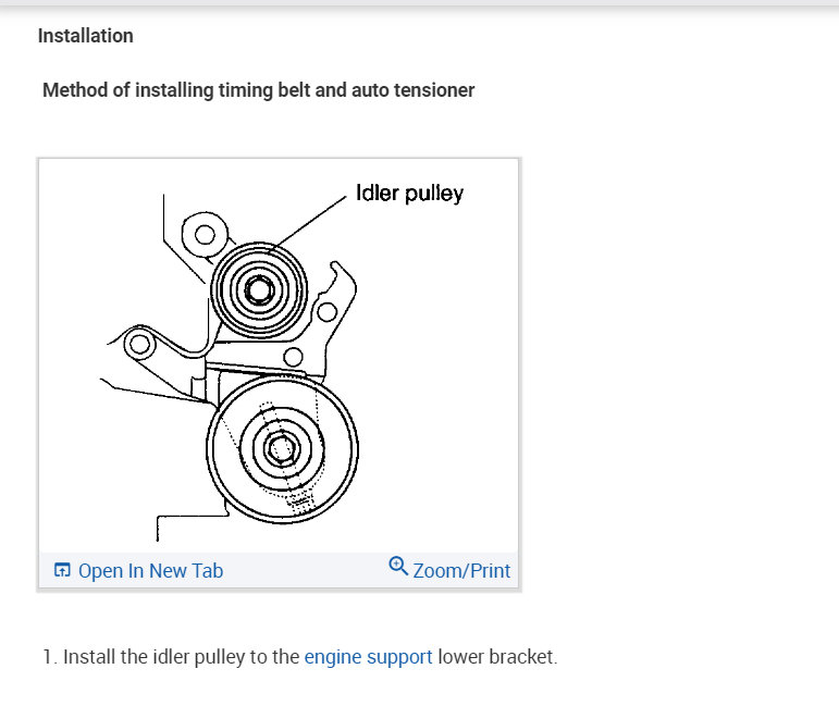

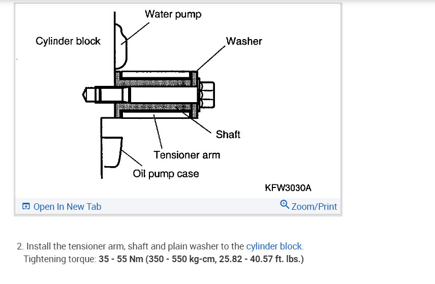

I have included the information that you requested in the diagrams down below. I have included the removal and installation instructions from the vehicle manufacturer for your vehicle's timing belt. Since you are already going to be in there, I would recommend replacing your vehicle's water pump as well. If you would like we could send you over the instructions on how to do this, if needed, as well. Please get back to us with how everything turns out.
Thanks,
Alex
