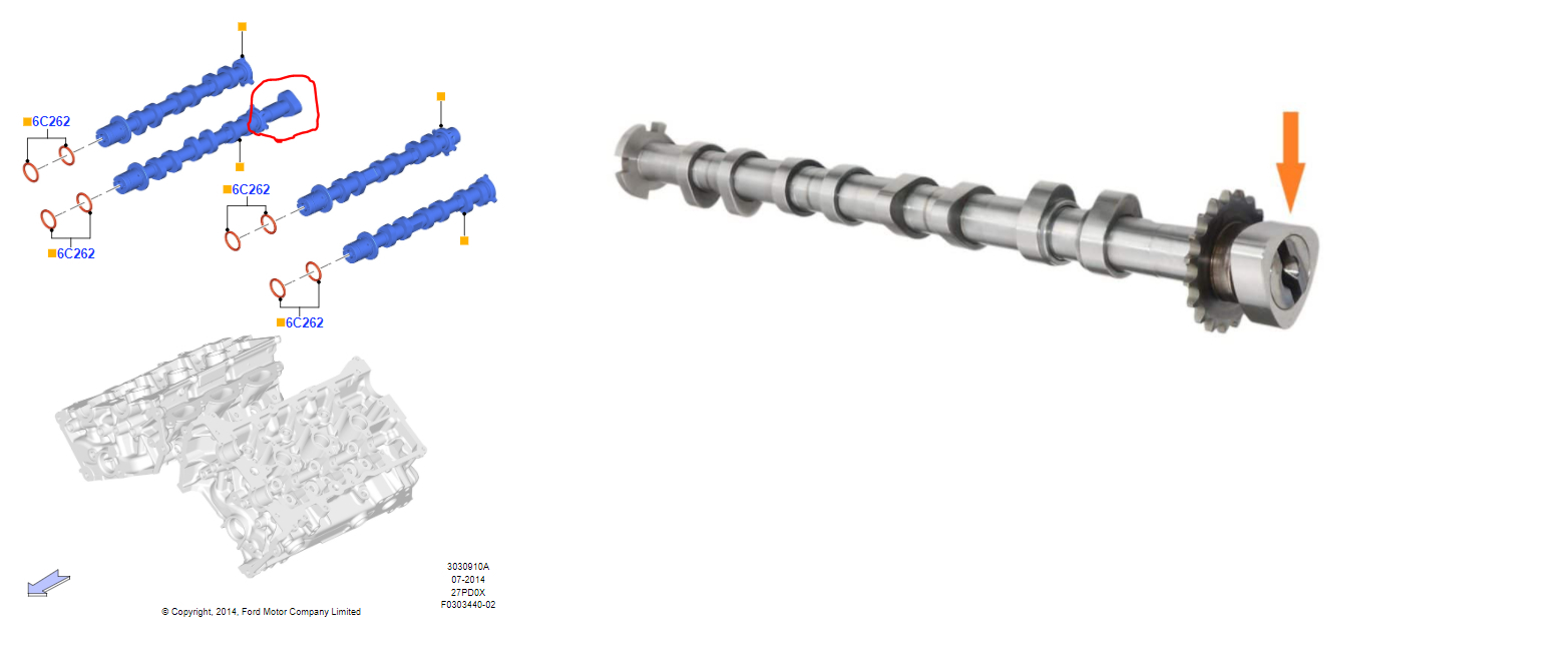

I am looking for a Ford F150 2017 2.7L camshaft that has the cam lobe. The website mentions four different variants (LH-Intake, LH- Exhaust, RH-Intake and RH-Exhaust) but I am unable to find which to chose.

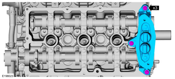

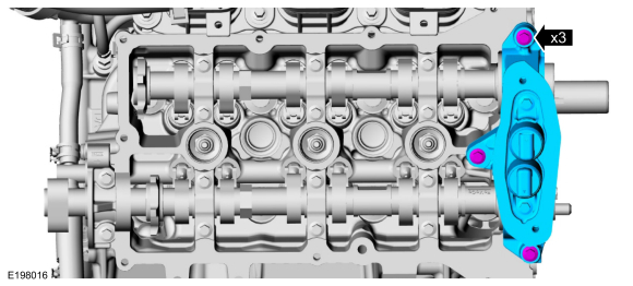

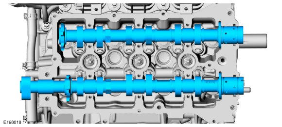

As far as replacing the cams, here are the directions. Note that it does mention the install of the high pressure drive assembly. The attached pics correlate with the directions.

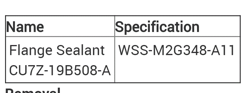

Flange Sealant
CU7Z-19B508-A WSS-M2G348-A11

Refer to: High-Pressure Fuel Pump Drive Unit (303-04A Fuel Charging and Controls - 2.7L EcoBoost (238kW/324PS), Removal and Installation) .

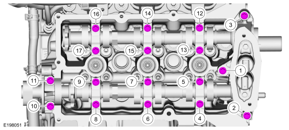

NOTICE: The front camshaft bearing mega cap must be removed first and then the remaining camshaft bearing caps. Failure to follow this direction may result in damage to the engine.
Remove the bolts and the front camshaft bearing mega cap.
Pic 3

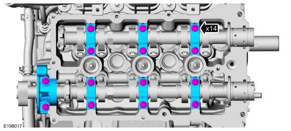

Remove the bolts and the camshaft bearing caps.
Pic 4

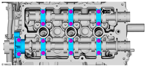

Remove the intake and exhaust camshafts.
pic 5

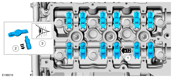

Remove the camshaft roller follower and hydraulic lash adjuster assemblies.
Separate the hydraulic lash adjusters from the spring clips on the camshaft roller followers.
Inspect the hydraulic lash adjuster and roller follower for damage. If any damage is found, inspect the camshaft lobes and valves for damage. Replace damaged components as necessary.

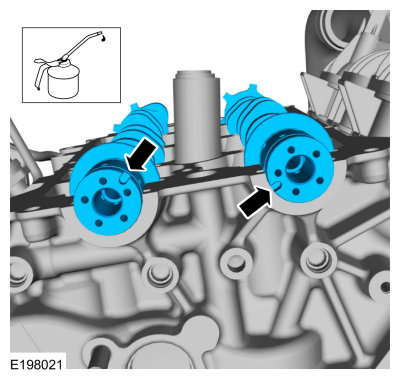

NOTE: Lubricate the camshafts with clean engine oil prior to installation.
NOTE: It is not necessary to position the scarf-cut seal ends when installing the camshafts.
Install the intake and exhaust camshafts in the neutral position. Align the D-slots as shown in the illustration.
pic 8

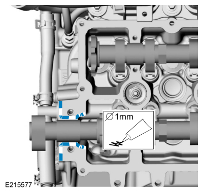

Apply a 1 mm bead of sealant to the rear camshaft cap mounting surface of the cylinder head.
Material : Flange Sealant / CU7Z-19B508-A (WSS-M2G348-A11)
pic 9

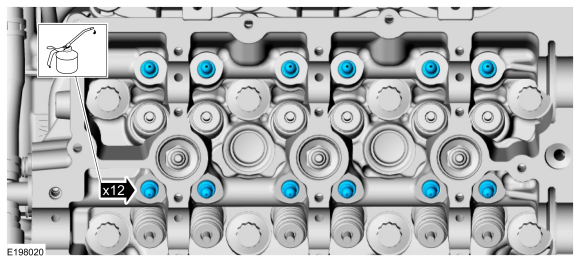

Tighten the bolts.
Torque : 89 lb.in (10 Nm)
pic 12

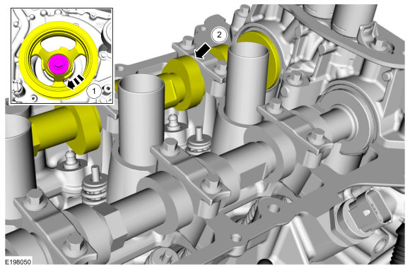

Rotate the crankshaft pulley bolt clockwise to position the camshaft lobe upward for the camshaft roller follower to be installed.
pic 13

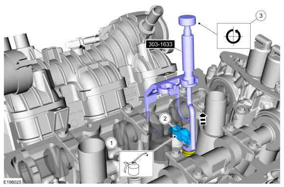

NOTE: Do not allow the valve keepers to fall off the valve or the valve may drop into the cylinder. If a valve drops into the cylinder, the cylinder head must be removed.
NOTE: It may be necessary to push the valve down while compressing the spring.

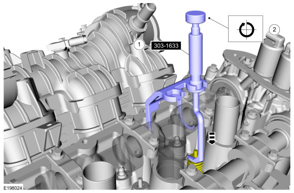

Install Special Service Tool: 303-1633 Remover, Roller Rocker Follower .
Turn the knob on the special tool clockwise to depress the valve and spring.
pic 14
Lubricate the camshaft roller follower with clean engine oil.
Install the camshaft roller follower.
Turn the knob on the special tool counterclockwise to raise the valve and spring.
Remove Special Service Tool: 303-1633 Remover, Roller Rocker Follower .
Repeat steps for the remaining camshaft roller followers.
pic 15

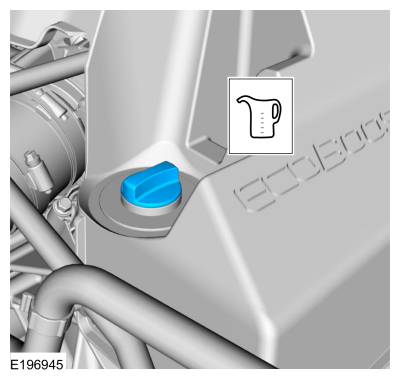

Fill the engine with clean engine oil.
Refer to: Specifications (303-01A Engine - 2.7L EcoBoost (238kW/324PS), Specifications) .
pic 16

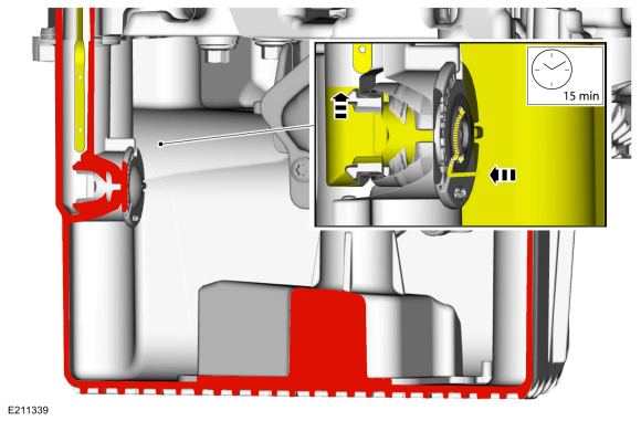

After filling the engine with oil, the oil must flow from the main chamber of the oil pan, through a check valve into the smaller side chamber to correctly register the oil level on the oil level indicator. This may take up to 15 minutes.

I'm not sure why the manual isn't being specific to which of the two drives it. I suspect they think the tech will see which it is once the valve cover is off.

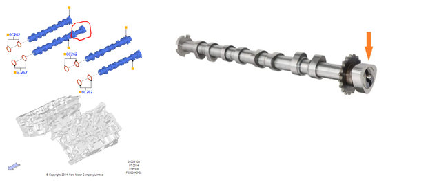

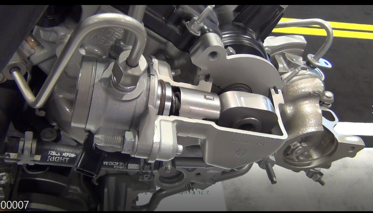

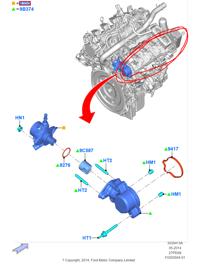

I just spoke with the owner of the site regarding this. He sent a better picture to me and it appears to be the exhaust cam. Take a look at the picture and let me know if it helps.
Oct 21, 2020 at 6:03 PM

Hi Joe, thanks a lot for the replies. Really appreciate your help on this. Actually, I am working on a project where I am running the high pressure fuel pump standalone in a lab environment. To run the pump I was trying to buy the camshaft with the cam lobe. I saw there were 4 versions. Based on your advise, I think it seems like its RH-Exhaust.

I had the image below, It looks like the shaft with the lobe is in RH side of the vehicle as well. But I was unsure if it was exhaust or intake.
Oct 22, 2020 at 6:16 AM
SU91RAJ
  • 4 POSTS
I found a better image, I think this is an RH-exhaust camshaft.
Oct 22, 2020 at 7:31 AM
That does look like it's the one. Keep in mind, the last pic I sent was a cut away view. So, the cam really isn't exposed. The lobes on the actuator will require lubrications. Otherwise, it will fail.
