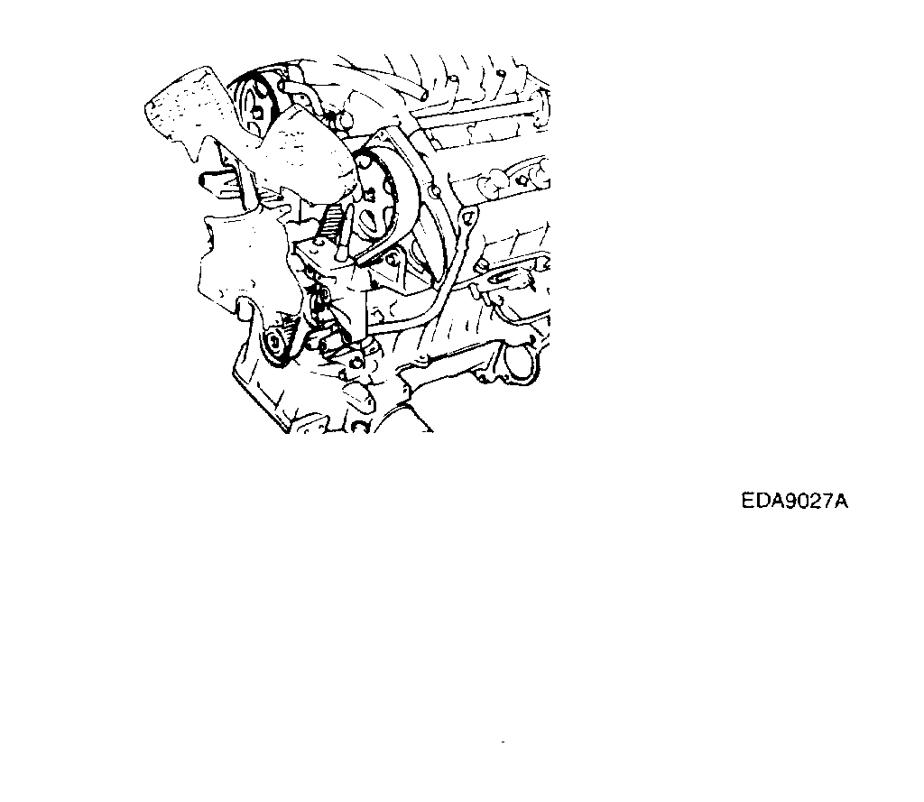

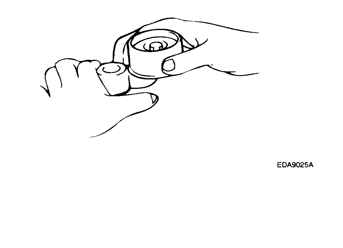

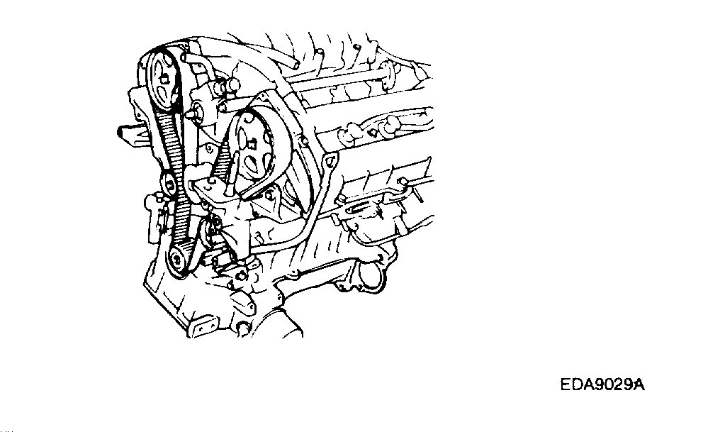

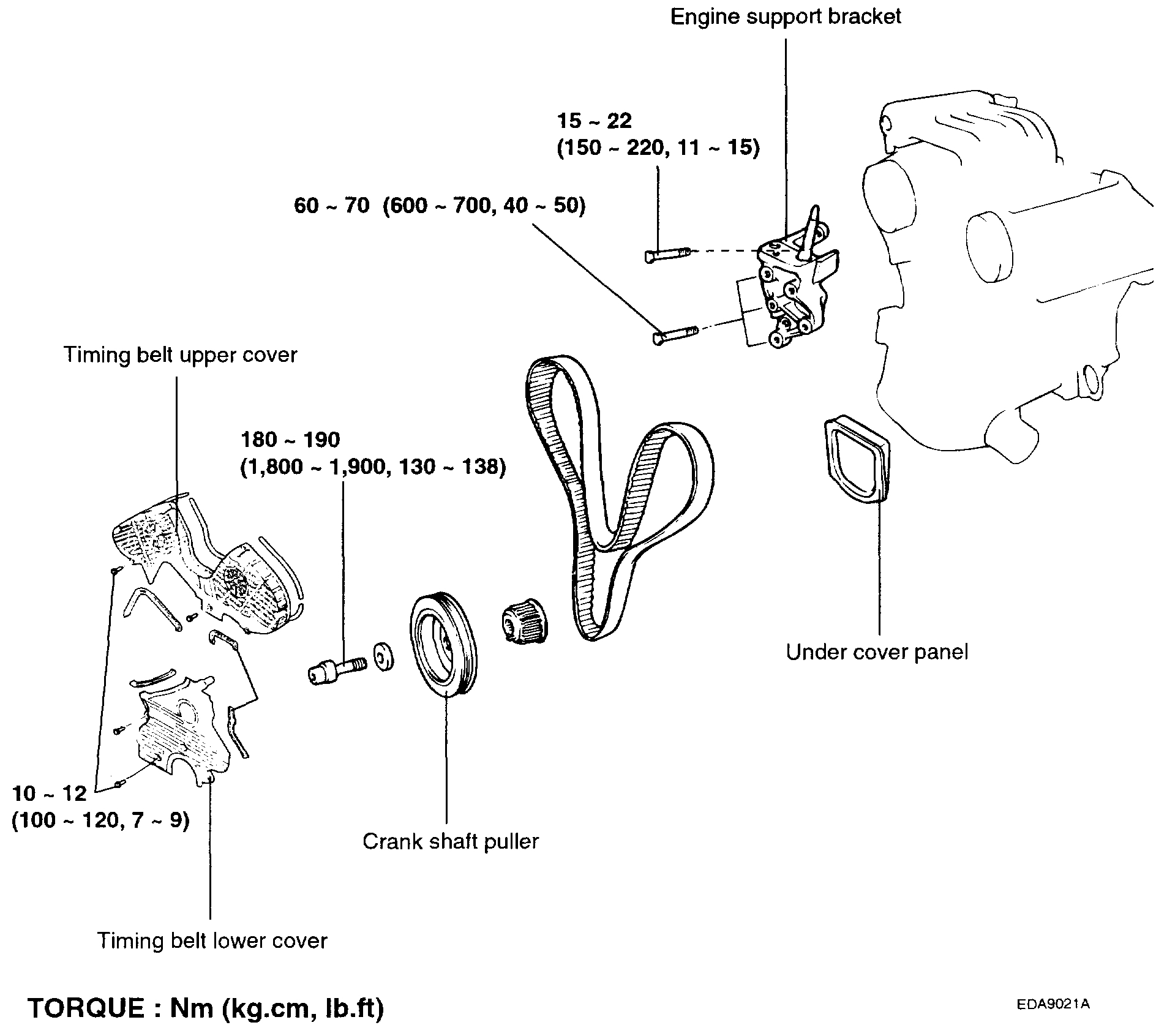

Here are the directions specific to your vehicle for belt replacement. All attached pictures correlate with these directions.
PROCEDURES

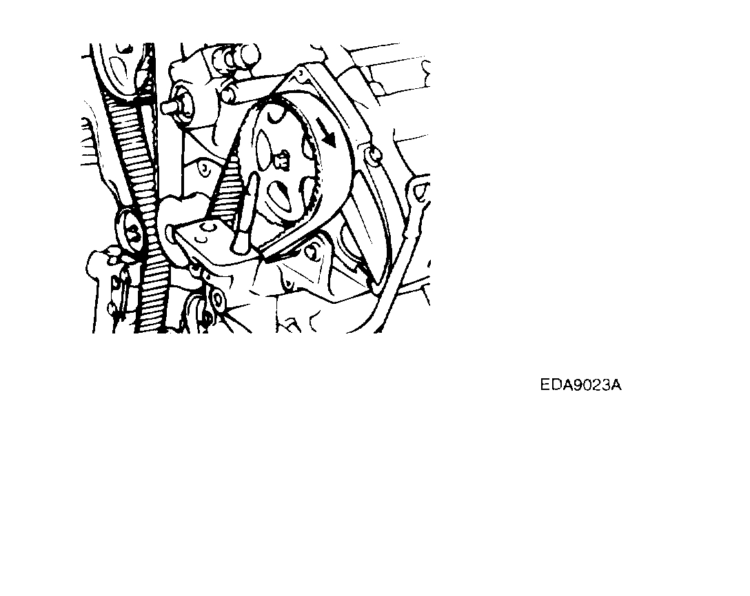

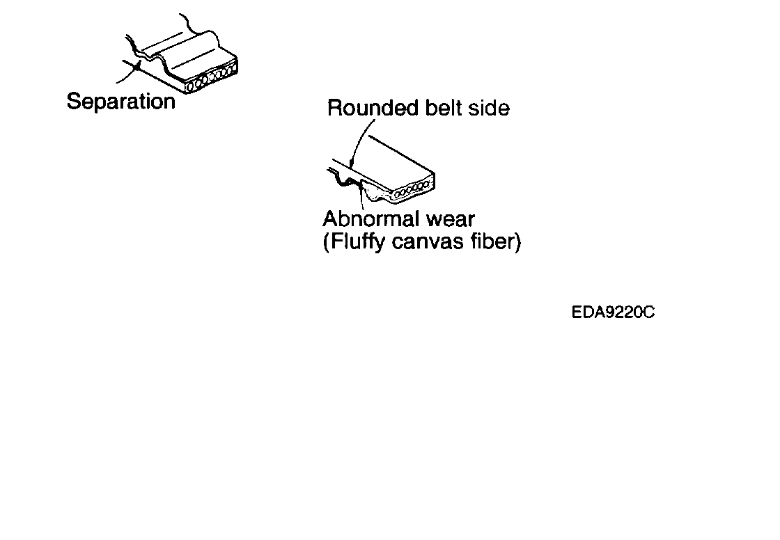

Timing Belt

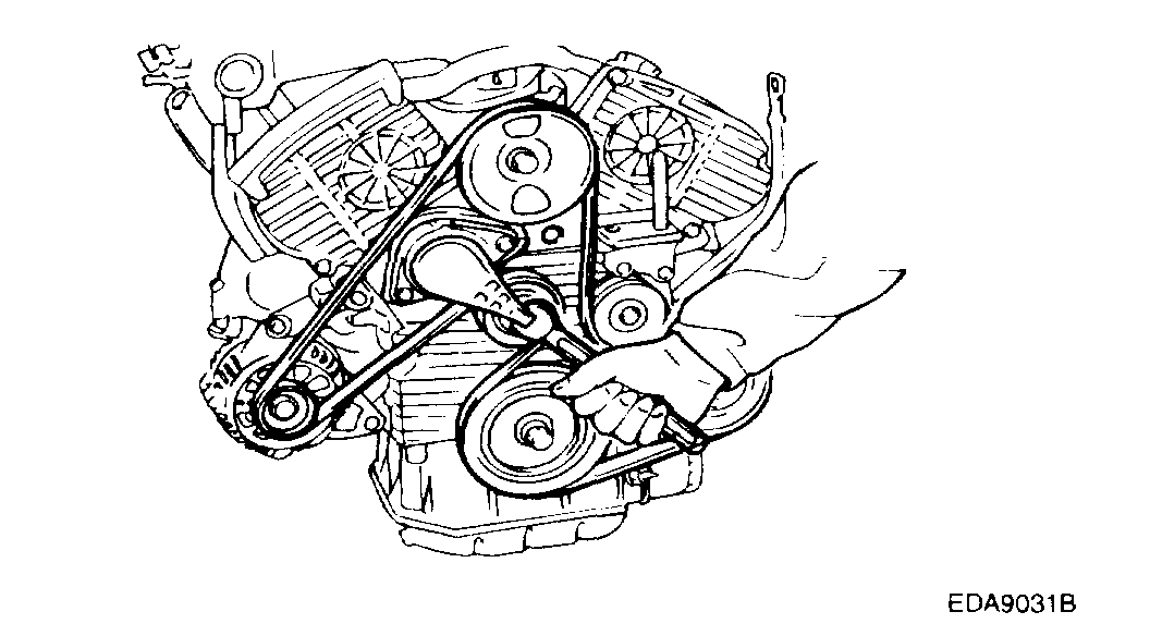

Picture 1

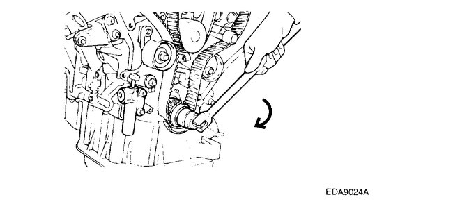

Picture 2

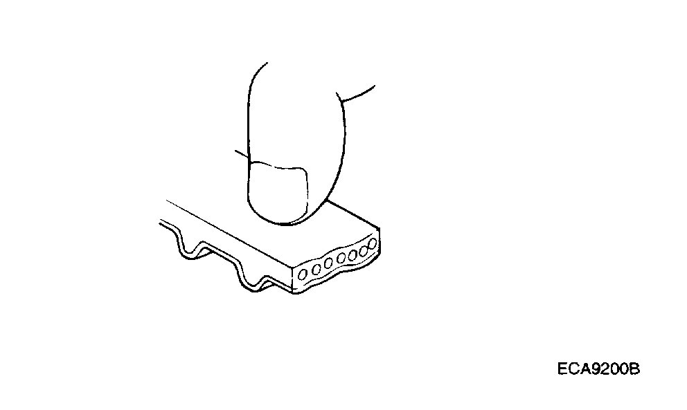

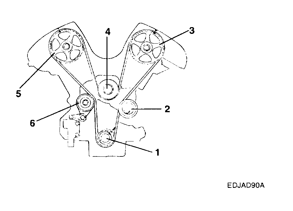

Removal

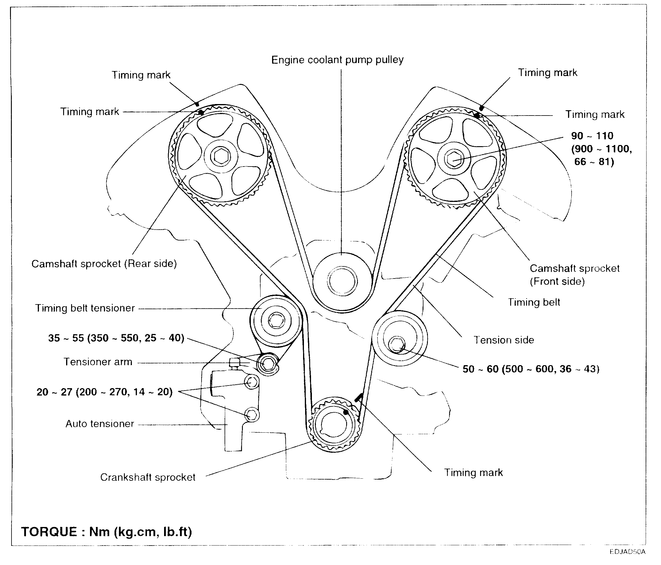

Picture 3

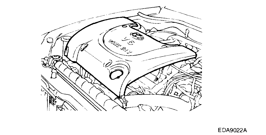

1. Remove the engine cover.

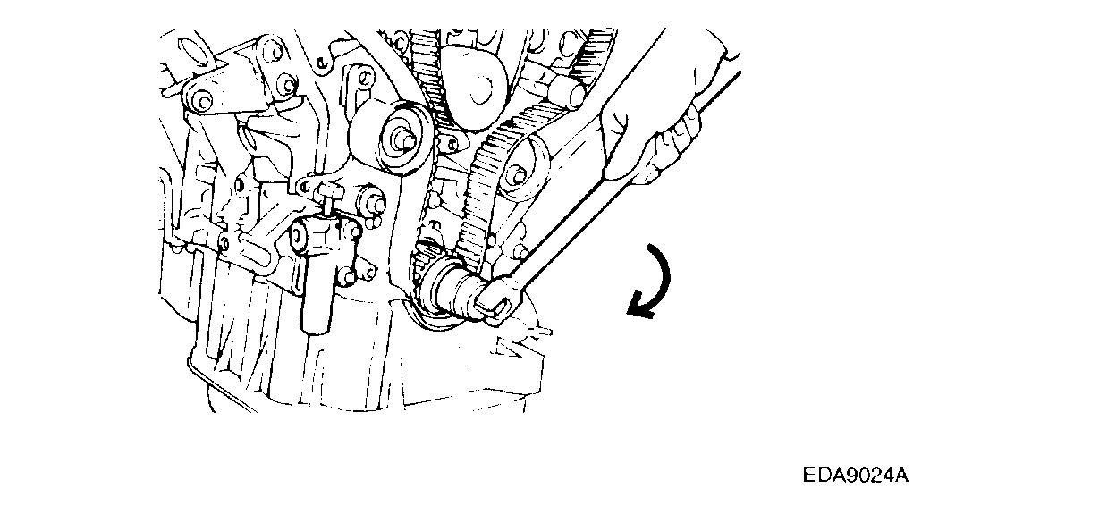

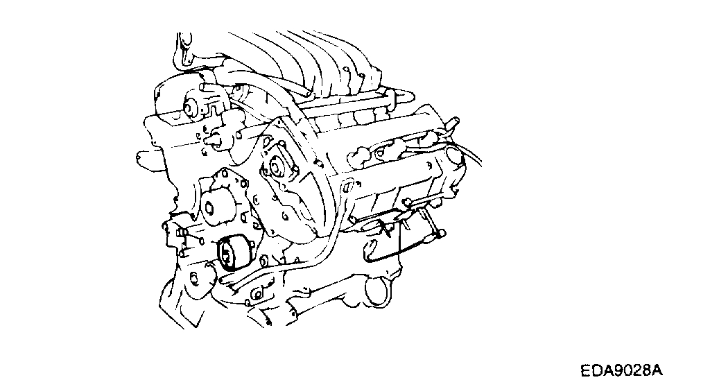

Picture 4

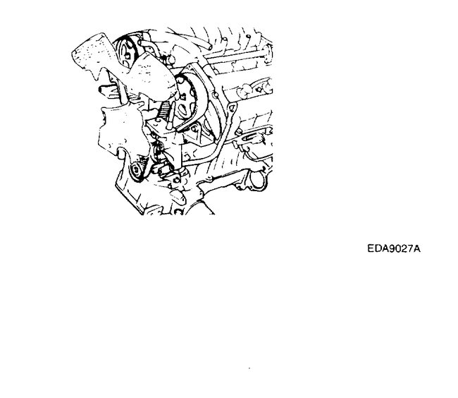

2. Using a [16 mm], rotate the tensioner arm clockwise (about 14°) and remove the belt from the pulley.
3. Remove the power steering pump pulley, idler pulley, tensioner pulley and crankshaft pulley.

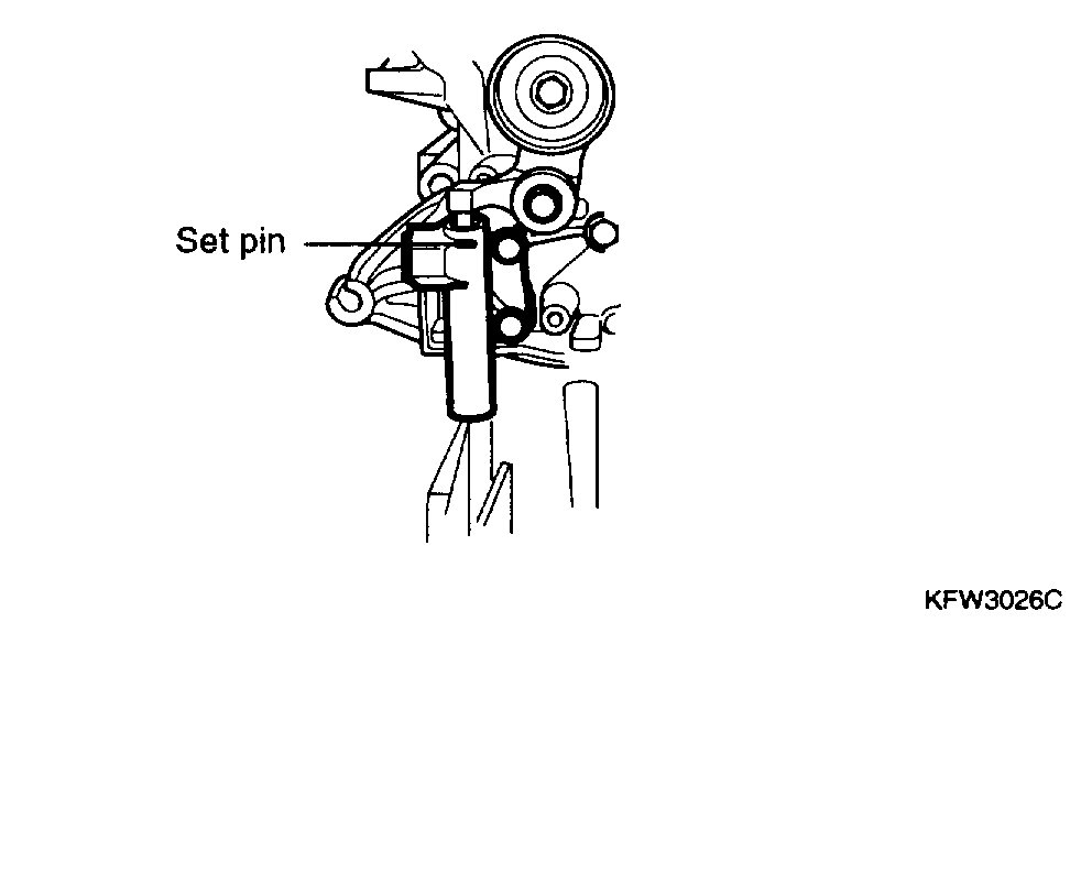

Picture 5
4. Remove the upper and lower timing belt covers.

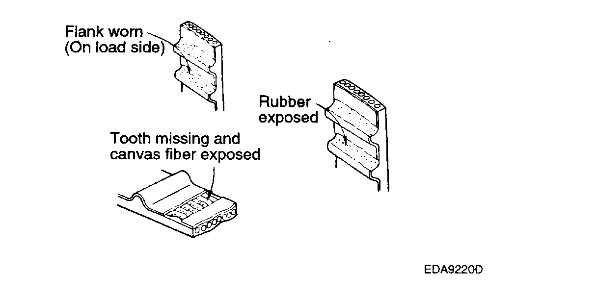

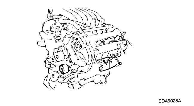

Picture 6
5. Remove the auto tensioner.
Note: Rotate the crankshaft clockwise and align the timing mark to set the No. 1 cylinder's piston to TDC (compression stroke).
At this time, the timing marks of the camshaft sprocket and cylinder head cover should coincide with each other.
Picture 7
6. Unbolt the tensioner to remove the timing belt.
Note: If you plan to use the timing belt again, mark the rotation direction on the belt so you reinstall it correctly.

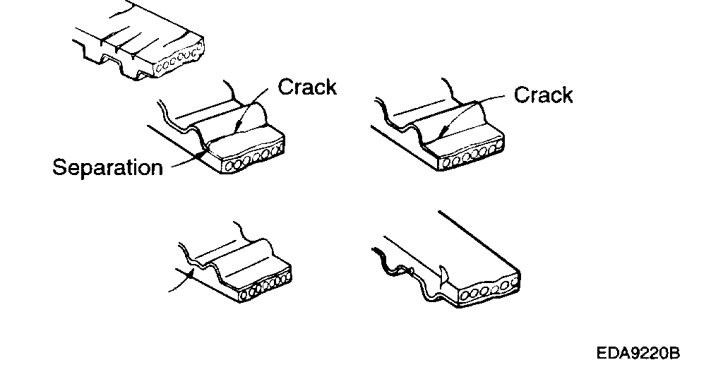

Inspection
1. Inspect the belt closely. If the following problems are evident, replace the belt with a new one.

1) Hardened back surface of rubber Back surface is glossy, non-elastic and so hard that when the nail of your finger is pressed into it, no mark is produced.
Picture 9
2) Cracked back surface of rubber.

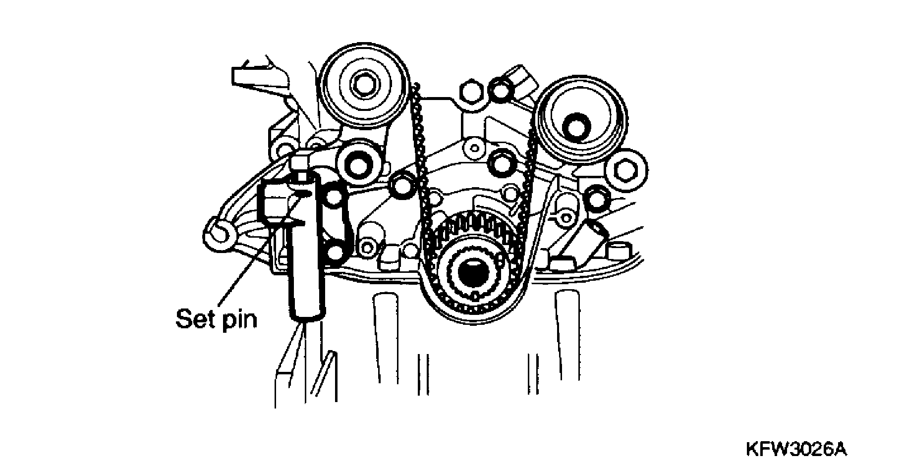

5. Install the auto tensioner to the front case.
Note:At this time auto tensioner's set pin should be compressed and secured with set pin.

6. Align the timing marks of each sprocket and install the timing belt in the following order.
1. Crankshaft sprocket
2. Idler pulley
3. Camshaft sprocket (LH side)
4. Water pump pulley
5. Camshaft sprocket (RH side)
6. Tensioner pulley

7. Pull out the set pin of the auto tensioner.

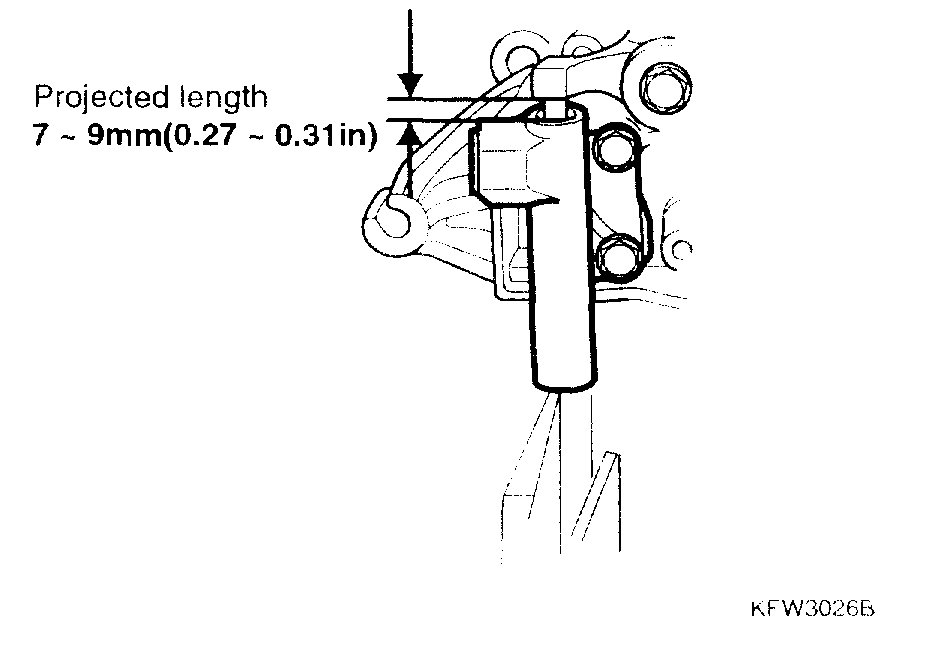

1. Rotate the crankshaft 2 turns clockwise and measure the projected length of the auto tensioner at TDC (# 1 Compression stroke) after 5 minutes.
2. The projected length should be 7-9 mm.
Picture 18
3. Verify that the timing marks of each sprocket are in their specified position.
Note: If the timing marks are not in their specified position, repeat from 6 above (in the installation procedure).
