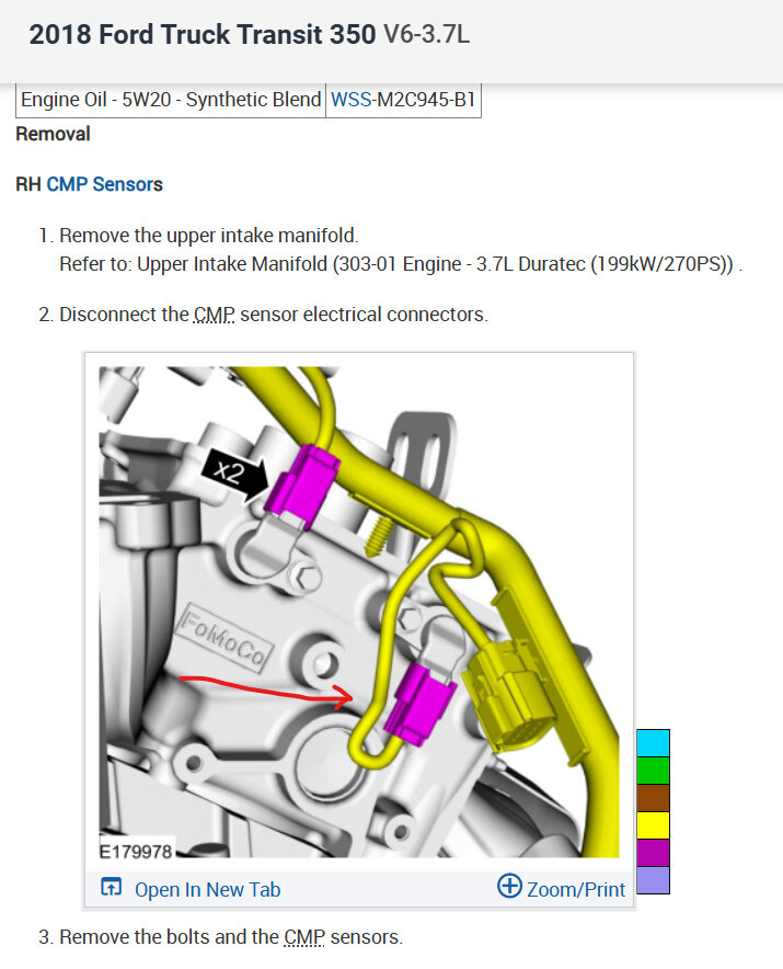

Sure, the camshaft sensor bank 1 (right side) sensor B (exhaust camshaft) is on the right side of the engine (passengers side)
Code P0369 for an issue with the Camshaft Position Sensor B Circuit Intermittent (Bank 1).
I can tell you though this can be a false code because the camshaft actuator is not working correctly due to low or dirty engine oil, I would change the oil and filter and then clear the codes before changing the sensor out. FYI, Check out the images (below). Please let us know what happens.

Thanks! Uhg. unfortunately looks like I have to take off the intake manifold to access it. Appreciate the oil tip. I just took in for quick drive thru oil change last week. Checked oil just now- is over filled by looks like 2 quarts. Could be it?
