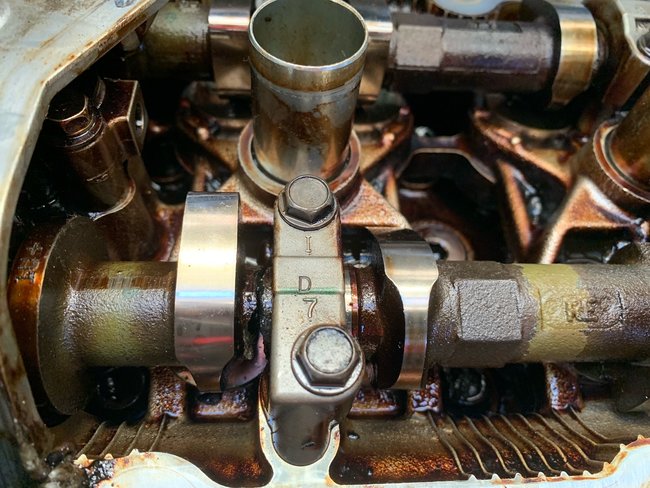

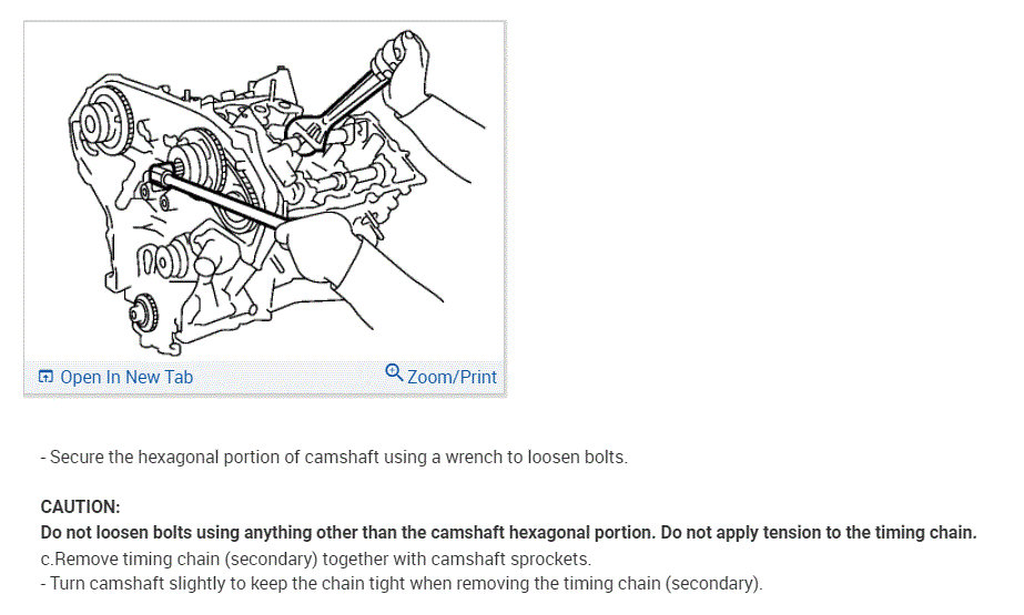

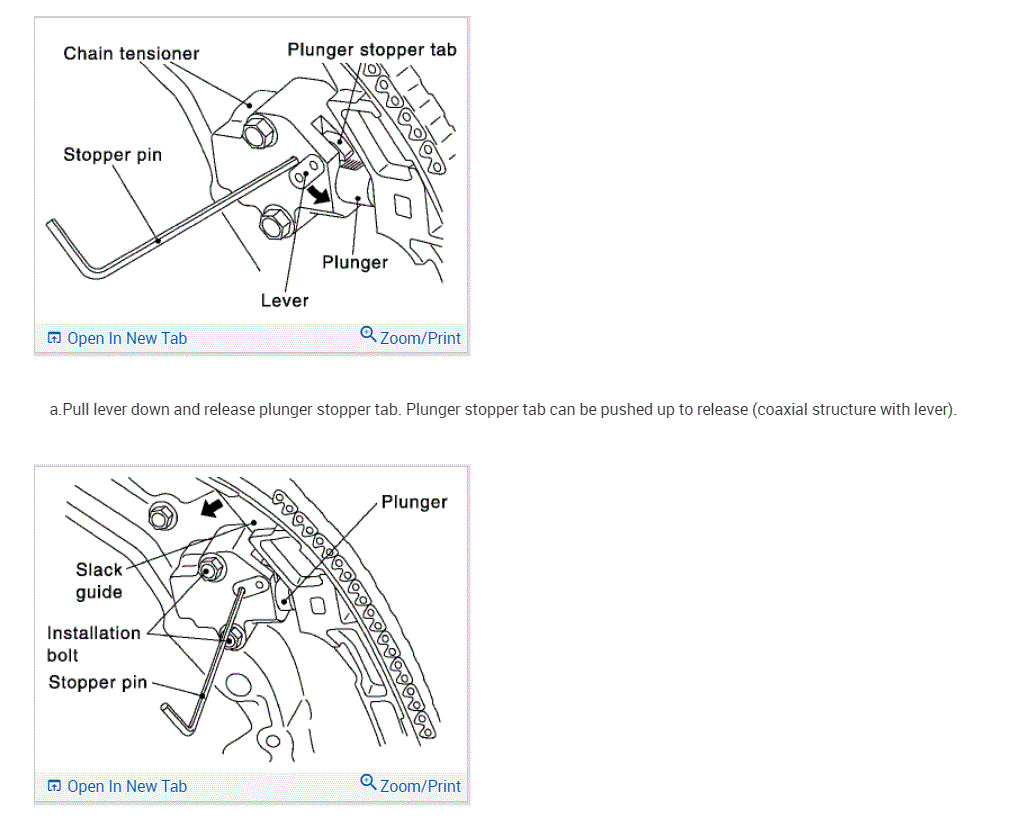

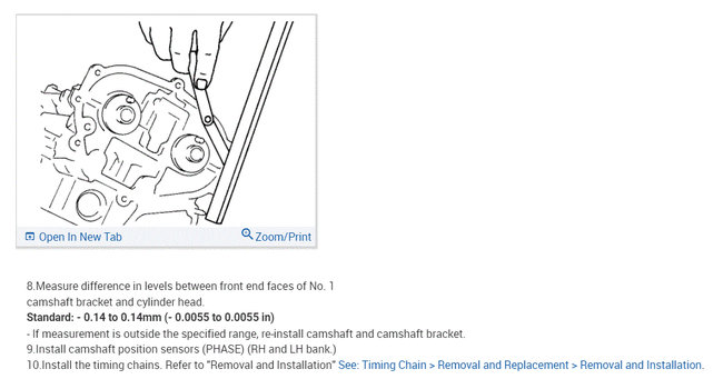

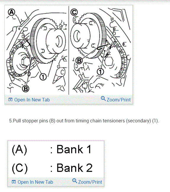

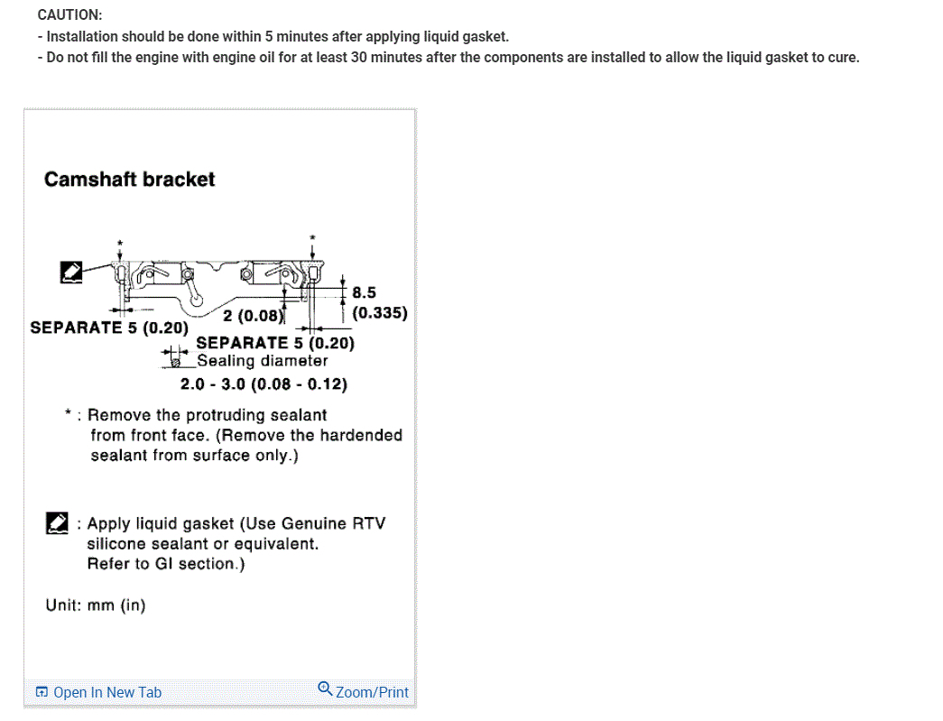

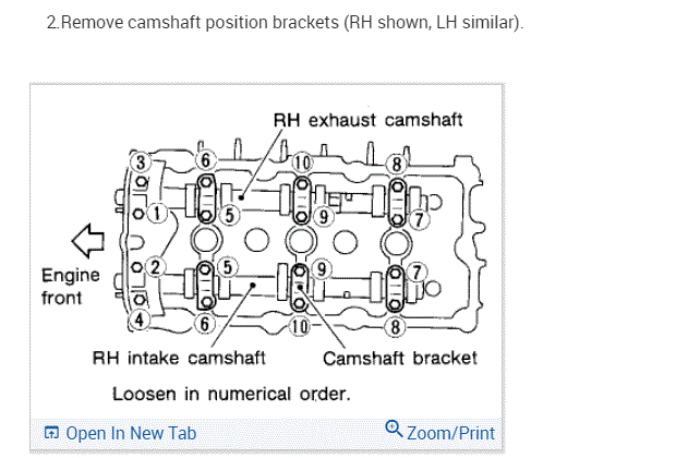

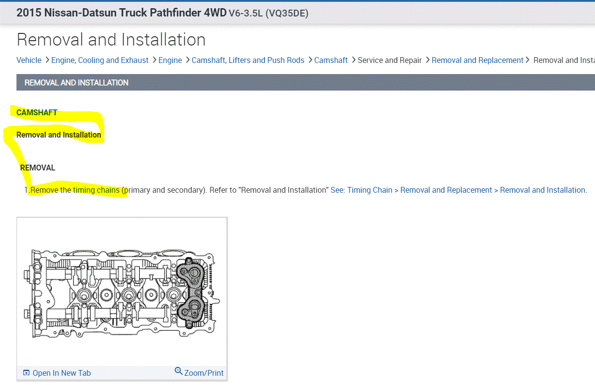

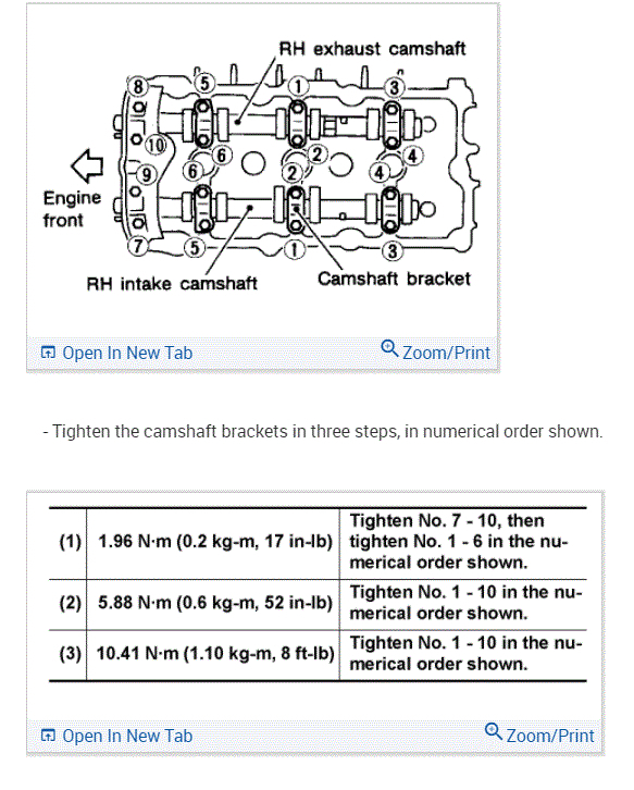

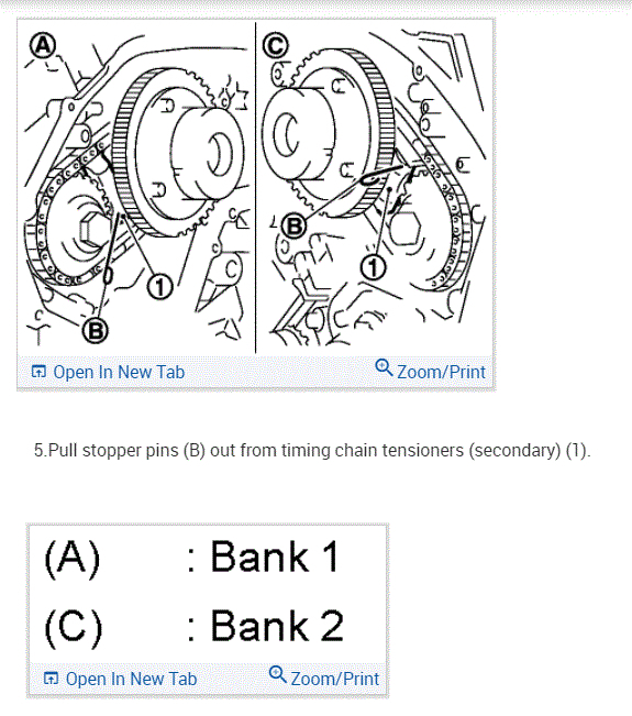

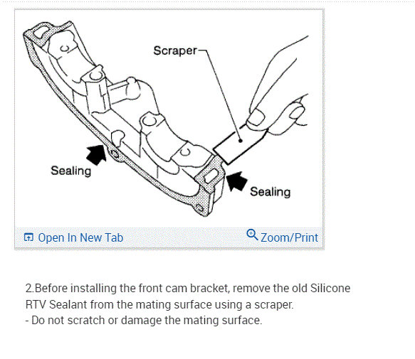

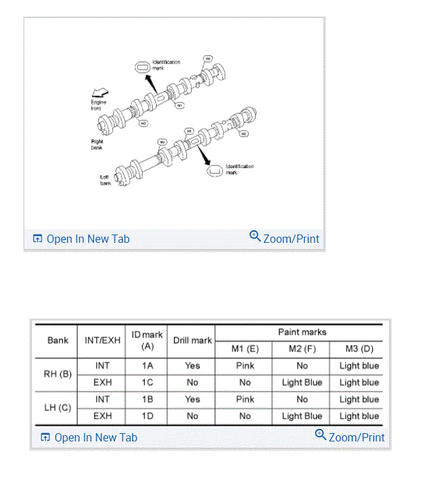

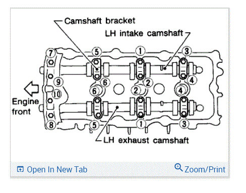

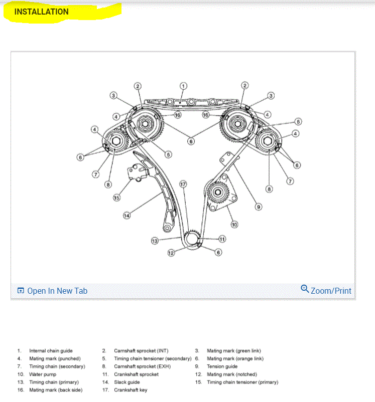

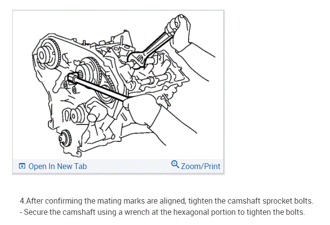

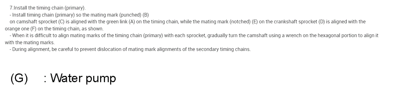

I too went down the rabbit whole replacing the camshaft sensors because of the error code. so, I decided while I had intake manifold off and everything out of the way, to change the plugs. When I got to the last one, I noticed the socket had oil on it. I removed the plug, and it was covered with oil! So, I searched this site for causes, one experience said it was the VCG (valve cover gasket). I removed the VCG and found that one of the camshafts was broken.
What should I do next? Do you have any diagrams on removal or suggestions?
