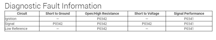

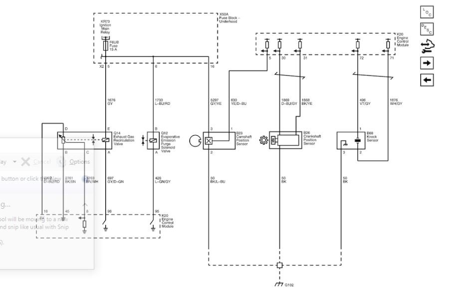

Apr 1, 2020 at 1:33 PM
Okay, I attached a wiring diagram of the sensors for you to review.
Let me know if you have any other questions.
Apr 1, 2020 at 1:47 PM

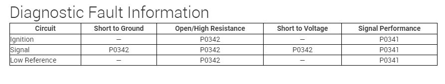

Apr 1, 2020 at 2:02 PM
Attached for you to review.
