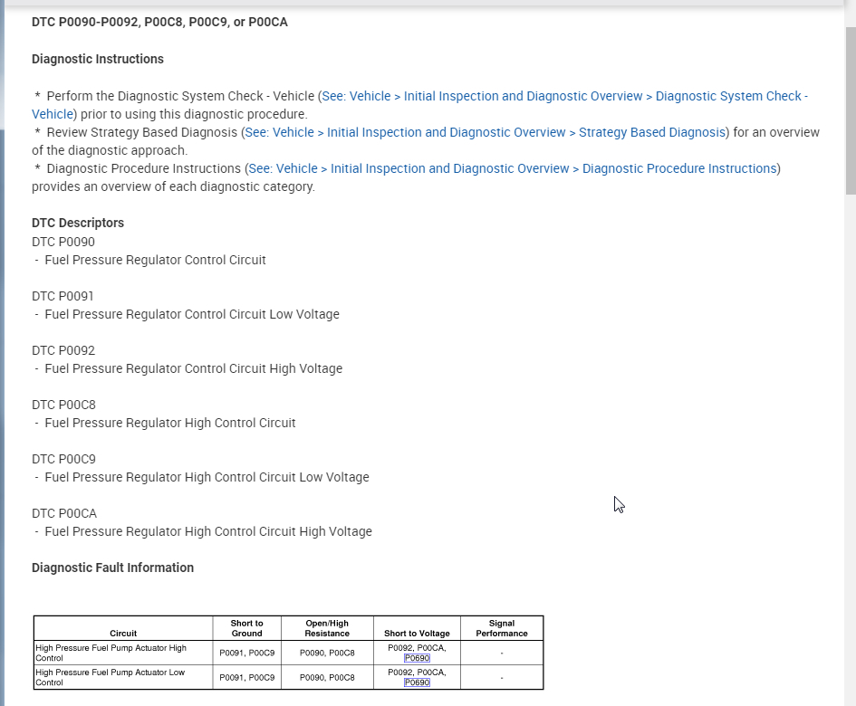

I guess I ruined it, I have bunch of codes at the same time including 00c8.
Oct 3, 2020 at 8:46 PM

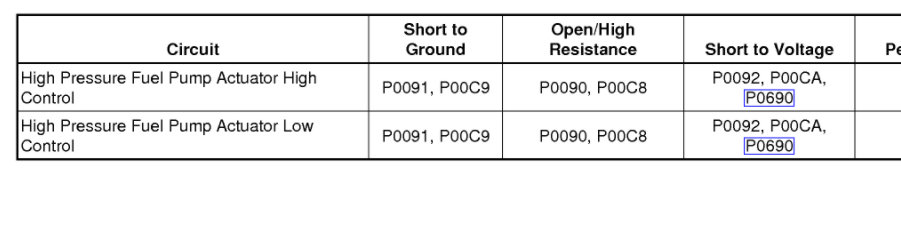

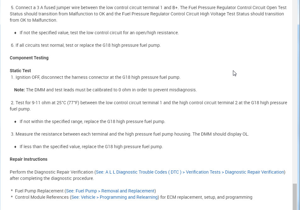

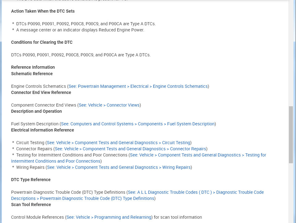

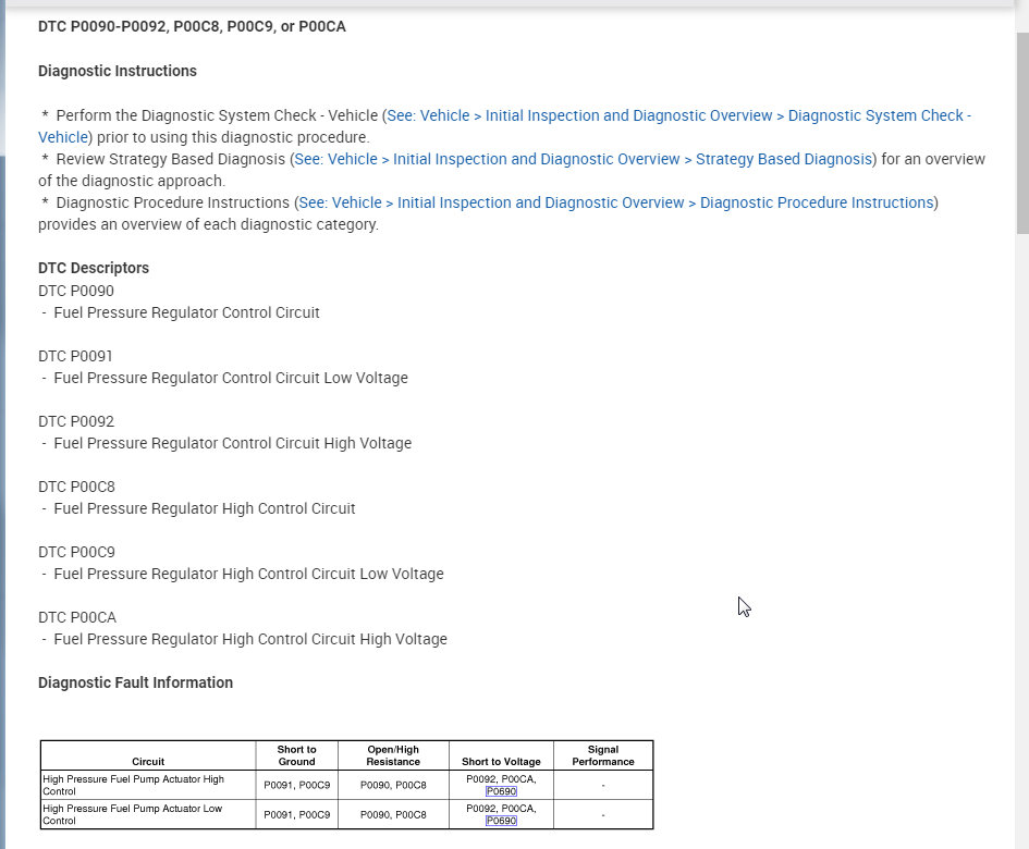

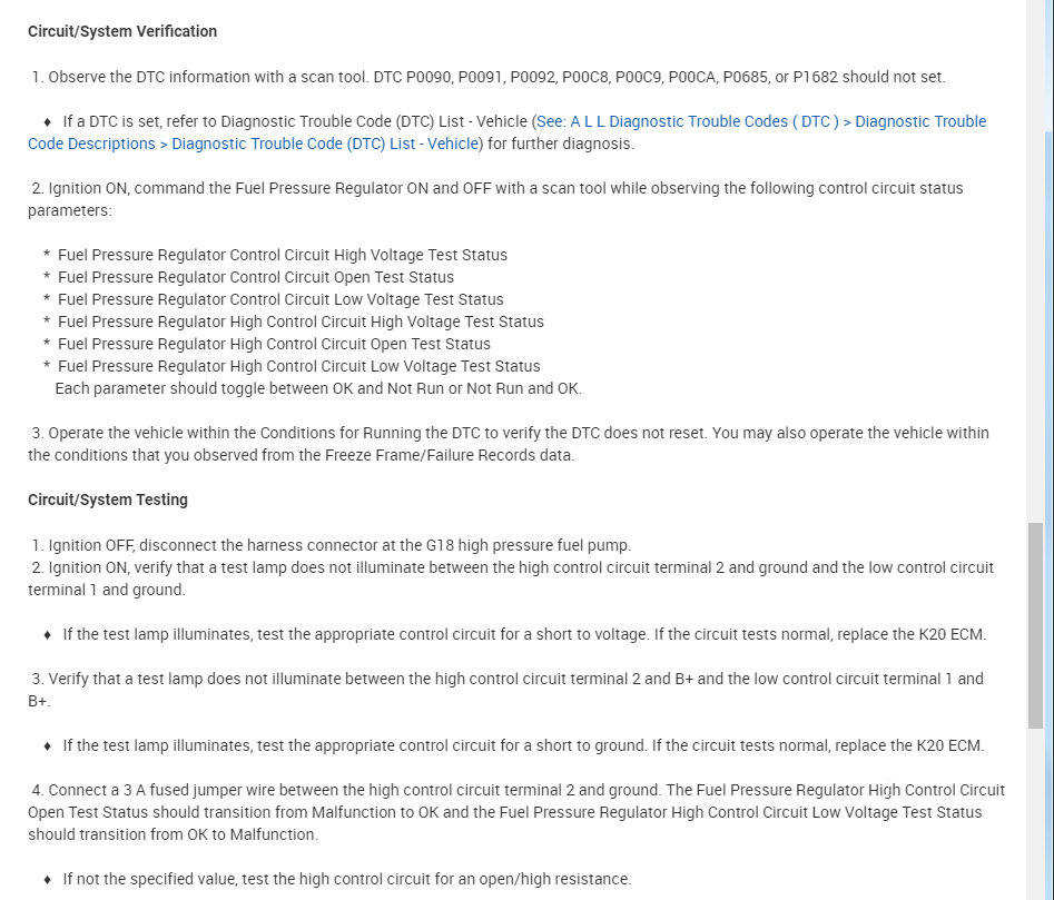

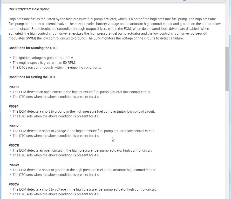

Okay. That is not terrible news. It at least explains the no start issue. Take a look at these attachments and tell me if these other codes are the ones listed on this testing. The P00c8 is an open circuit DTC so maybe we should go back through the connectors that you took apart and make sure none are loose. That would explain why this started after the repair you made. It will also explain why you have a lot of other codes as I suspect they are all open circuit codes as well.
