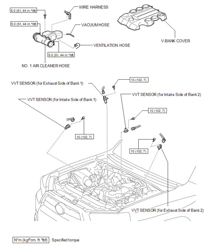

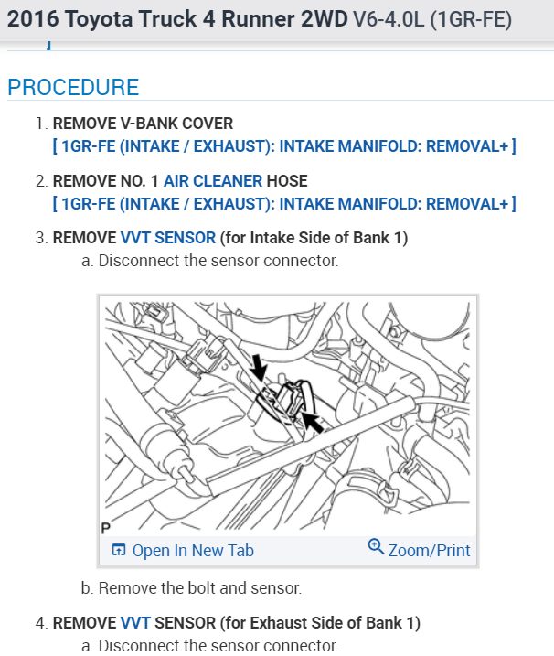

Trying to replace camshaft sensors can’t find all of them. Need location.
Sep 2, 2023 at 10:46 AM
CERTIFIED EXPERT
53,855 POSTS

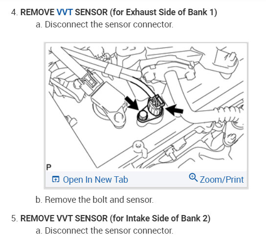

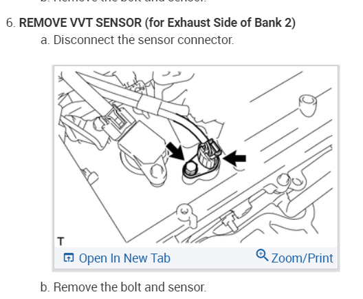

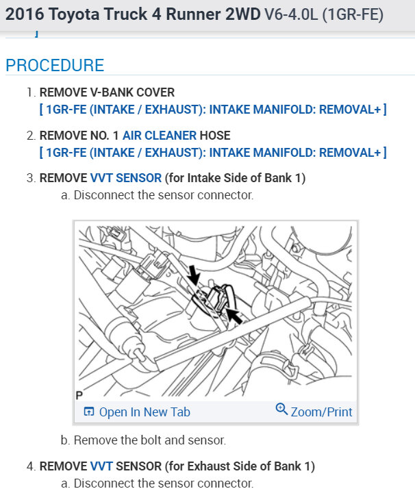

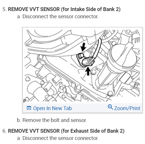

Sure, there are four camshaft position sensors, but they are called VVT sensors for the truck which are mounted on top of the valve covers. Here are the locations for the sensors in the images below. Check out the images (below). Please let us know if you need anything else to get the problem fixed.
