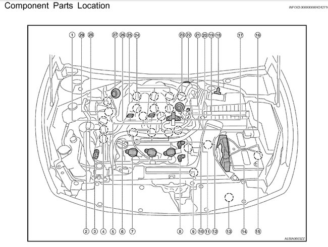

I want to know location of the camshaft sensors on car listed above SV model. Are they on the same side as the battery on? Could you send me picture of them on the car?

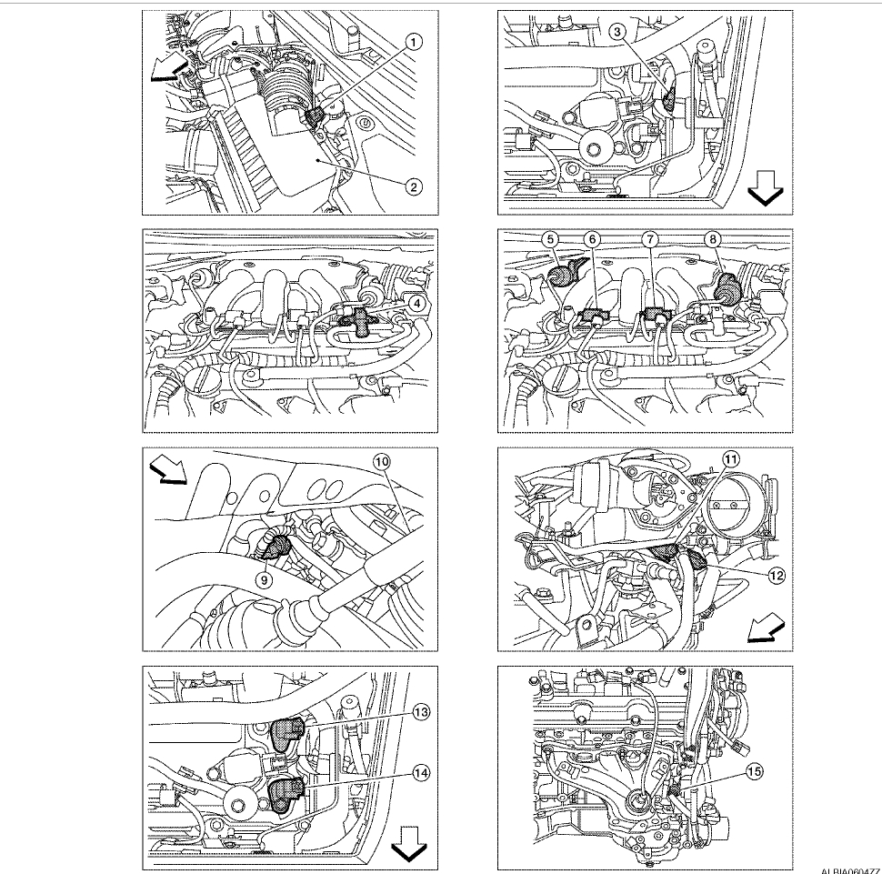

They are both on the drivers side of the engine, tucked under the air cleaner and intake. What is the code you are getting or the problem? If it is anything saying there is a timing or cam/crank problem it is not the sensors as it takes their signals to create those codes.
The timing chains and tensioners are common issues however. Those will set cam/crank codes all the time.

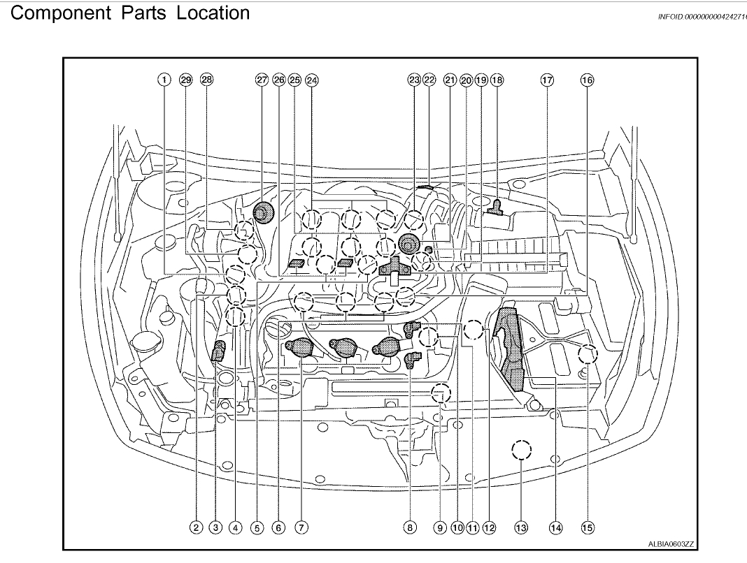

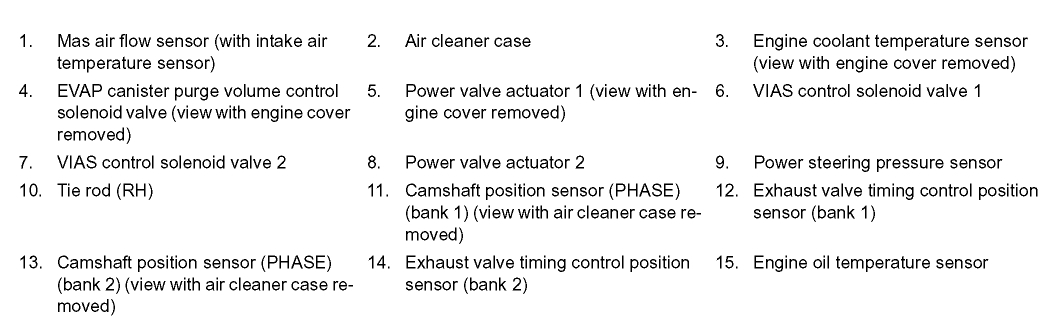

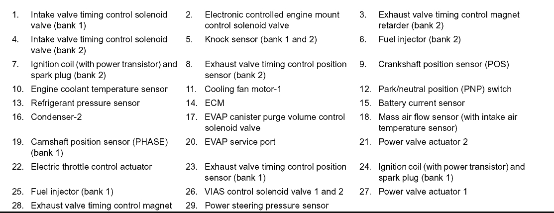

Here is a guide and the locations of the senors so you can change them out.
This will give you an idea of what you are in for when doing the job.
https://www.2carpros.com/articles/camshaft-angle-sensor-replacement
Check out the diagrams (below).

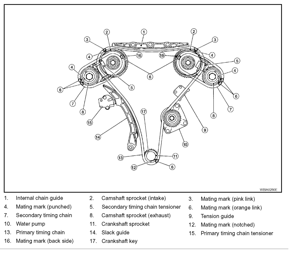

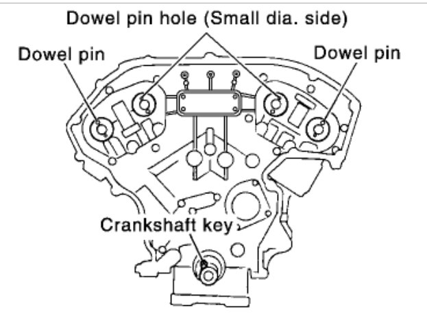

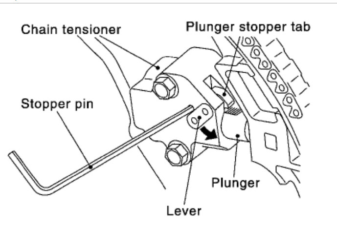

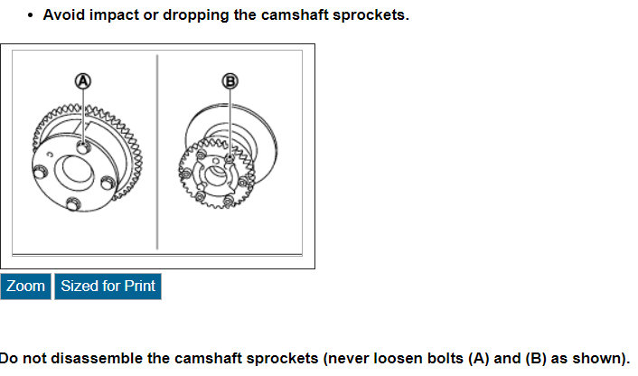

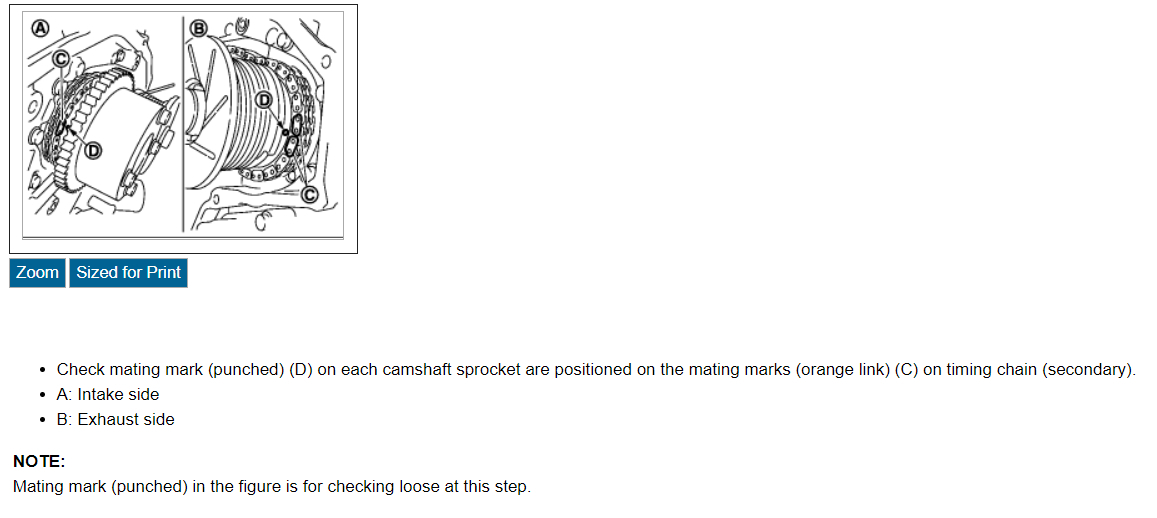

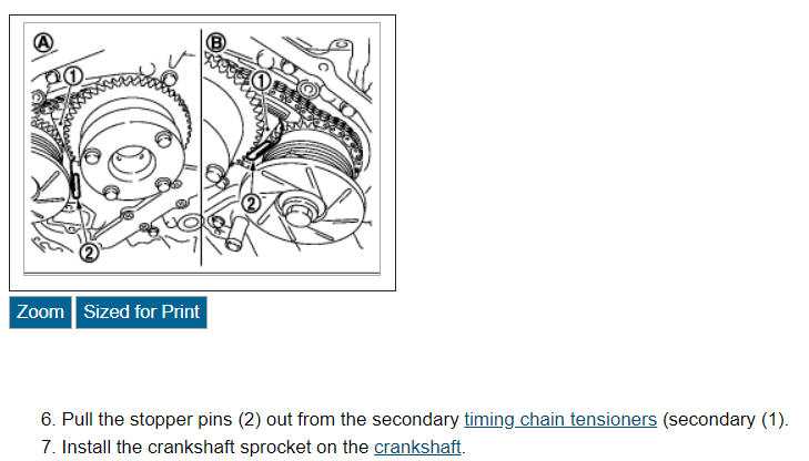

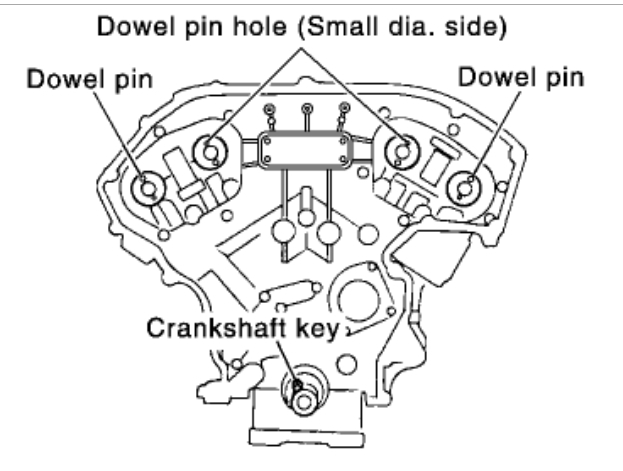

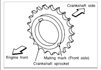

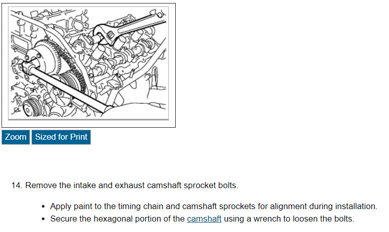

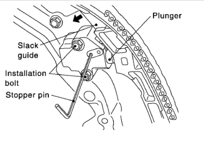

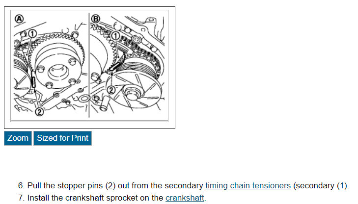

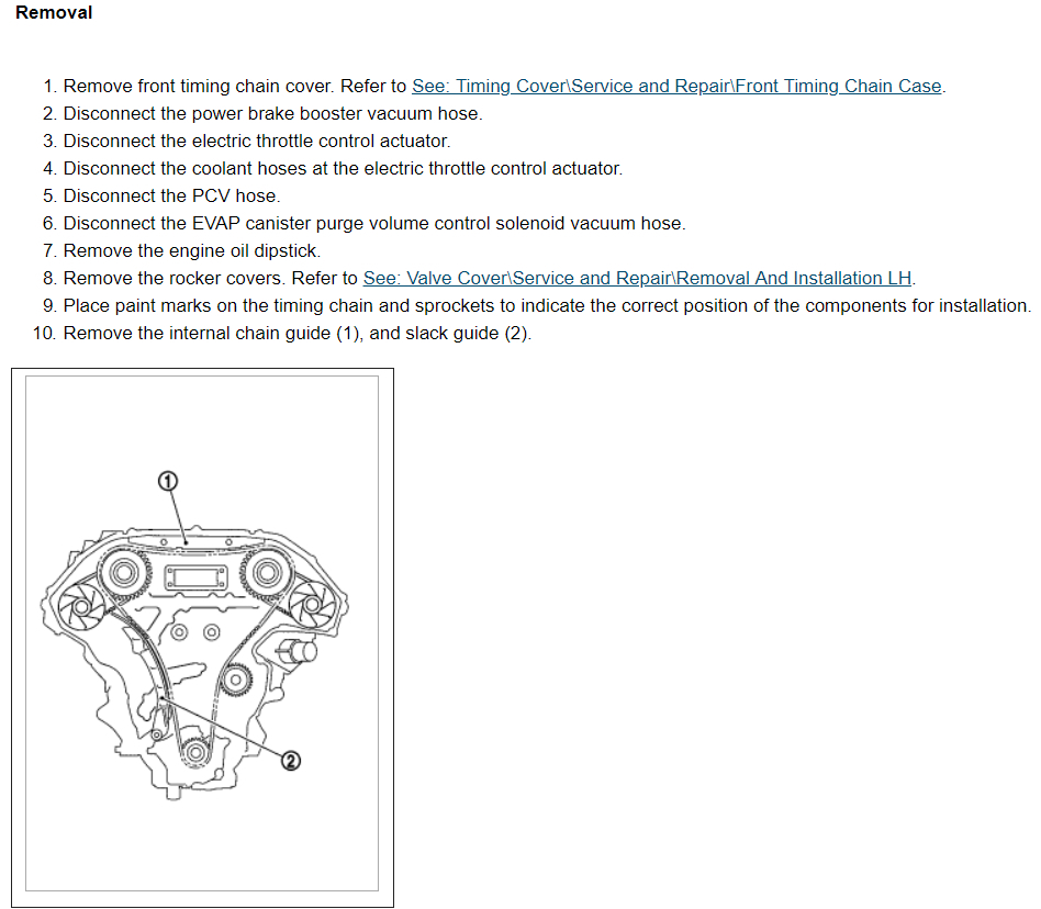

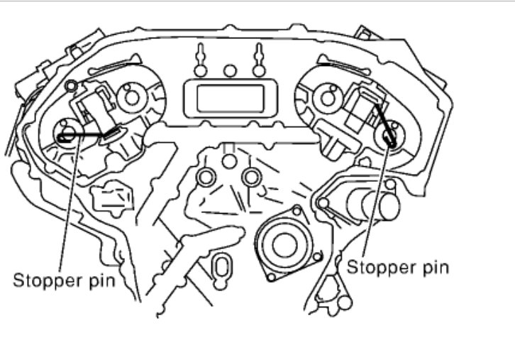

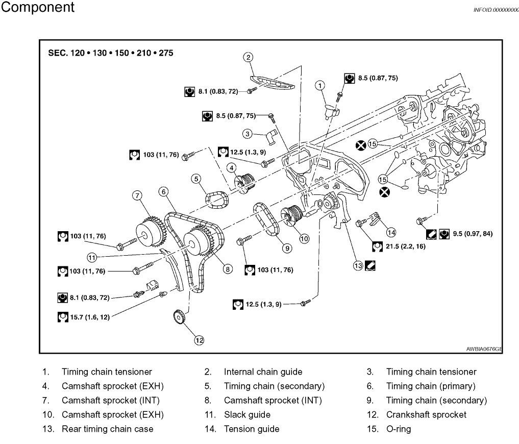

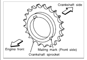

Yes, that can cause the problem, here are diagrams to help you see what you are in for when doing the job.
