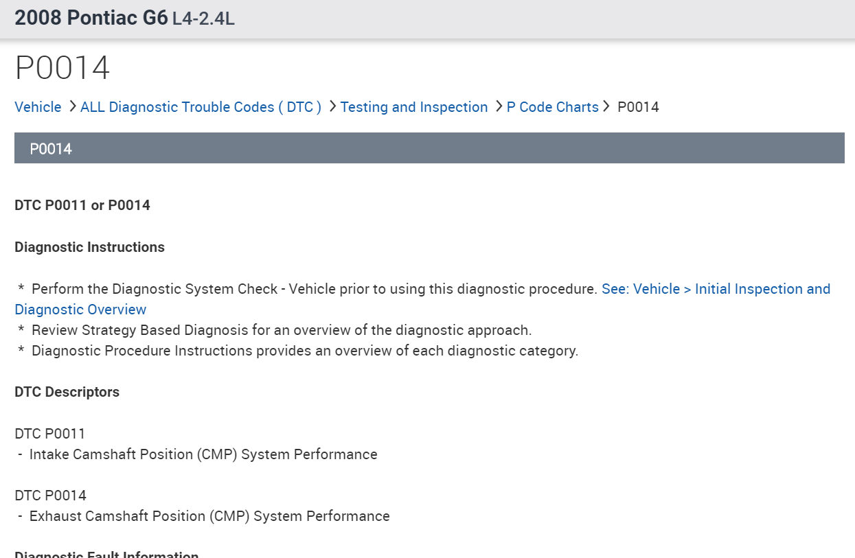

The check engine light came on had it scanned to Cole, came up p0013 and p0014. change both sensors twenty minutes later light came back on. scan again same two things. why? what can be wrong?

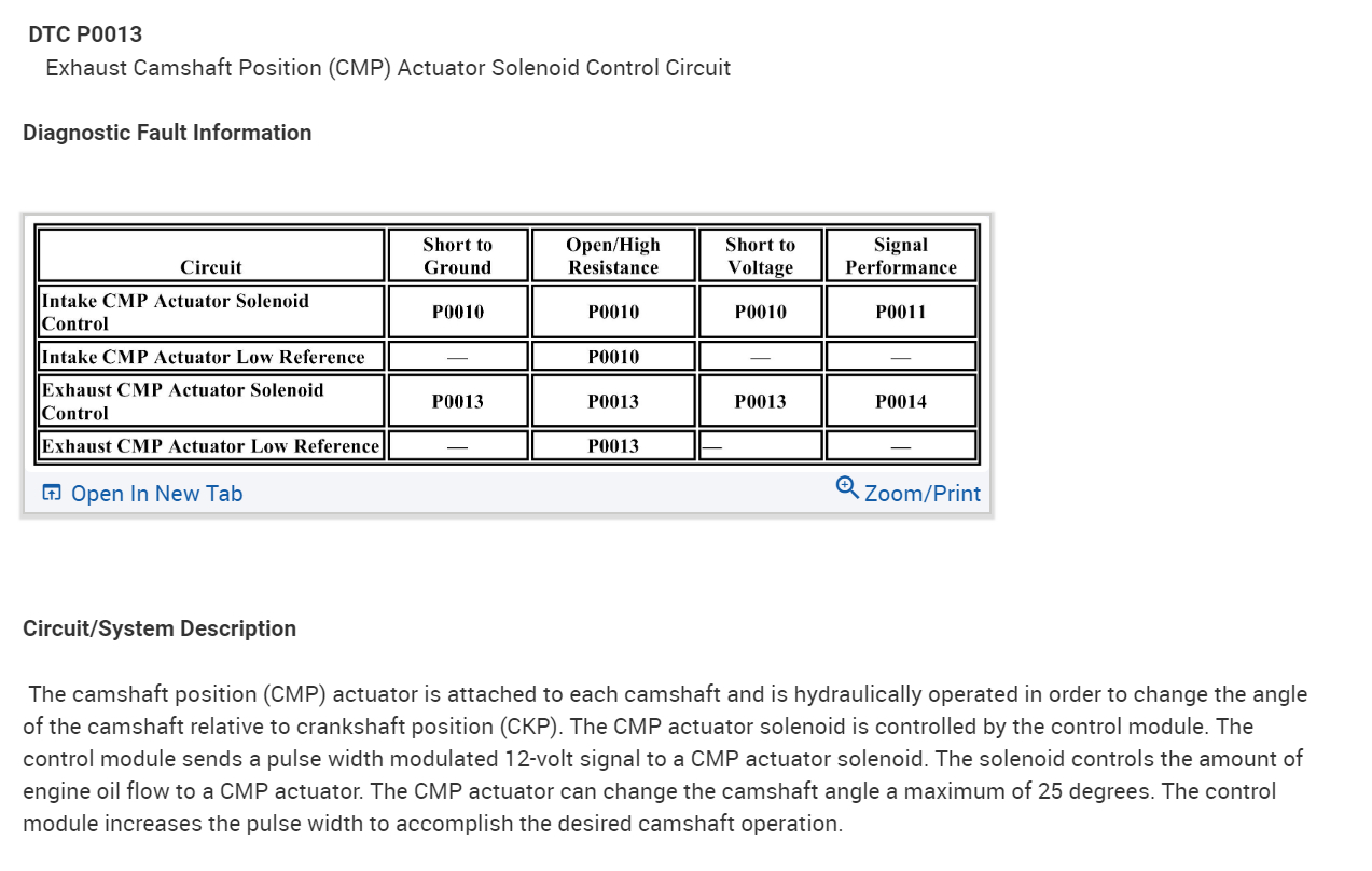

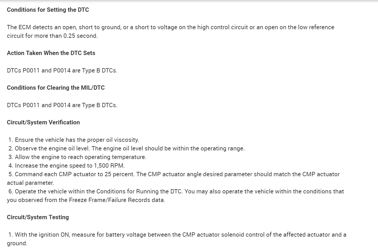

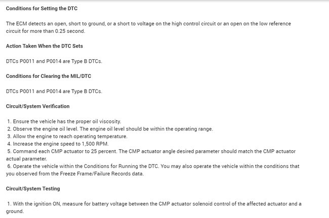

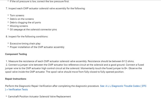

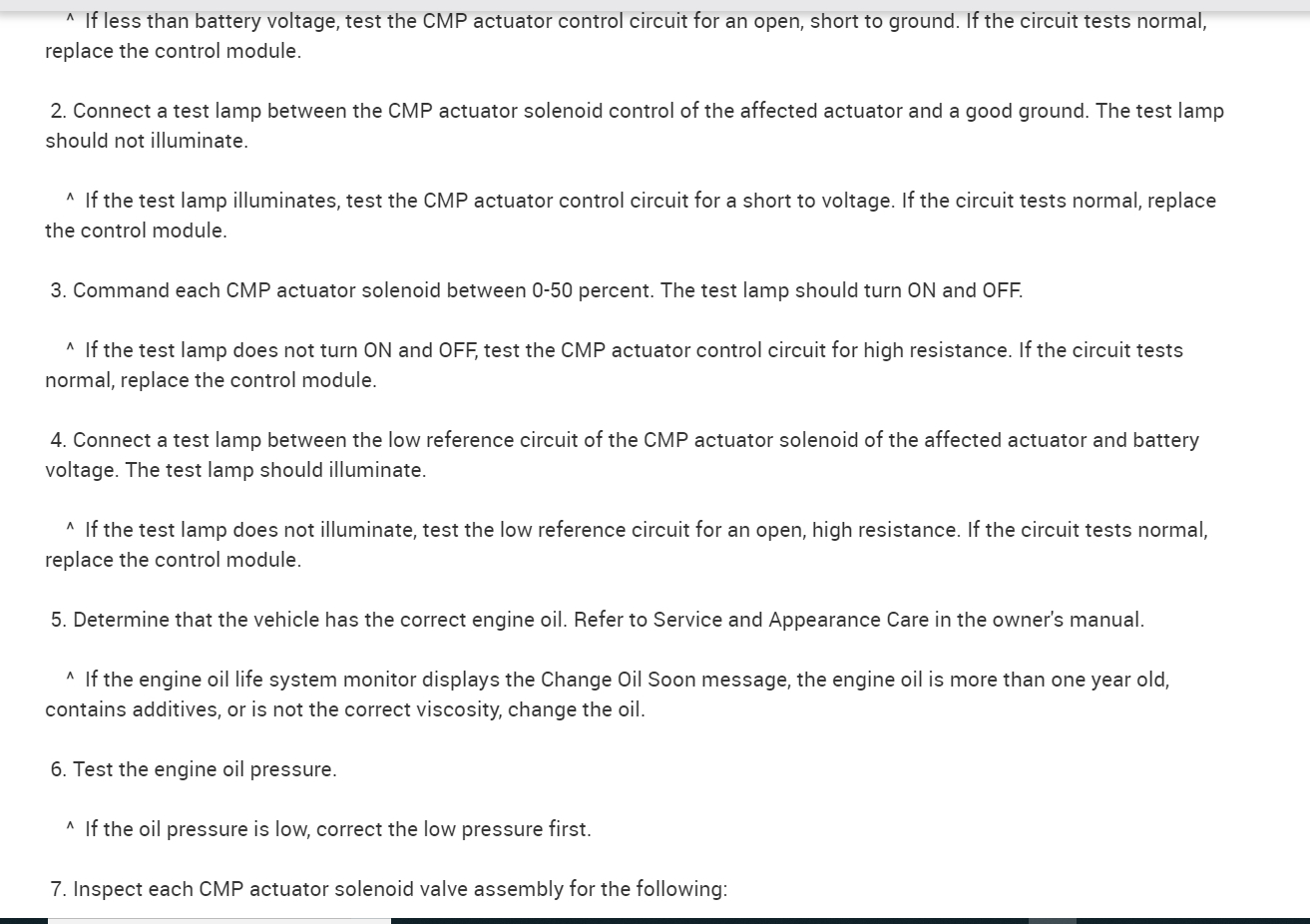

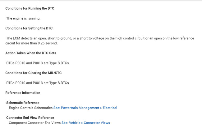

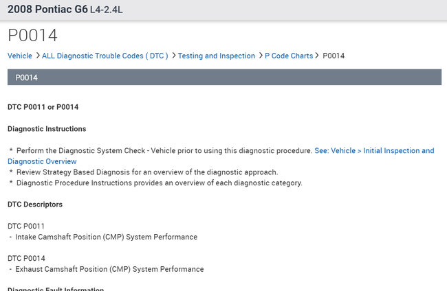

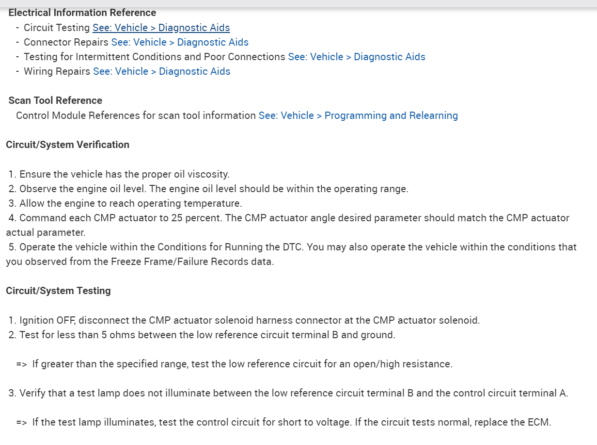

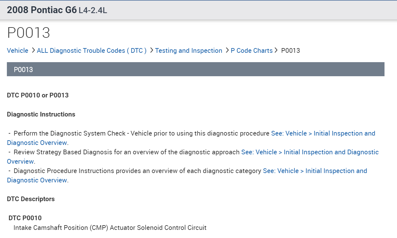

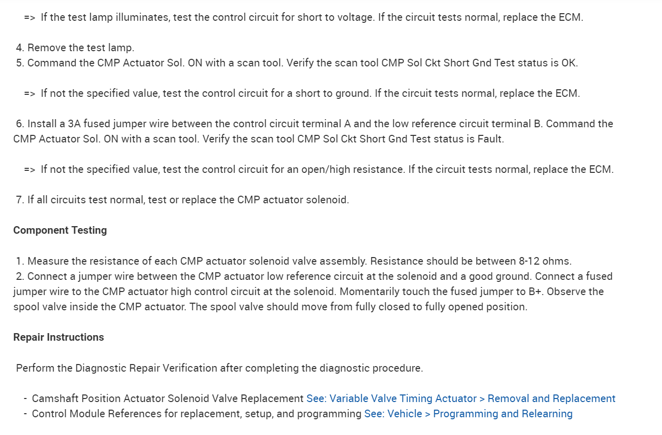

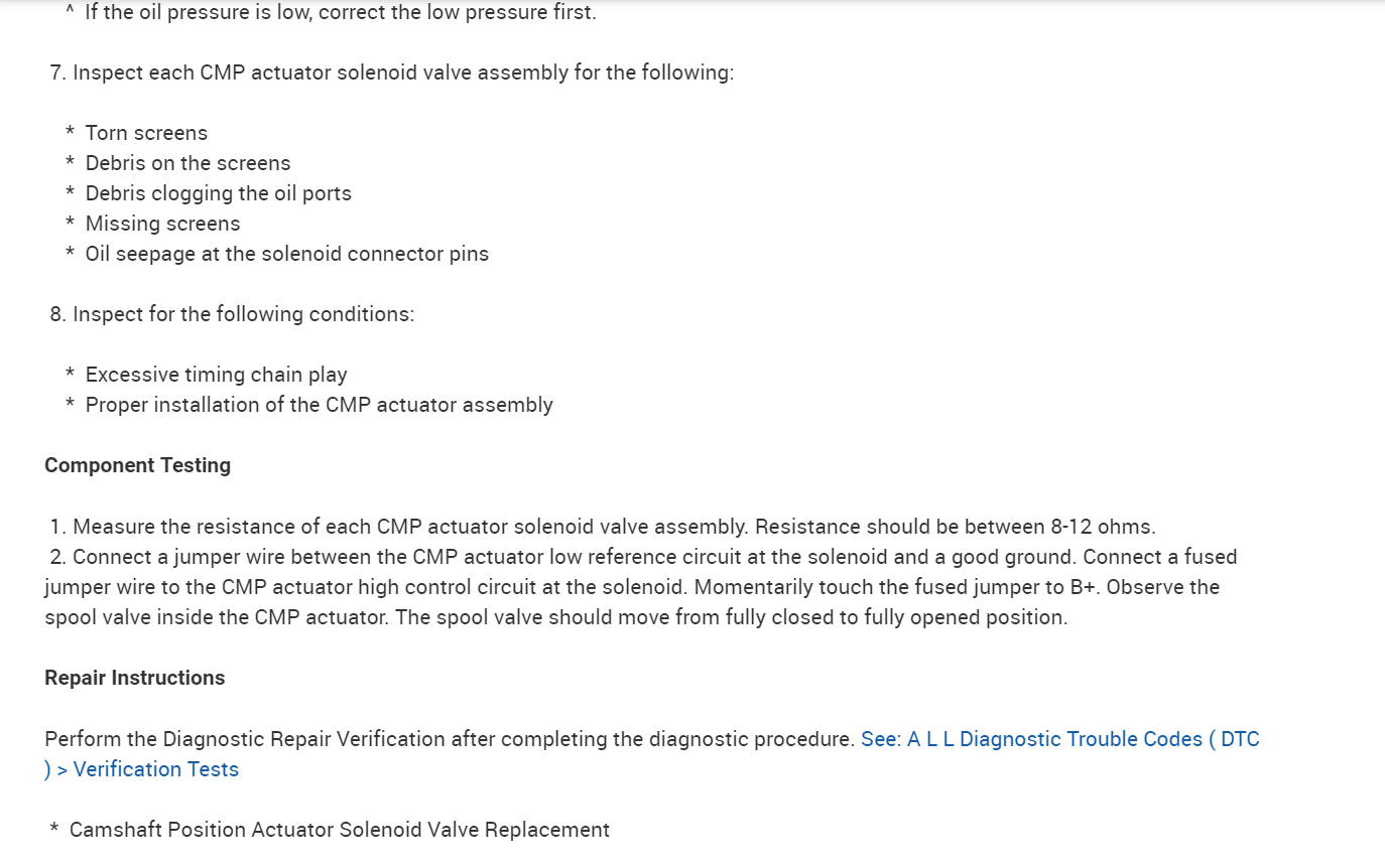

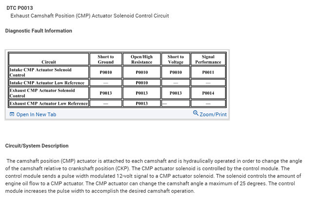

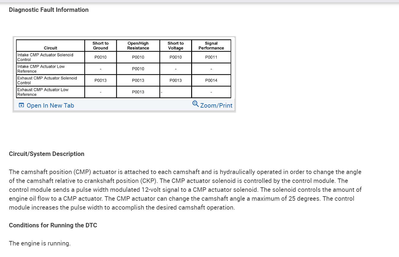

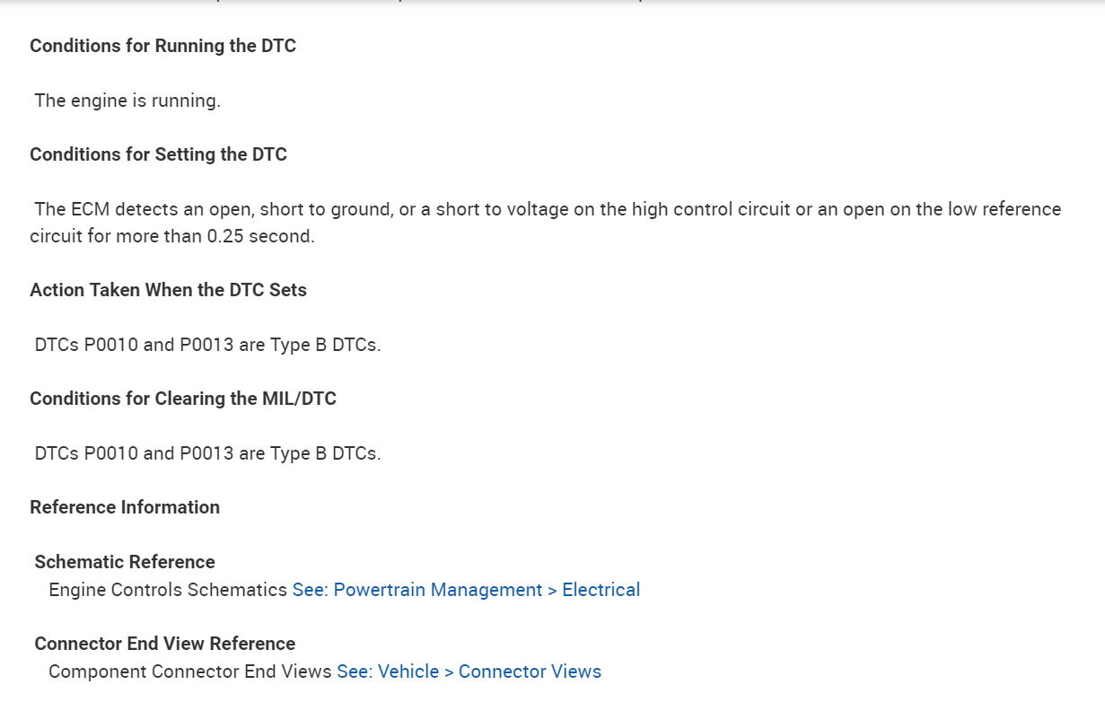

This is probably an open circuit in your Camshaft Position Sensor Actuator (CMP) Actuator. To fix this problem you will probably have to replace it. If you clear the codes and did not fix the original problem, then the Direct Trouble Codes (DTC)(s) will reset. Some DTC(s) are one drive cycle DTC's and some are two drive cycle (DTC)(s). In the diagrams down below I have given you the factory troubleshooting guide for both DTC's. Refer to them to see if these are one drive cycle or two drive cycle DTC's.
Please go through these guides and get back to us with what you find out.
