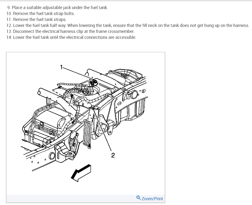

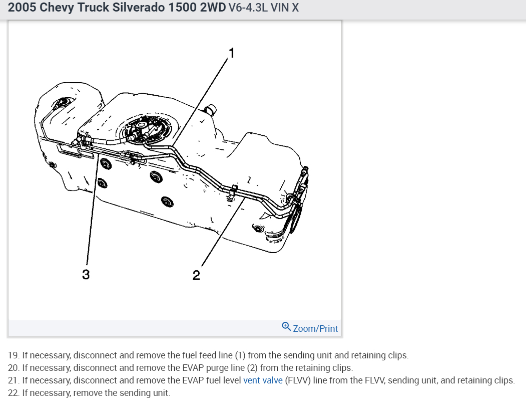

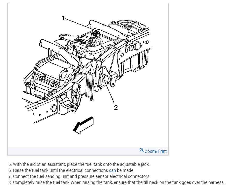

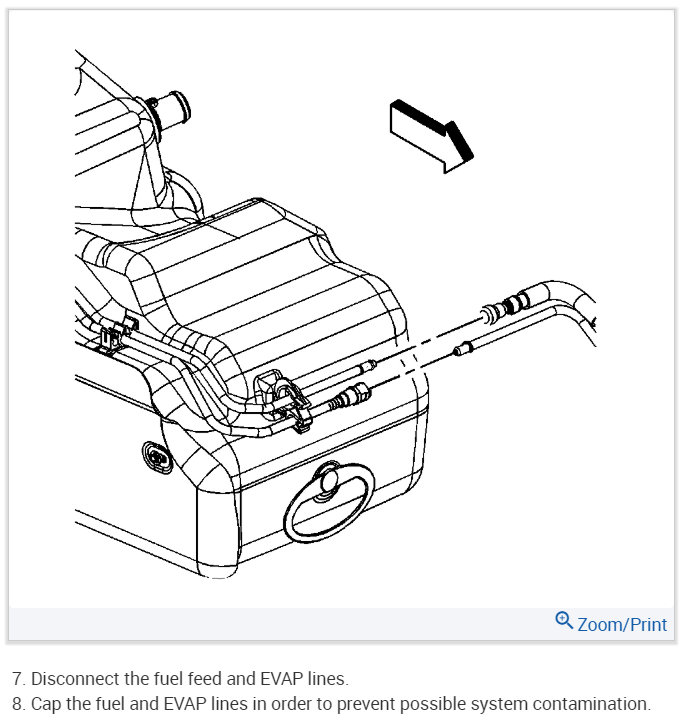

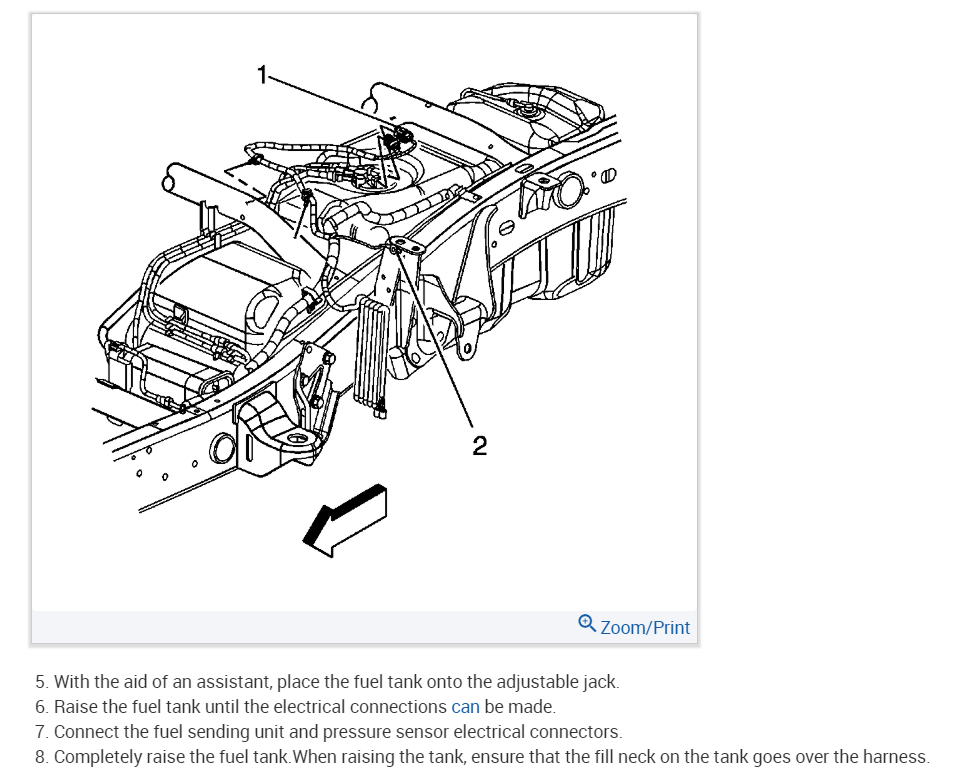

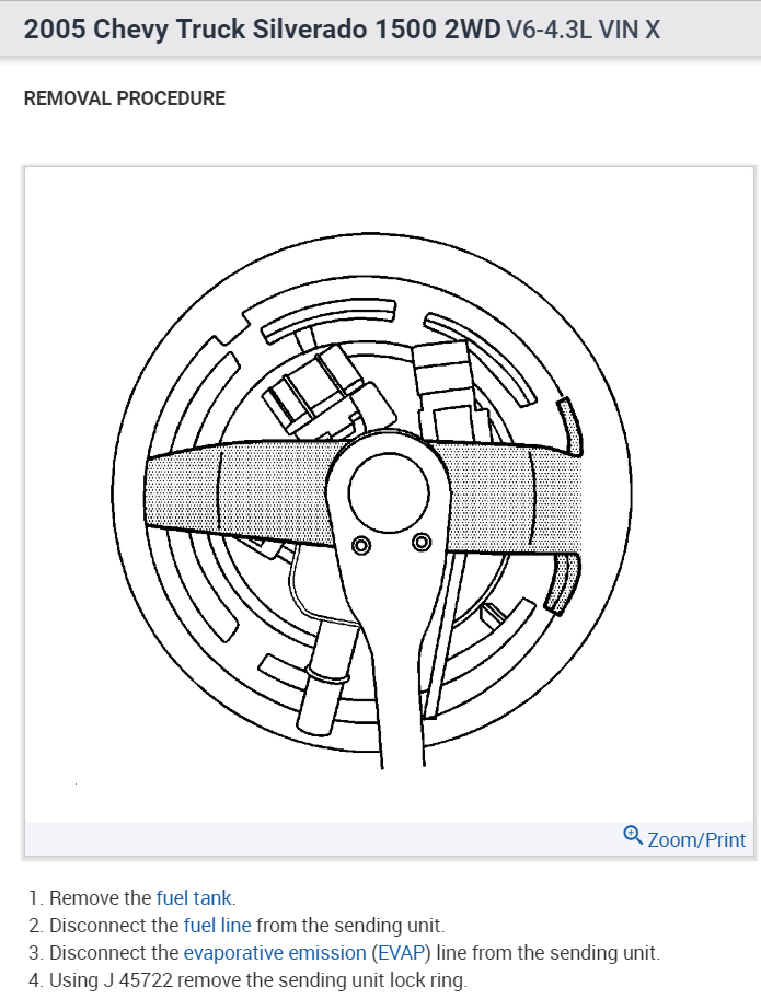

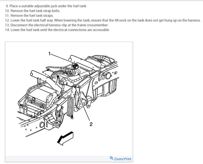

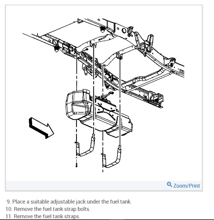

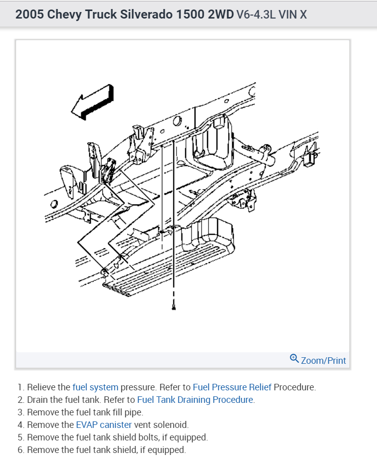

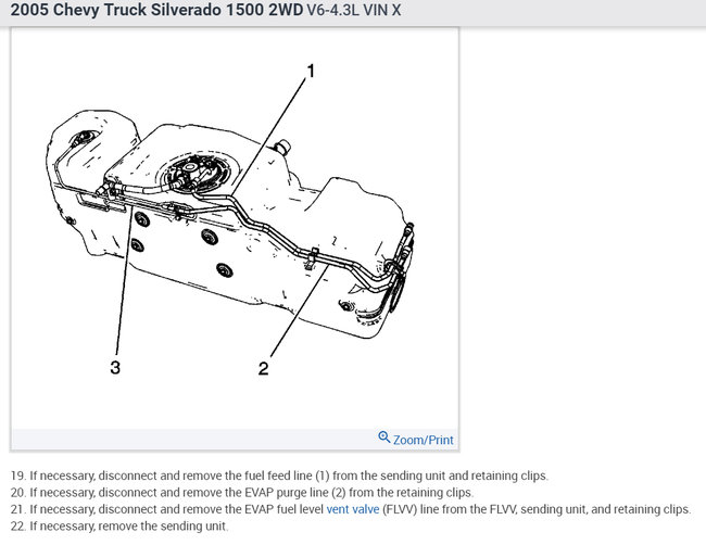

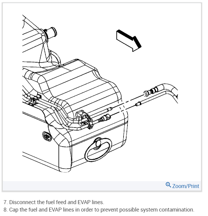

We should check for codes, but it sounds like the fuel pump is going out. After is has stalled out when you turn the key to the on position without cranking the engine over can you hear the fuel pump run in the tank for 5 seconds? Here are a couple of guides and the fuel pump replaced instructions in the diagrams below:
and
