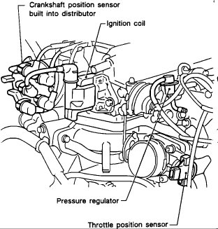

Trying to find the camshaft senor.
Jun 10, 2018 at 6:09 PM
This engine does not have a camshaft sensor. They were not used on the Sentra until 1994 with the 1.6L engines. If you are referring to the crankshaft position sensor, I have attached a picture of its location.
I hope this helps.
