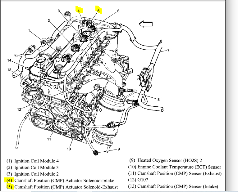

On an inline 4-cylinder engine, there is only one bank, so don't worry about that. However, there are two different camshaft position sensors. One is for the exhaust cam and one is for the intake cam. See pic below
Have you confirmed which one needs to be replaced? If you are not sure, let me know what code you have so I can make that determination for you.

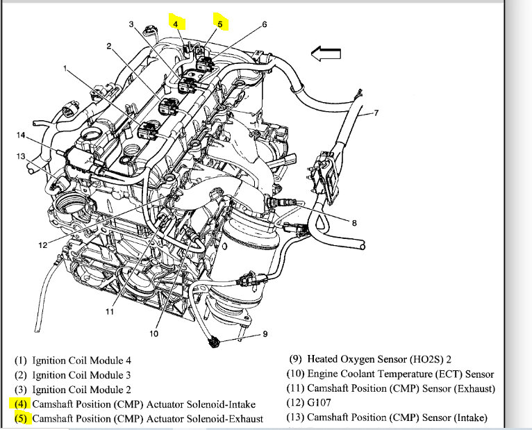

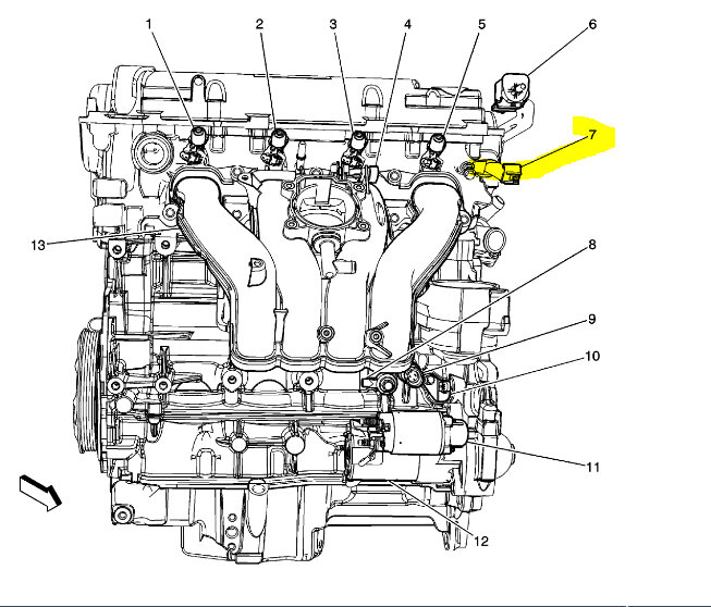

The two codes are not related. The P0341 is related to the intake camshaft position sensor.
DTC P0341
- Intake Camshaft Position (CMP) Sensor Performance
DTC P0502
- Vehicle Speed Sensor (VSS) Circuit Low Voltage
I attached a pic below of the intake camshaft position sensor location. Let me know if this helps.
See pics below.
May 30, 2023 at 9:20 PM
AZDANNO04
  • 343 POSTS
Yep, on the diagram #7 is what I replaced. But what are the relearn procedures for the crankshaft positioning and camshaft position sensor procedures?

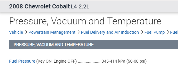

Have you checked the fuel pressure? If you are not hearing the pump, that may be the issue. Also, if you have carb cleaner or starting fluid, it would work much better than WD40. I'm not sure if WD40 would work, but anything is possible.
Here is a link that explains how to test fuel pressure:
You will need a pressure gauge, but most parts stores will lend one to you. Also, I attached the manufacturer's pressure specifications below for you.
Try this and let me know the results.
