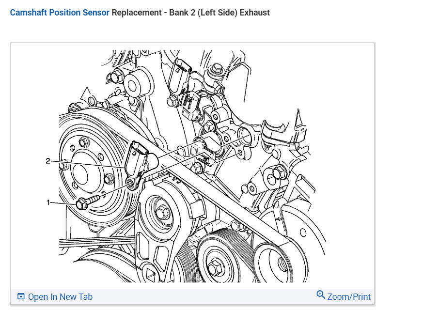

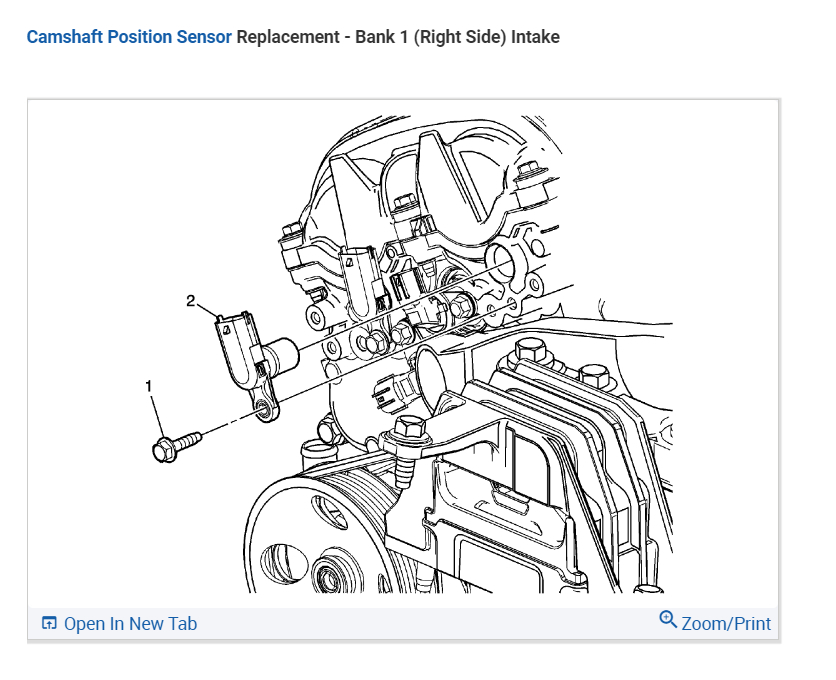

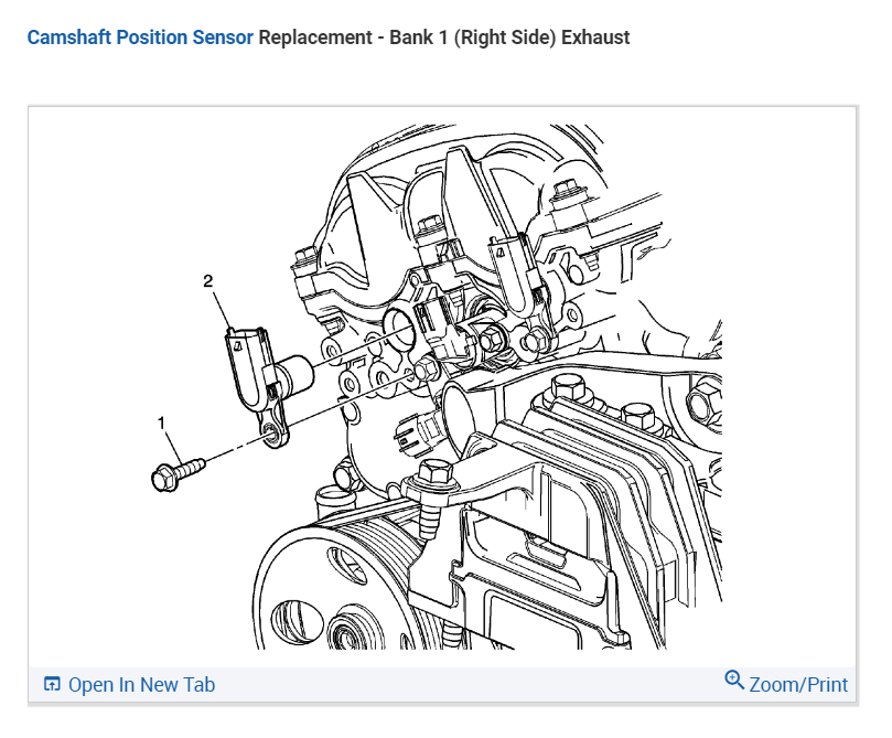

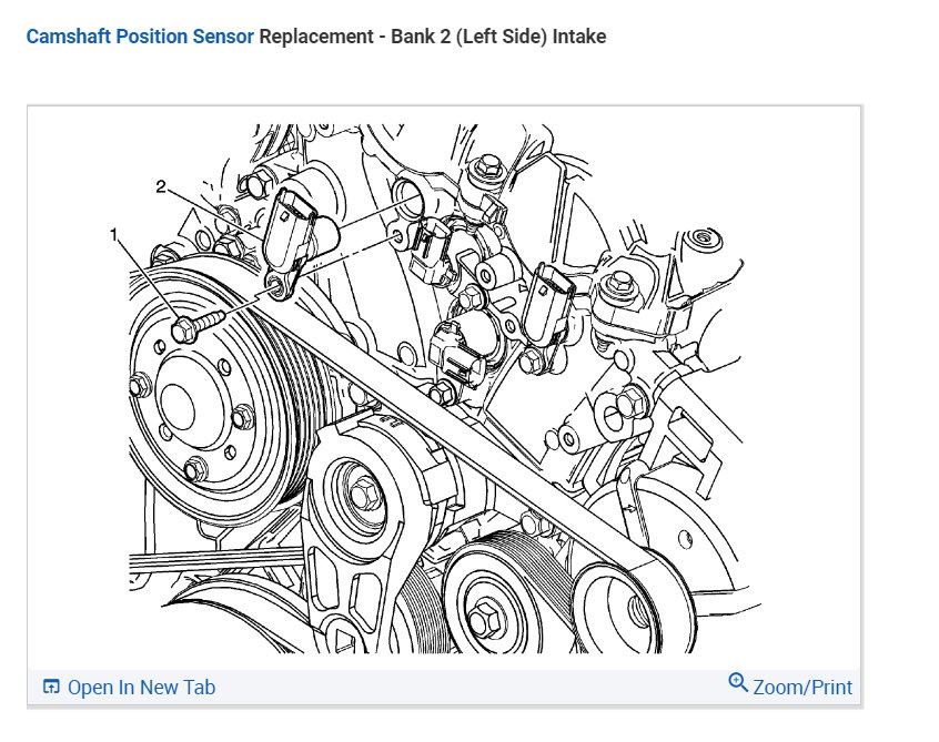

If you are facing the engine the bank one will be to your left, the intake camshaft sensors are toward the middle of the engine while the exhaust sensors are at the outside of the engine. here are diagrams below to show you exactly where the camshaft position sensors are. Check out the diagrams (below). Please let us know if you need anything else to get the problem fixed.

No problem, the intake sensor is on the inside of the cylinder head, closest to the intake manifold. Can you please leave us a rating? (Copy entire link)
