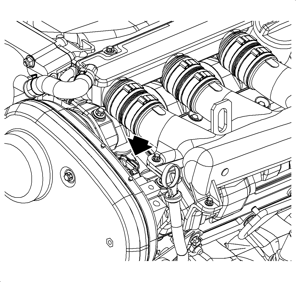

There is one. Here are the directions for replacing it. The attached pic both correlates with the directions and shows the location of the sensor.

pic 1
1. Turn the ignition OFF.
2. Disconnect the camshaft position (CMP) sensor harness connector.
3. Remove the knock sensor 2 pigtail from the attachment clip.
4. Remove the CMP sensor attachment bolt and remove the sensor.
INSTALLATION PROCEDURE
pic 2
1. Install the knock sensor 2 pigtail clip to the CMP sensor if installing the new sensor.
NOTE: Refer to Fastener Notice in Service Precautions.
2. Install the CMP sensor by gently pushing into place and install the attachment bolt.
Tighten the camshaft position sensor bolt to 8 N.m (71 lb in).
3. Insert the knock sensor 2 pigtail to the clip.
4. Connect the CMP sensor harness connector. Push the connector in until the lock position is felt, then pull back to confirm engagement.
