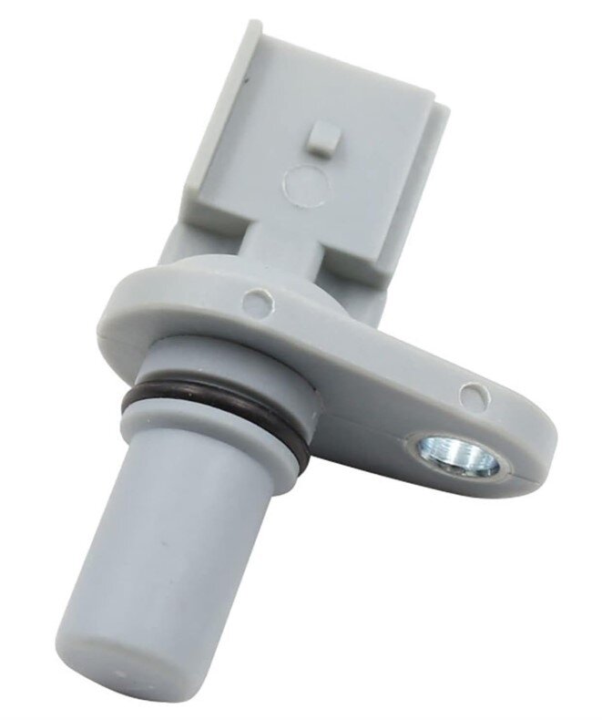

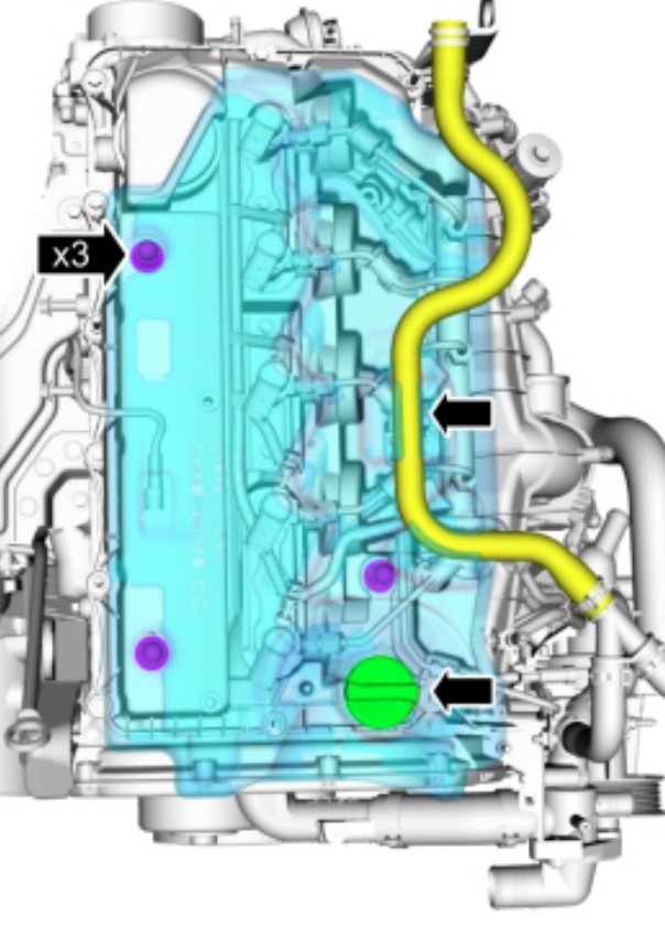

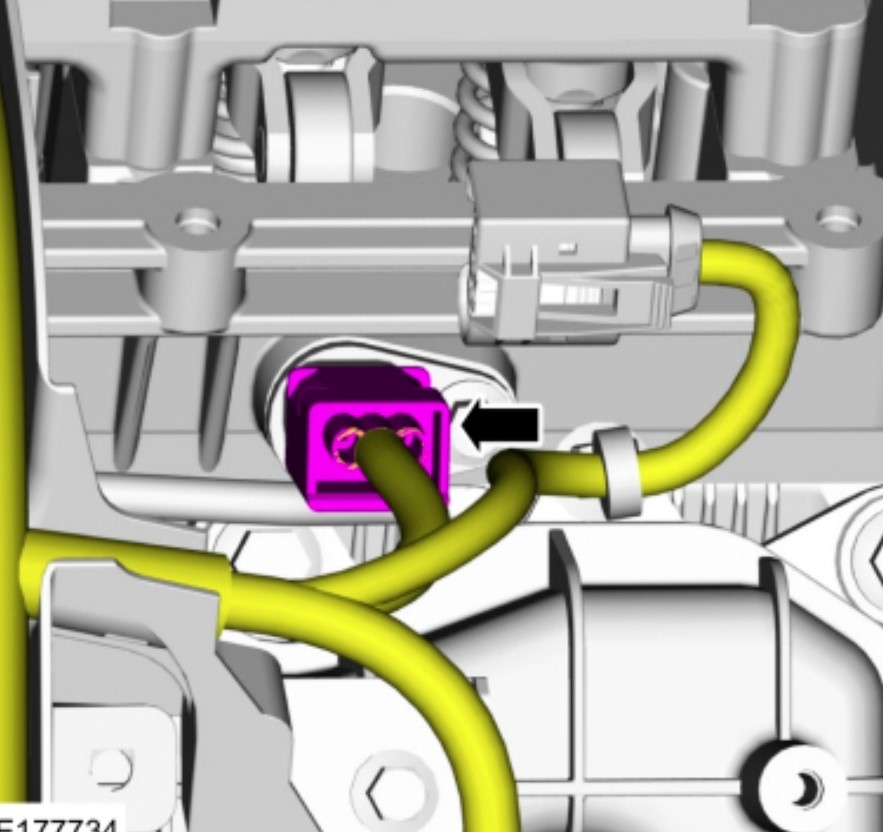

It is under the trim cover on top of the engine. Remove the cover and the cam sensor is right there on top. Remove the connector and then the bolt. Now gently twist and pull it out of the head. Put some oil on the new one and slide it into the hole, tighten the bolt to 6 ft lb.
Reconnect the connector and put the cover back on.
