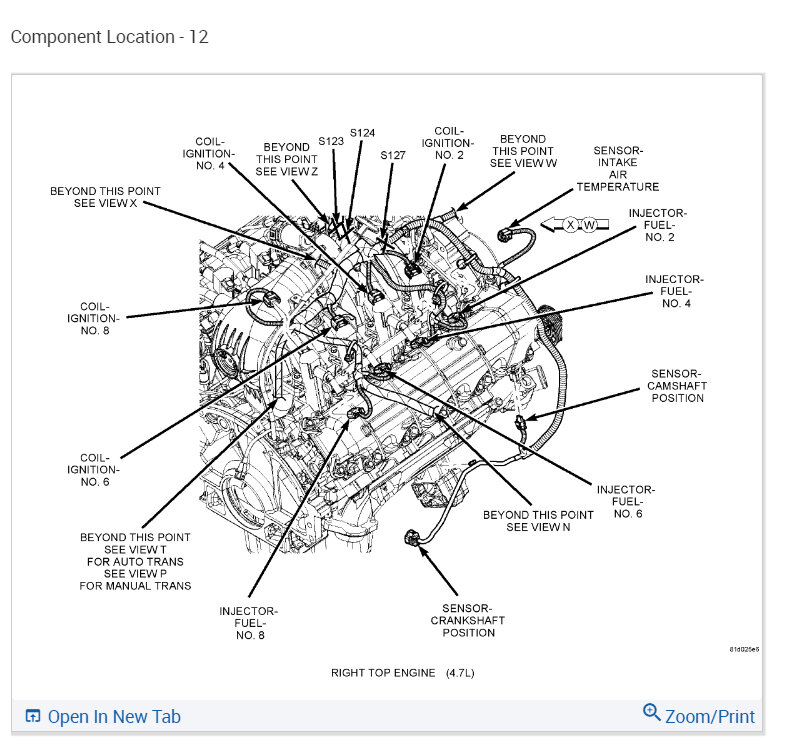

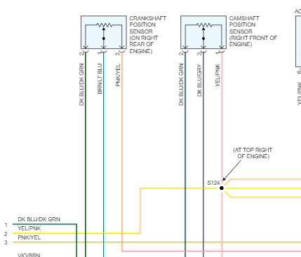

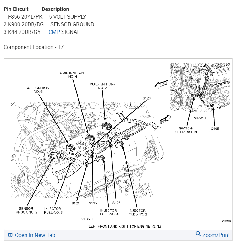

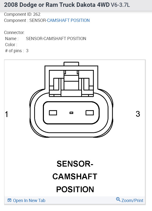

Trying to rewire my camshaft position sensor I was wondering what are the color of the wires to the connector and what position they go to on the pins.
Sep 12, 2023 at 8:48 PM
Engine size? Here is the information for the 3.6 liter v6. Check out the images (below). Please let us know if you need anything else to get the problem fixed.
