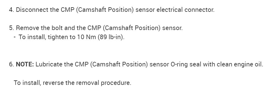

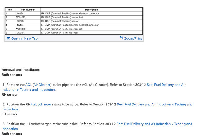

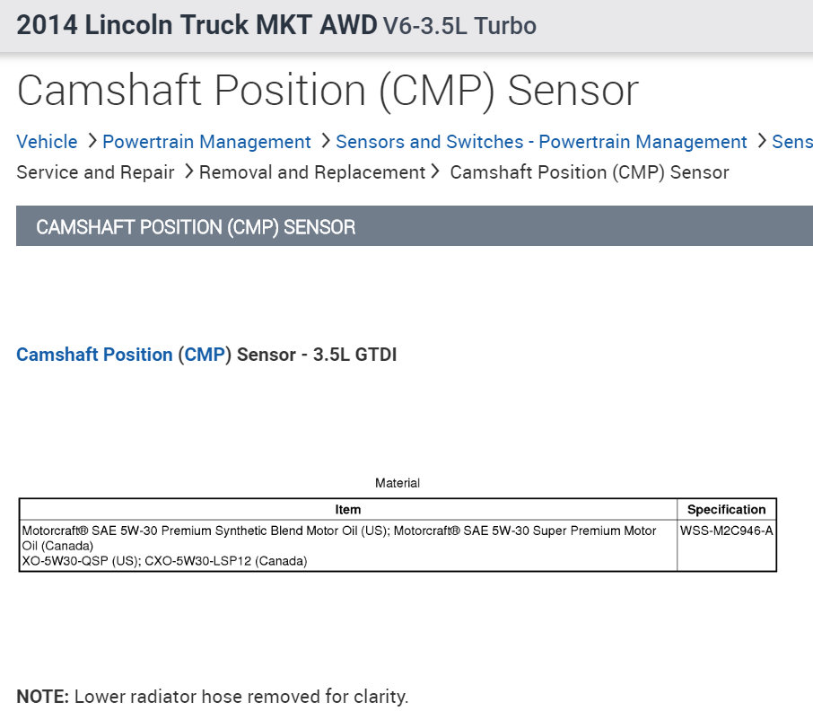

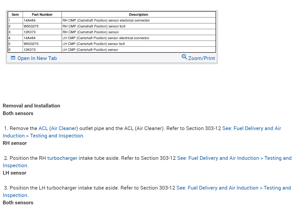

I have included both a diagram and removal and installation instructions for your vehicles Camshaft Position Sensors(CMP) in the diagrams down below. I hope this helps, and let us know if there is anything else we can do for you.

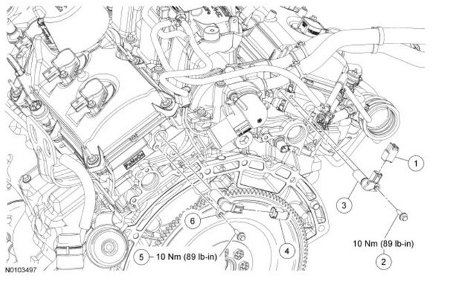

Hello again,

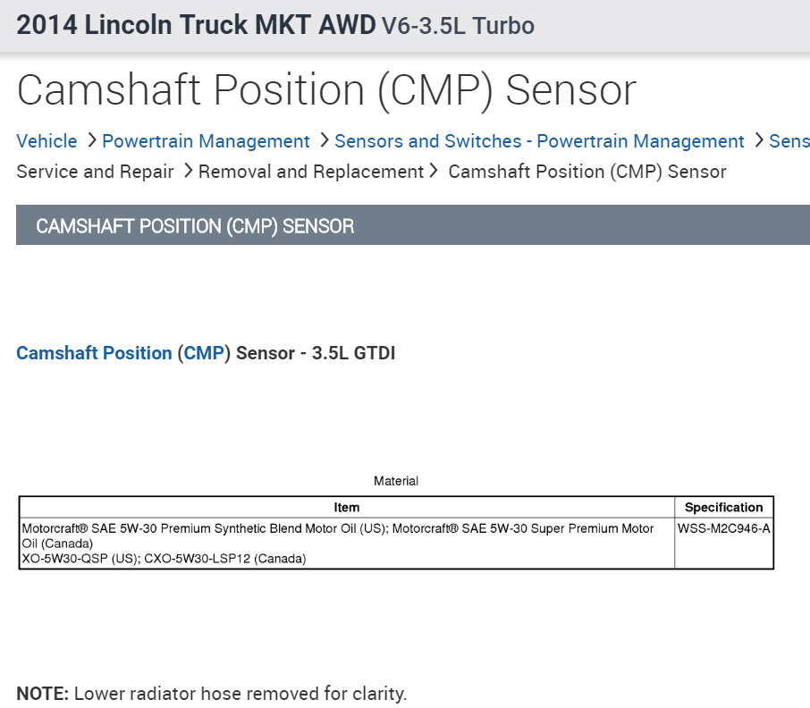

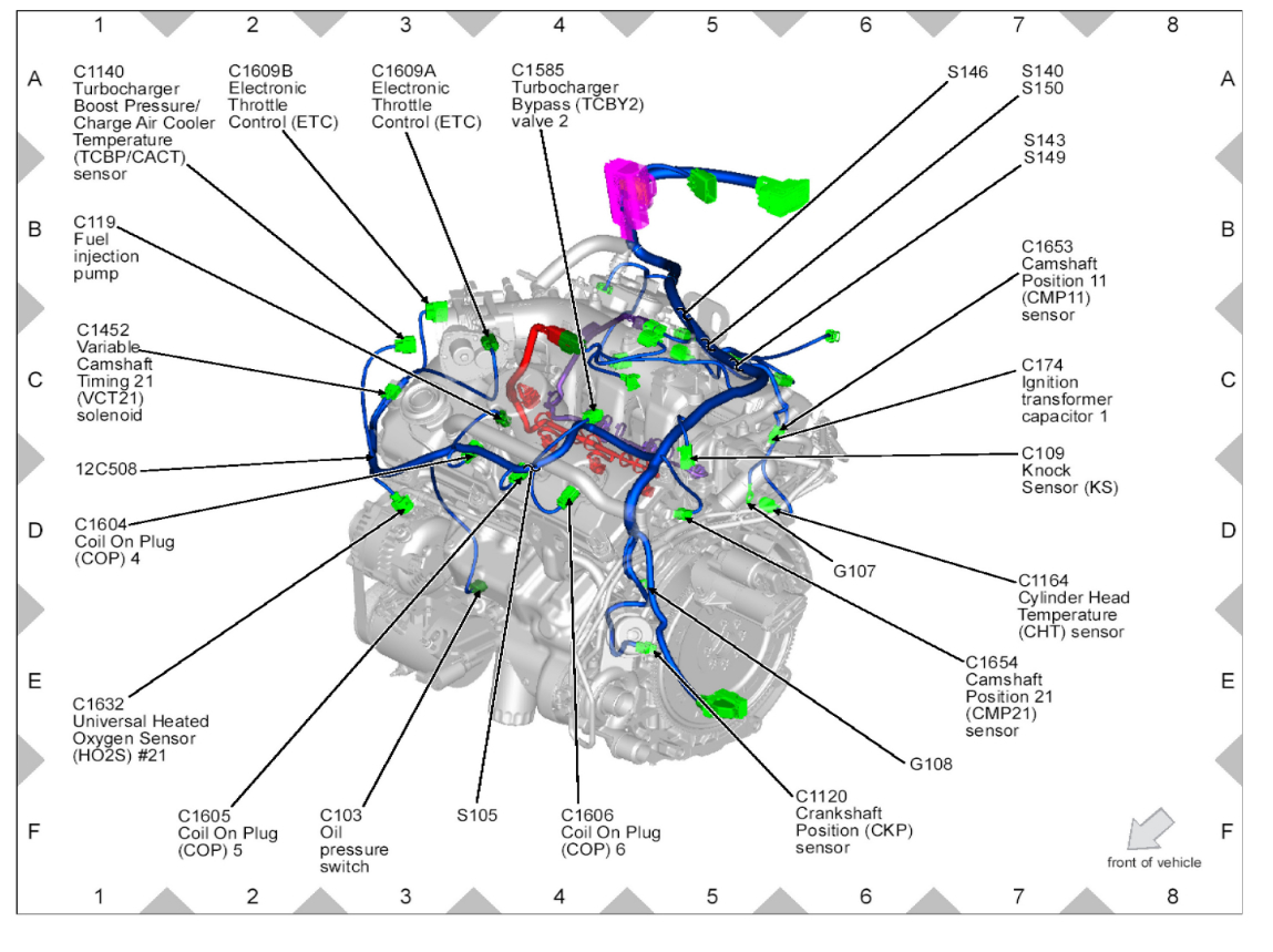

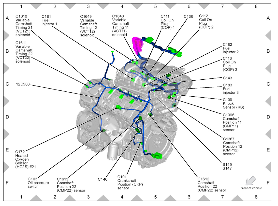

I have included the camshaft position sensor locations in the diagrams below. I hope this helps.

These images together show even more camshaft position sensors, now 4 instead of 2. And none correspond to the reading I provided. I'm more confused than ever.

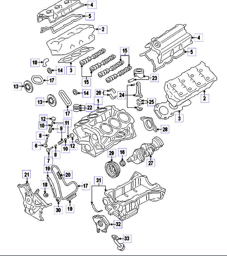

Hello again,
There are four camshaft position sensor. Your engine is a Dual Overhead Cam (DOHC) 24 Valve engine (4 valves per cylinder. In this arrangement you a have two cylinder banks, each cylinder has two intake valves(1 camshaft) and two exhaust valves(1 camshaft). Camshaft 1,1 would be bank 1(Intake), camshaft 1,2 would be bank 1(exhaust). Bank 2 would be 2,1 and 2,2 respectively. I have included an exploded engine diagram to help illustrate in the diagrams below.

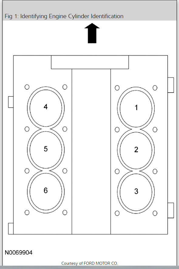

I guess I'm not making myself clear. Comments are very frustrating since no immediate feedback to each other orally and in the sense that no diagram and no cross reference so far indicates which side of the engine is bank 1 , i.e, camshaft 1. Once I have a point of reference, your previous comments should help me identify which specific sensor is causing the bad reading. It is my understanding that cylinder #1 is on bank 1. As I sit in the driver's seat, is MY left side Bank 1? I am speculating that cylinder #1 is closest to the fan blade and on the right side and that would also be in bank #1. If that is the case, then the sensor is also on the right side. Now I have to figure out which one on the right side is Sensor A. Exhaust or intake doesn't = Sensor A.
Am I correct on the location of bank#1?
If so, which of the two sensors is Sensor A using the same point of reference as I sit as the driver seat?
Feb 12, 2019 at 4:49 PM
MKT
  • 9 POSTS
oops, I meant right side as I sit in the driver's seat is where I would find bank 1.

Hello again,
Okay I have included a cylinder arrangement diagram in the diagrams below.

I have tried every way I know to ask you and you don't answer the question. Which of the two sensors on bank 1 is A? You continue to avoid that question. Don't get me wrong, I appreciate it but I asked the same question over and over and I'm very close, you never answer it. How do I identify the specific location of that sensor?
