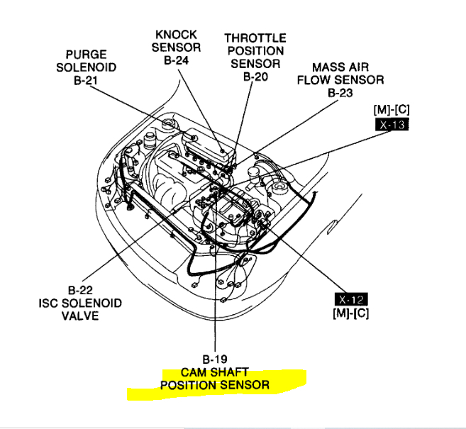

The sensor is located on the rear of the engine close to the battery. I attached a picture showing its approximate location. Sorry, it was the best one I could find.
See pic below.
