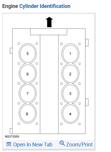

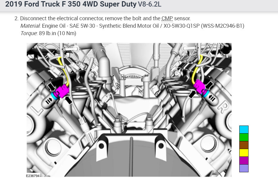

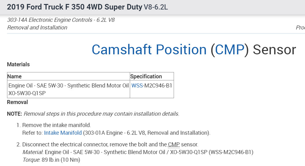

Here are the camshaft position sensor locations, sensor B is on the driver's side. Check out the images (below). Please let us know if you need anything else to get the problem fixed.
