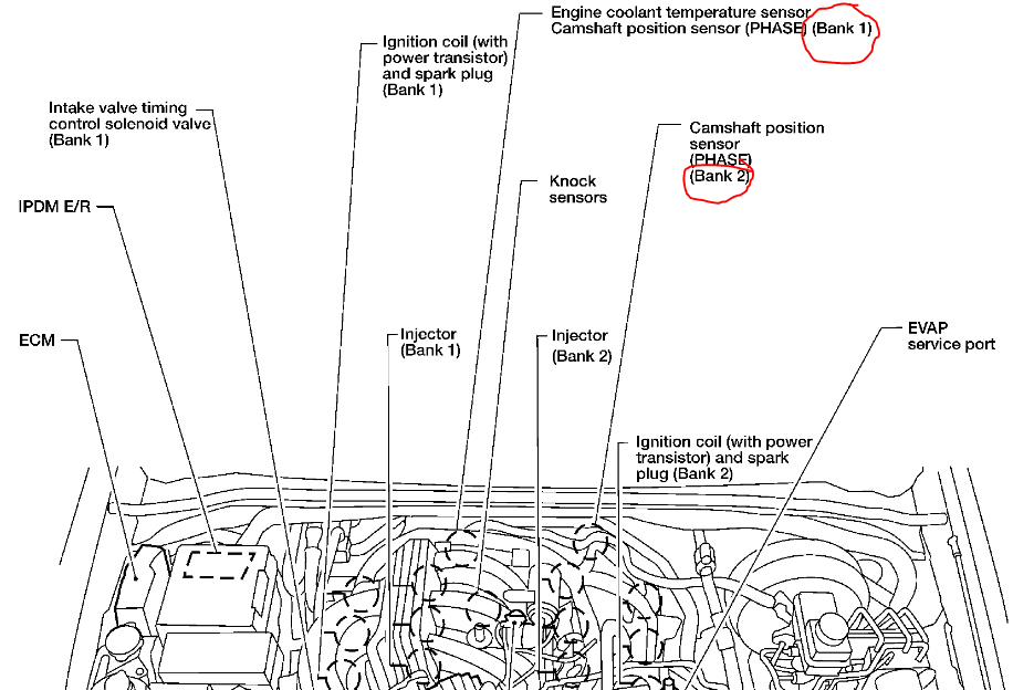

Here is a tutorial for you to view on how to change a camshaft position sensor:
https://www.2carpros.com/articles/camshaft-angle-sensor-replacement
I've attached a picture below showing its location on your vehicle.Hope this helps and thanks for usig 2CarPros.
