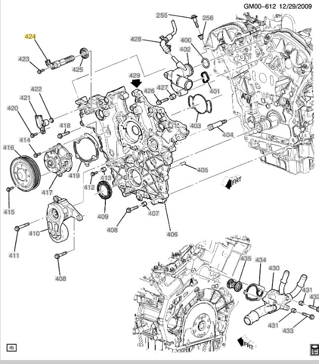

My information is telling me for the 3.6L, part number 12636175 is the part number you should use for all four.
More than likely GM just changed them all to the same part number to save production cost and reduce overall inventory. This is called a supersession and happens all the time.

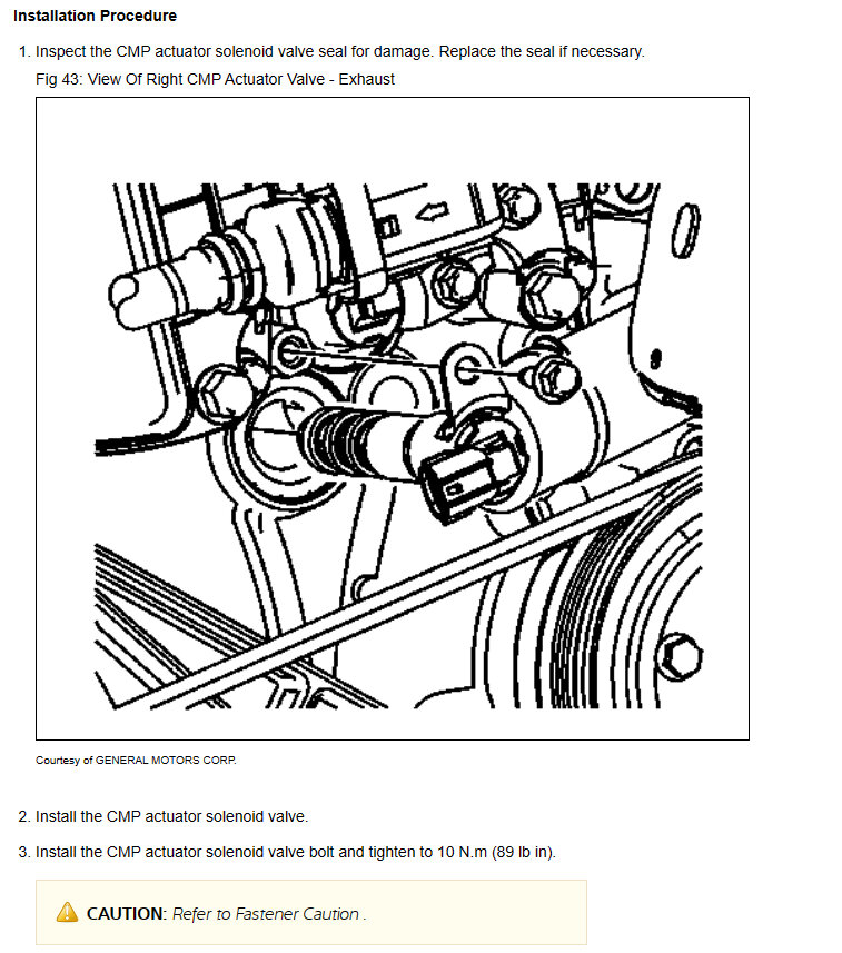

The engine RPO code or Regular Production Option is LY7. This can be found on a label either in the glove box or in the truck on the spare tire cover. I have added a picture for you of this label.

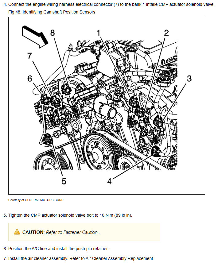

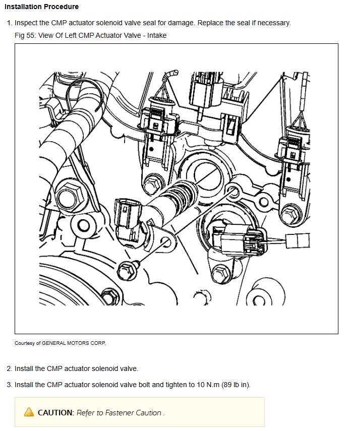

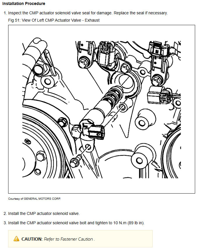

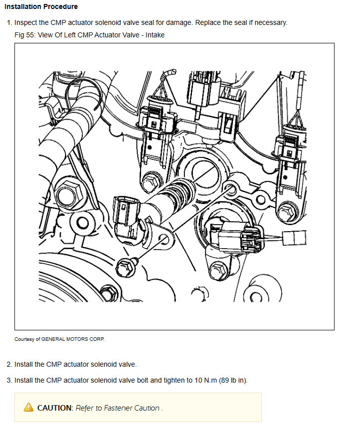

**The torque spec for these is all the same, 89 lb. in., I suggest borrowing a torque wrench or buying one to make sure they are in the correct position and won't loosen up.

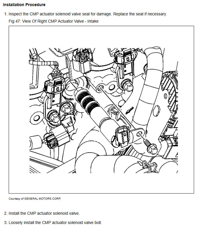

Also, use a little clean, fresh oil on the O-rings on the solenoids before installing to prevent damage to them.

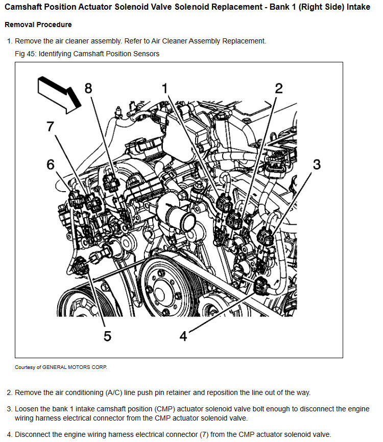

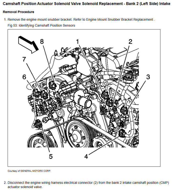

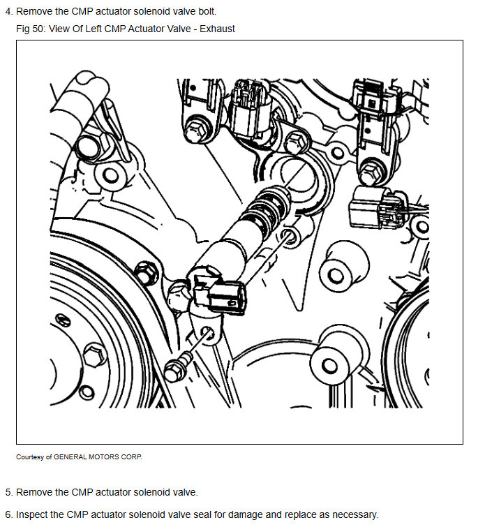

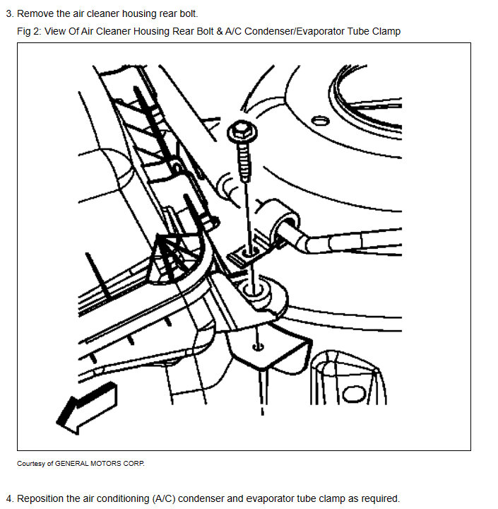

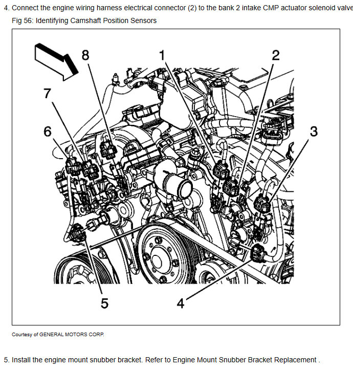

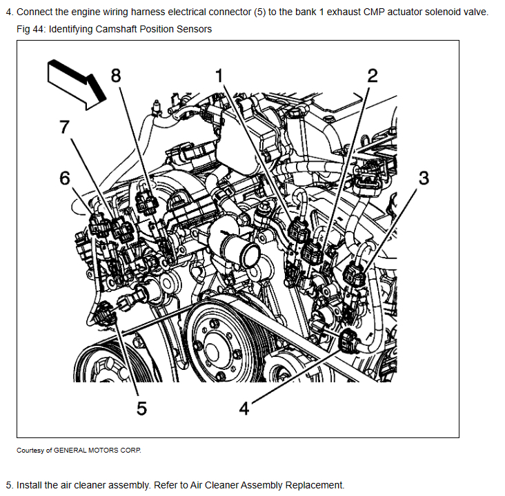

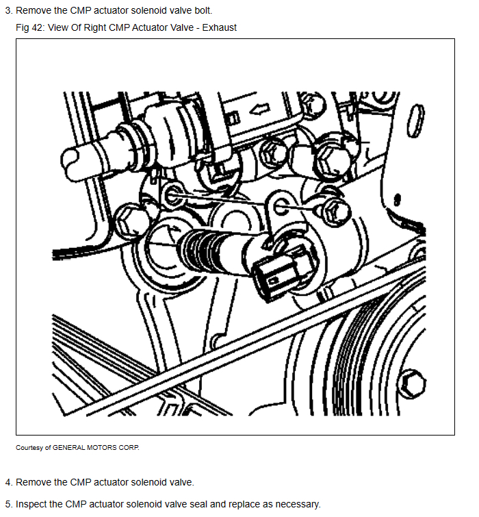

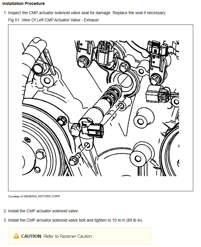

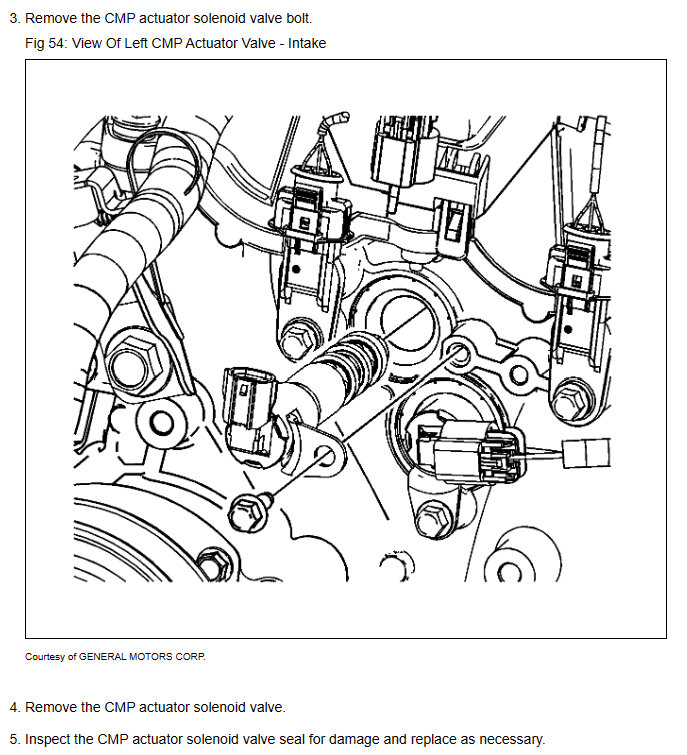

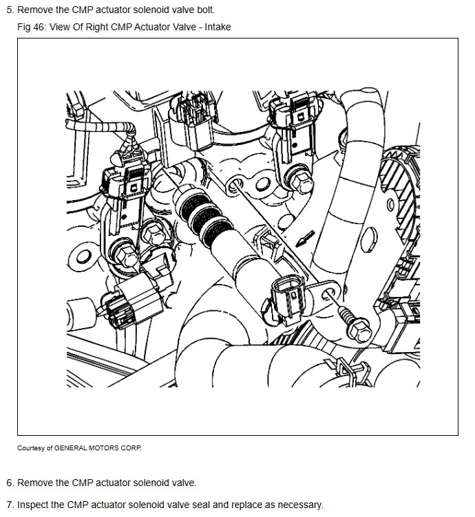

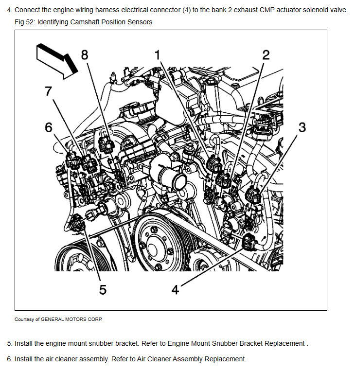

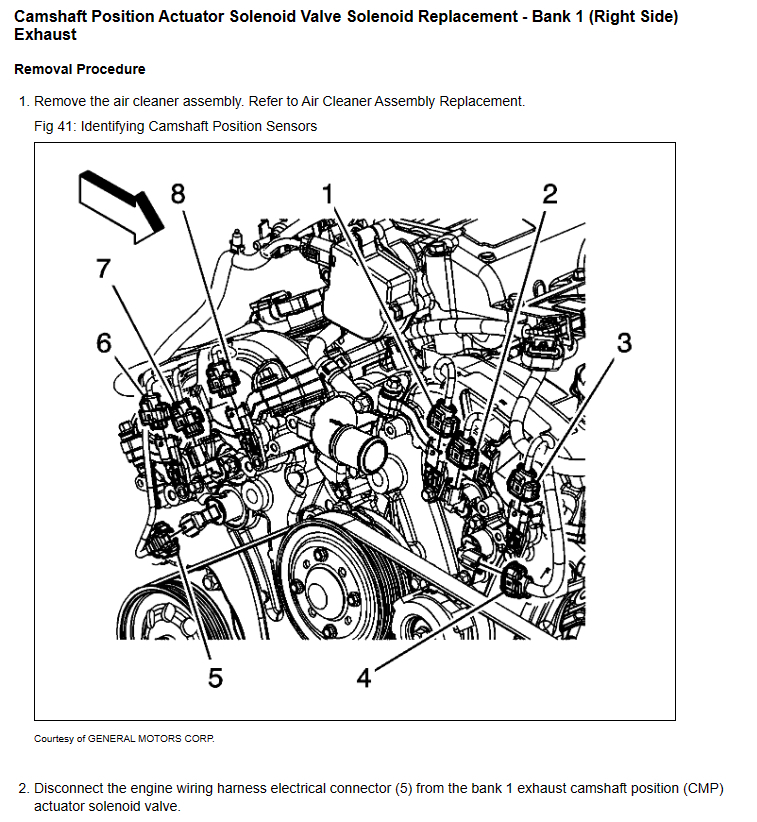

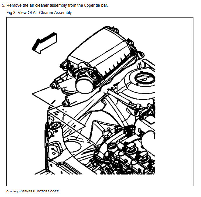

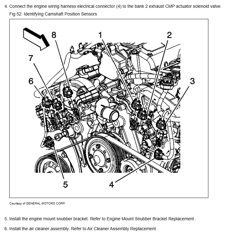

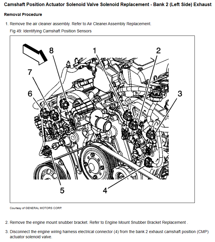

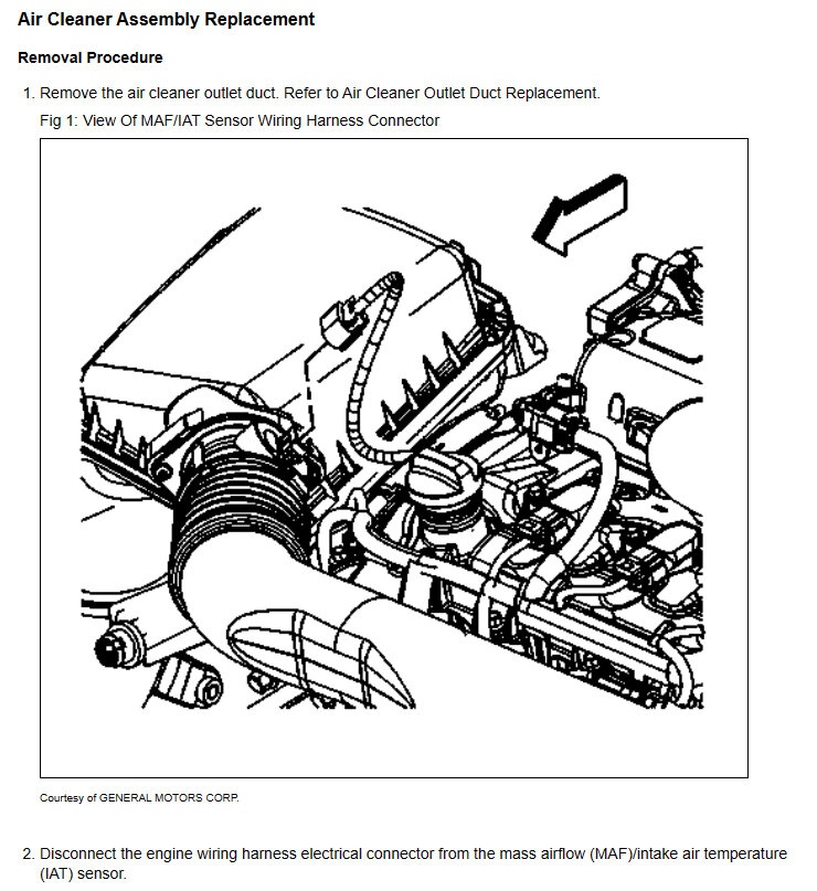

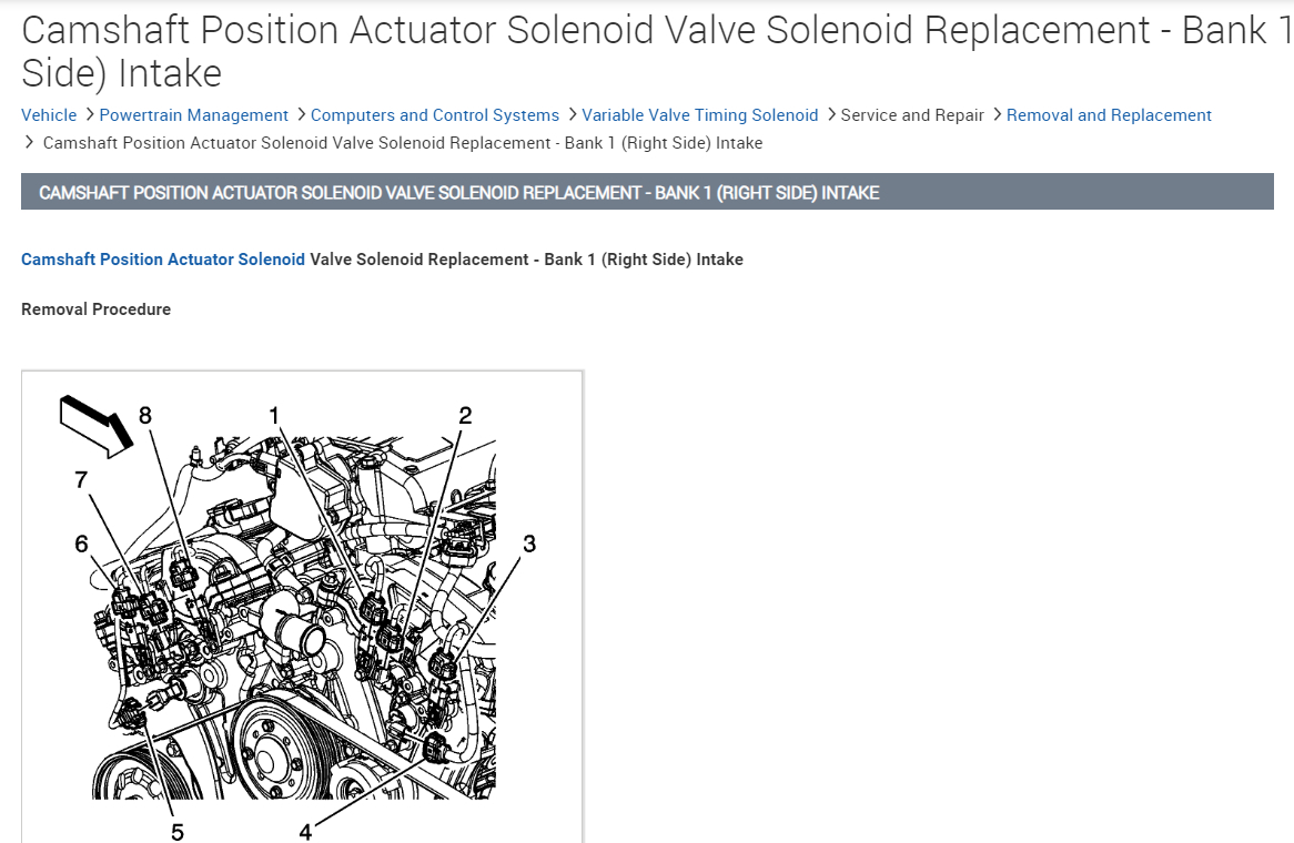

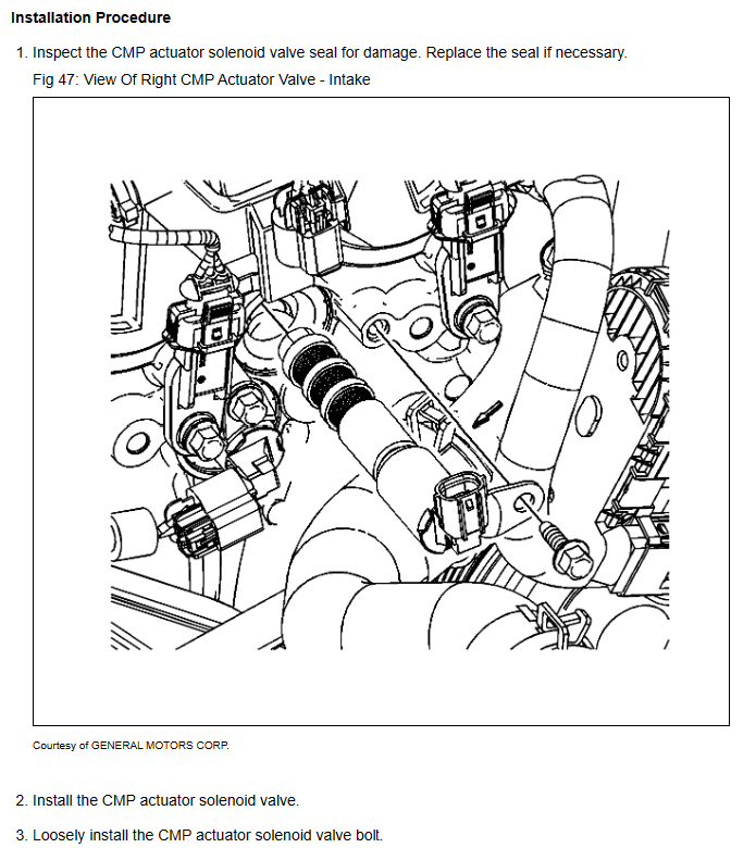

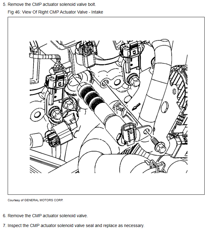

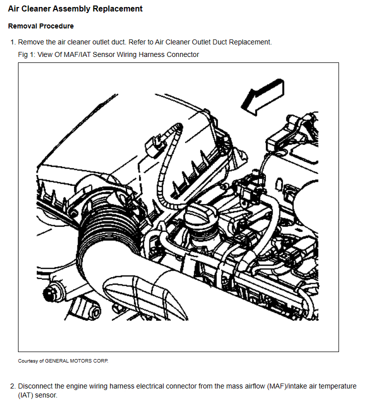

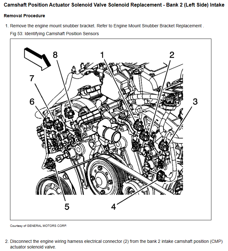

In case you need them, I have added removal and installation instructions for all four solenoids and the removal procedure for the air cleaner, so it is out of the way, so you have room to work.

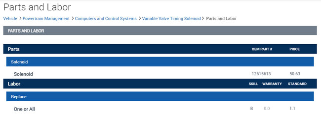

I have also added an image from the GM catalog showing the solenoid.
