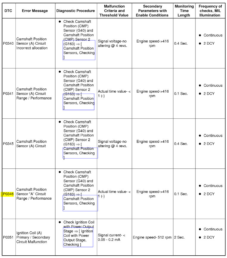

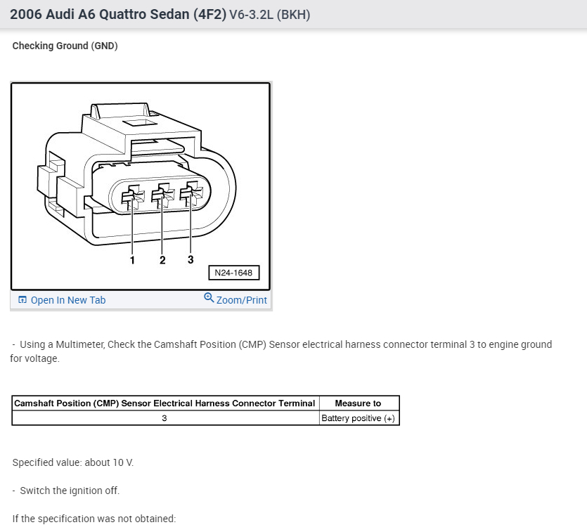

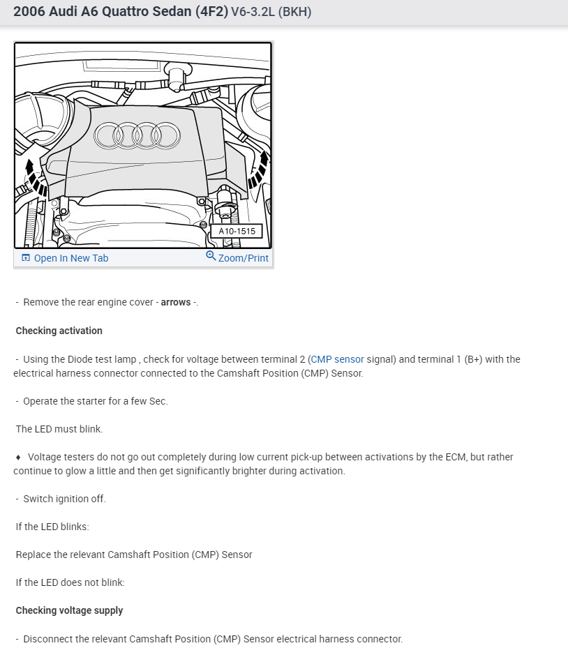

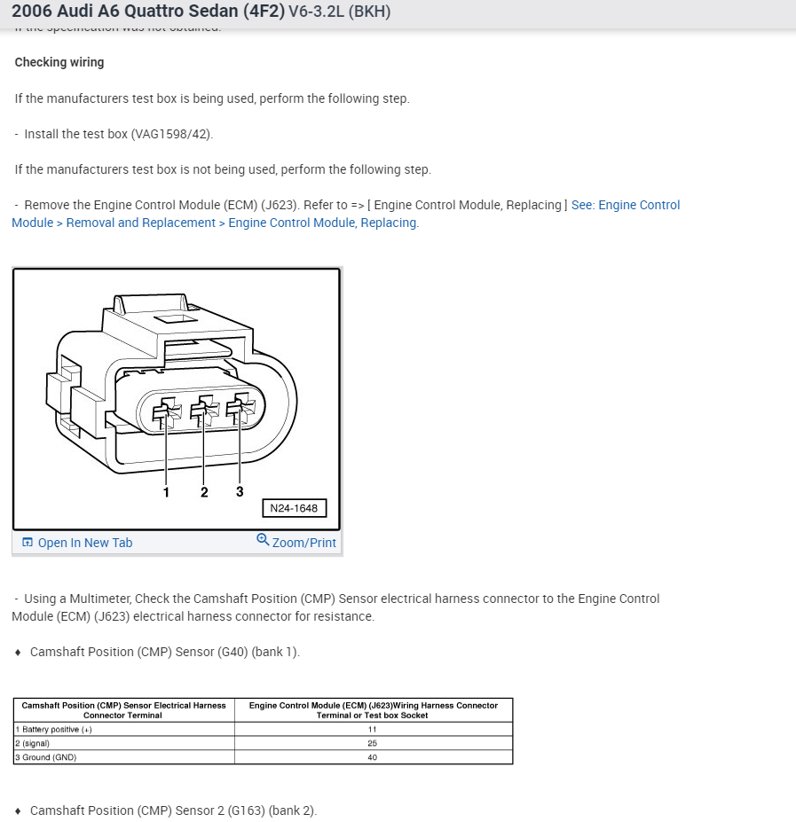

Hello, I purchased an Audi that had a bad oil leak. I took it in to get fixed, but it is still not fixed totally. However, I got the car back with the check engine light on with a code po346. I’ve never seen this code until I got the car back. I changed six sensors still the same issue. So, a friend of mine said it could be that the harness was put back wrong. I spent $2,300.00 chasing an oil leak only to cause me more with this issue.
