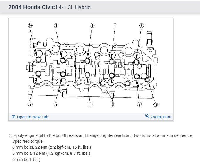

Just need the cap torque specs for the camshaft and also rocker arms. please

I attached the directions below for torquing the camshaft/rocker assembly. When you do this, make sure to follow the bolt sequence and do it in steps until you reach the required torque.
Let me know if this helps.
See pic below.
