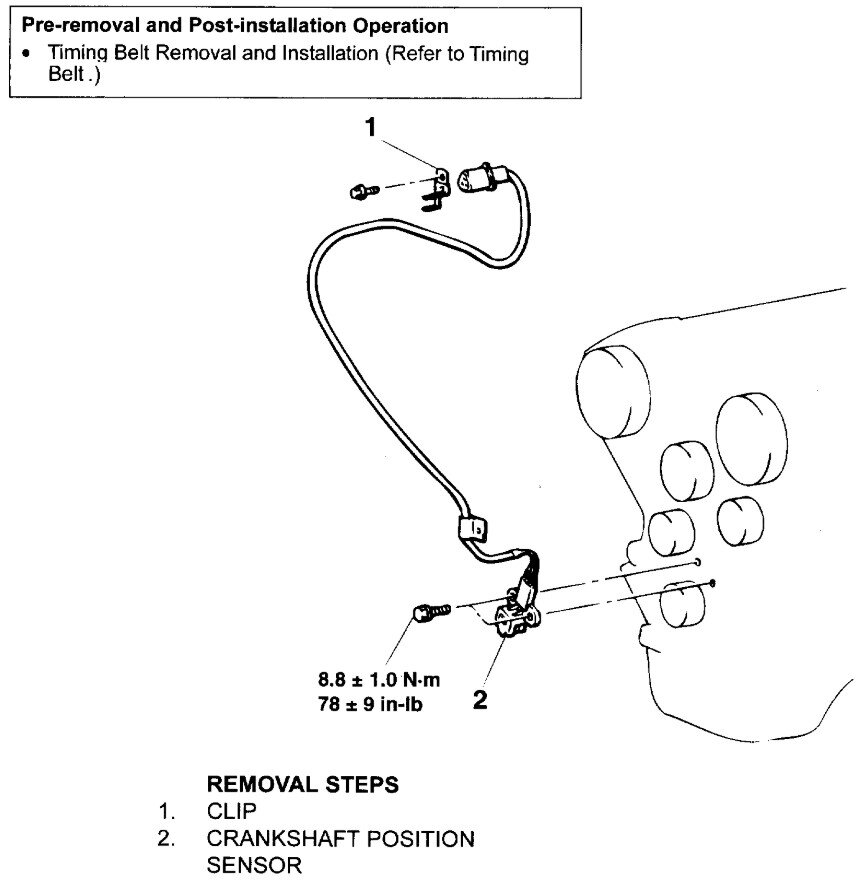

Cant locate the crankshaft and camshaft position sensors
Mar 24, 2026 at 11:57 PM
STEVE W.
  • 15,113 POSTS
The crankshaft sensor is under the timing belt cover and the belt itself has to come off to get it out. The cam sensor is inside the distributor. What seems to be the issue or code(s) you have?
