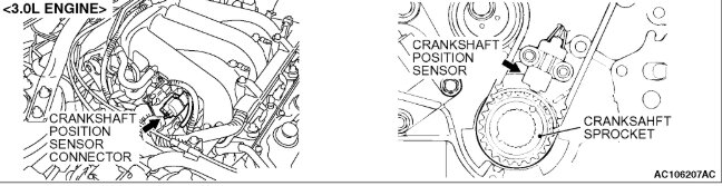

I cant locate the crankshaft and camshaft position sensors
Mar 24, 2026 at 11:52 PM
Yep, they are hidden, the crankshaft sensor is in front of the crankshaft under the timing belt cover, the camshaft sensor is under the intake manifold, here is a diagram of the locations. Check out the images (below). Please let us know what happens.
