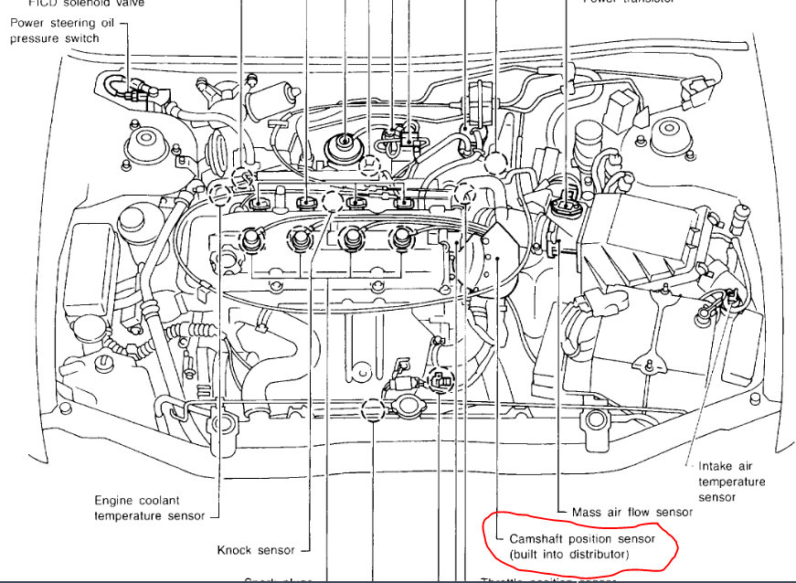

I have been trying to locate my camshaft sensor. Please help how do i change it?
Sep 20, 2019 at 5:01 PM
DANNY L
CERTIFIED EXPERT
5,648 POSTS
Hello, I'm Danny.

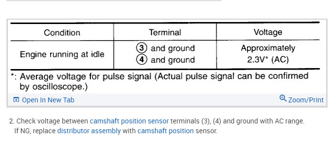

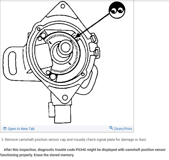

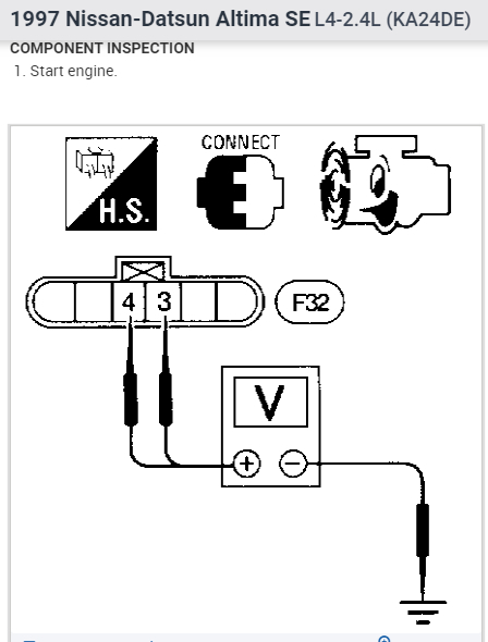

The camshaft position sensor is within the distributor assembly. Here is a basic tutorial showing what's involved for replacement:
https://www.2carpros.com/articles/camshaft-angle-sensor-replacement
I've attached pictures below showing location and steps on how to test.Hope this helps and thanks for using 2CarPros.
