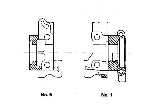

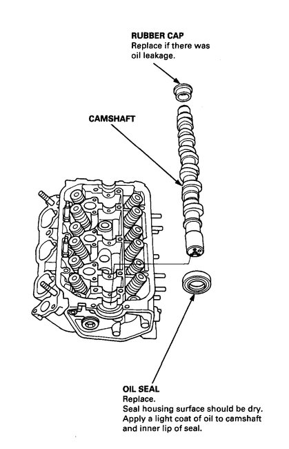

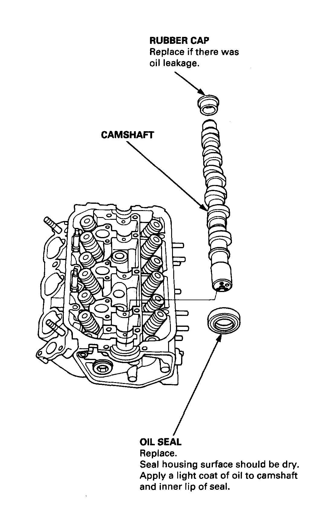

1. Install the camshaft and rubber cap, then install the camshaft seal with the open side (spring) facing in.
NOTE:
- Position the camshaft with pin hole at the top.
- Do not apply oil to the camshaft holder mating surface of the camshaft seal.
- Apply liquid gasket, Part No. 08718-0001 or 08718-0003 around the rubber cap.
pic 2

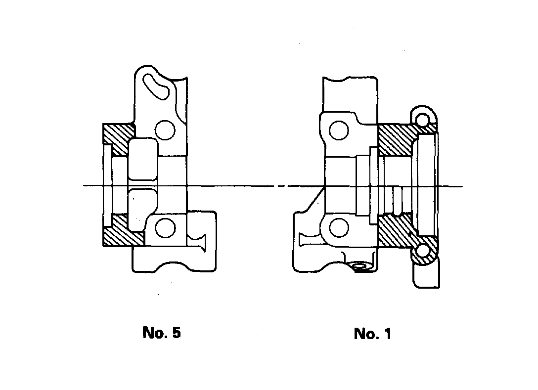

2. Apply liquid gasket to the head mating surfaces of the No. 1 and the No. 5 camshaft holders. Apply liquid gasket to the shaded areas.

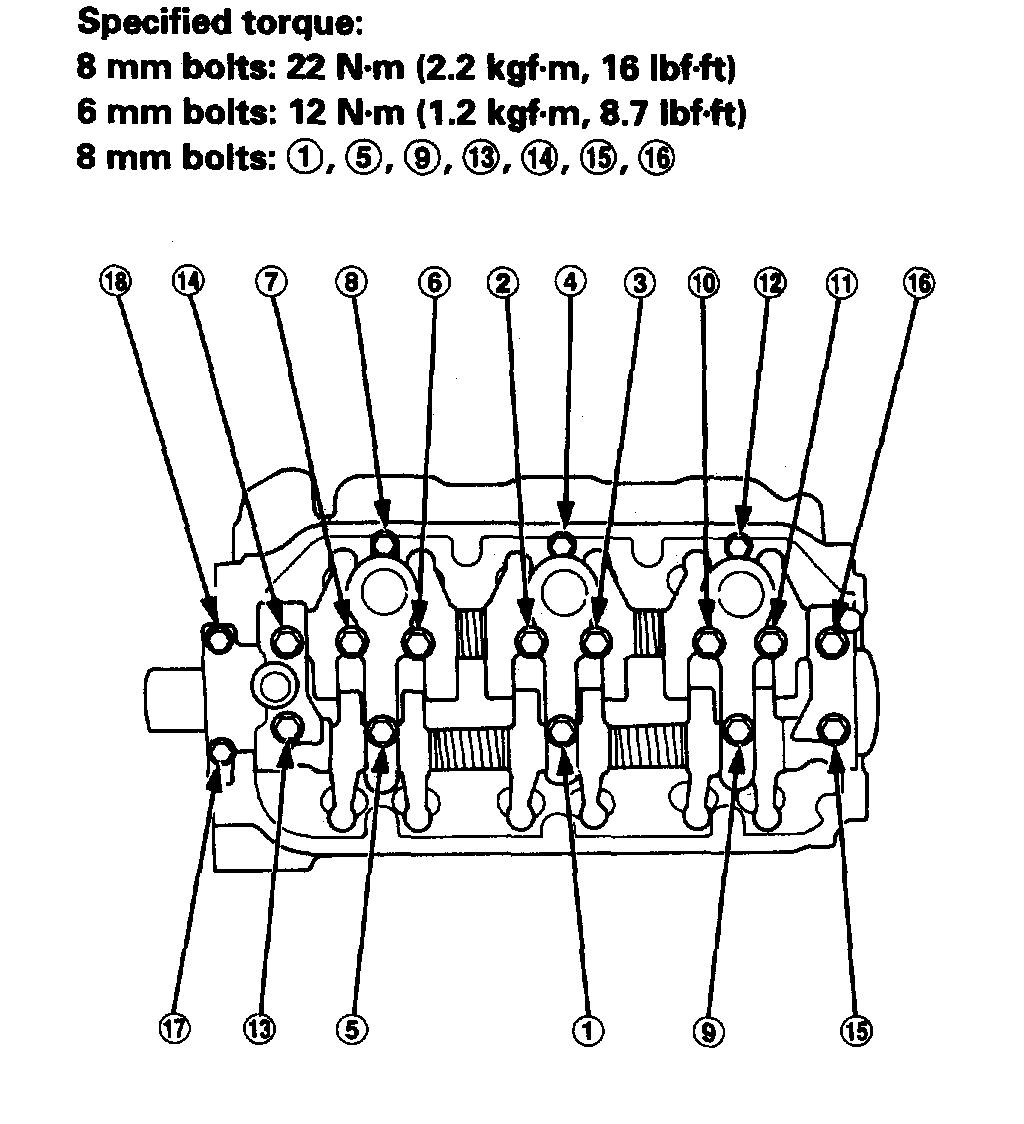

3. Tighten each bolt 2 turns at a time in the sequence to ensure that the rockers do not bind on the valves.

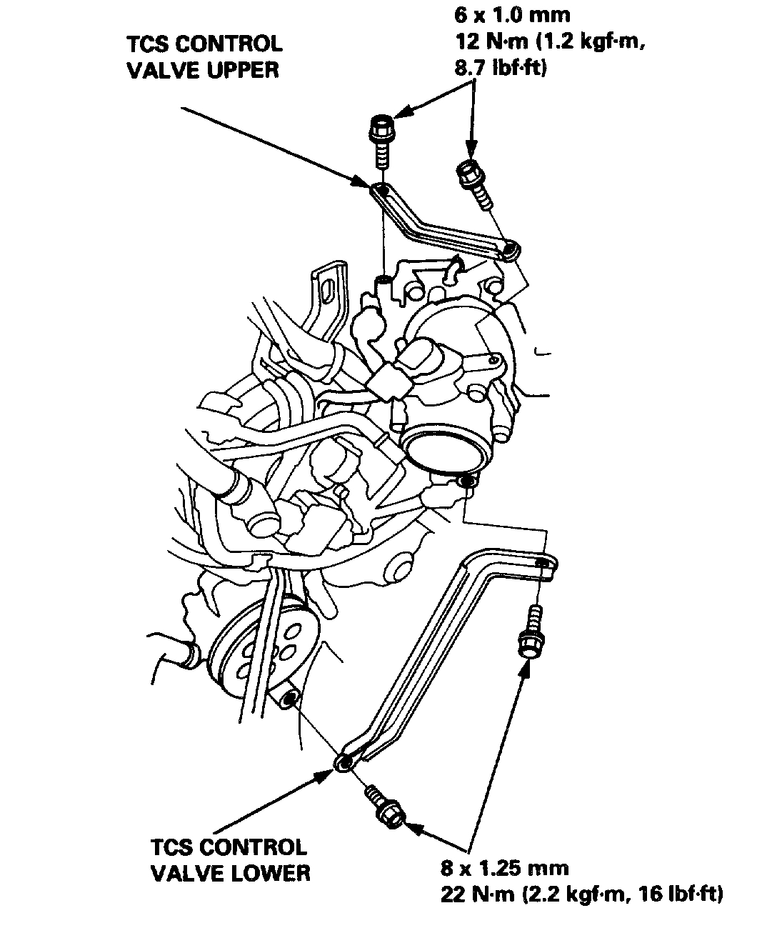

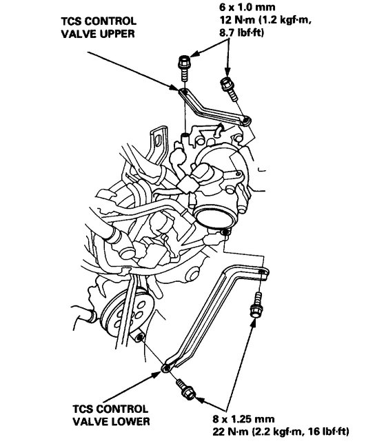

5. Remove the TCS control valve upper and lower
NOTE: Refer to Brakes when installing the brackets.

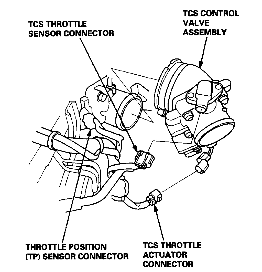

7. Disconnect the TCS throttle sensor connector, the TCS throttle actuator connector, and the throttle position (TP) sensor connector, then remove the TCS control valve assembly.

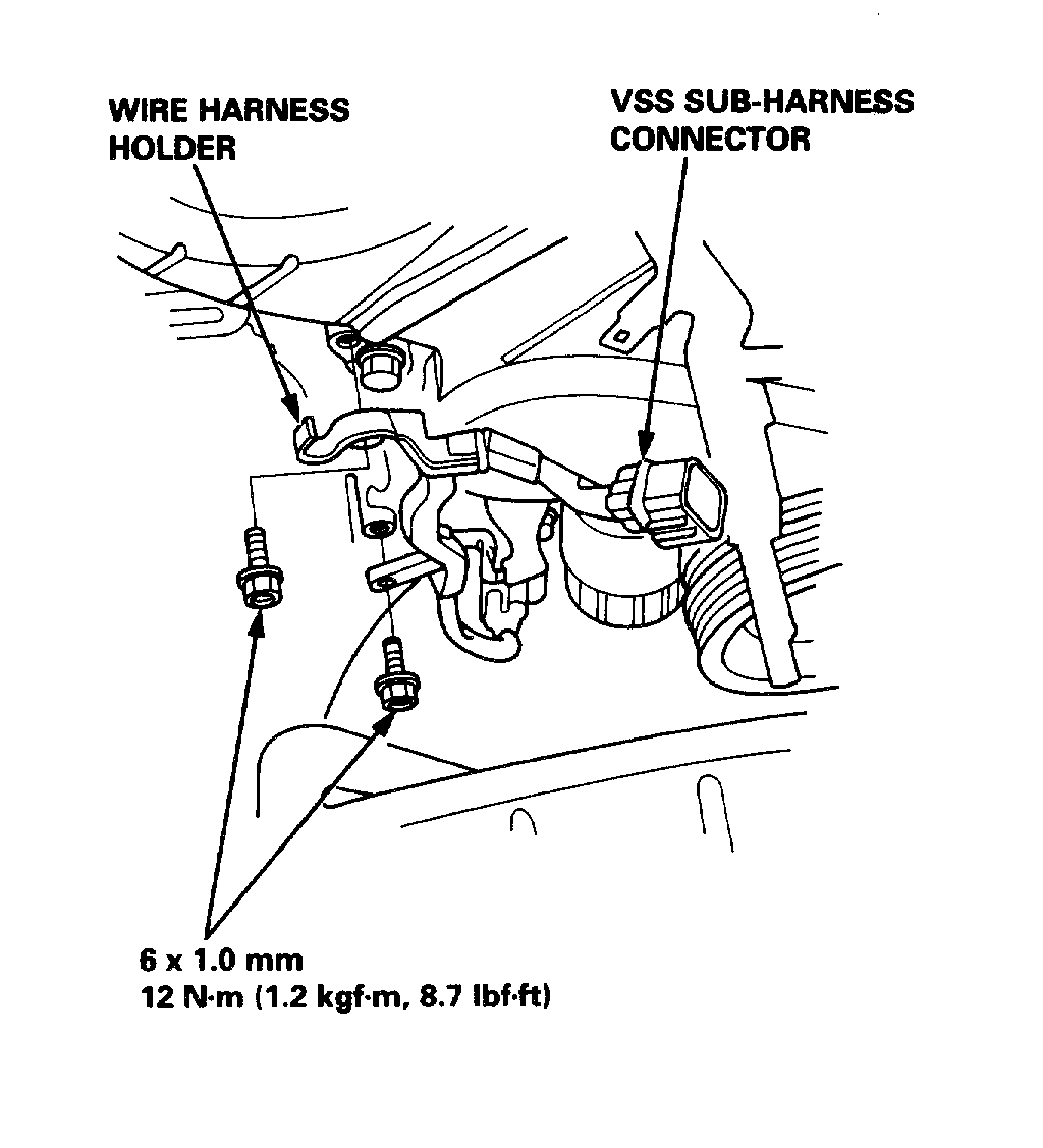

8. Disconnect the vehicle speed sensor (VSS) sub-harness connector, then remove the wire harness holder.

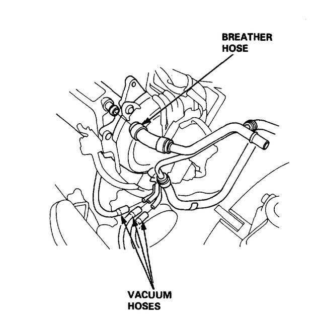

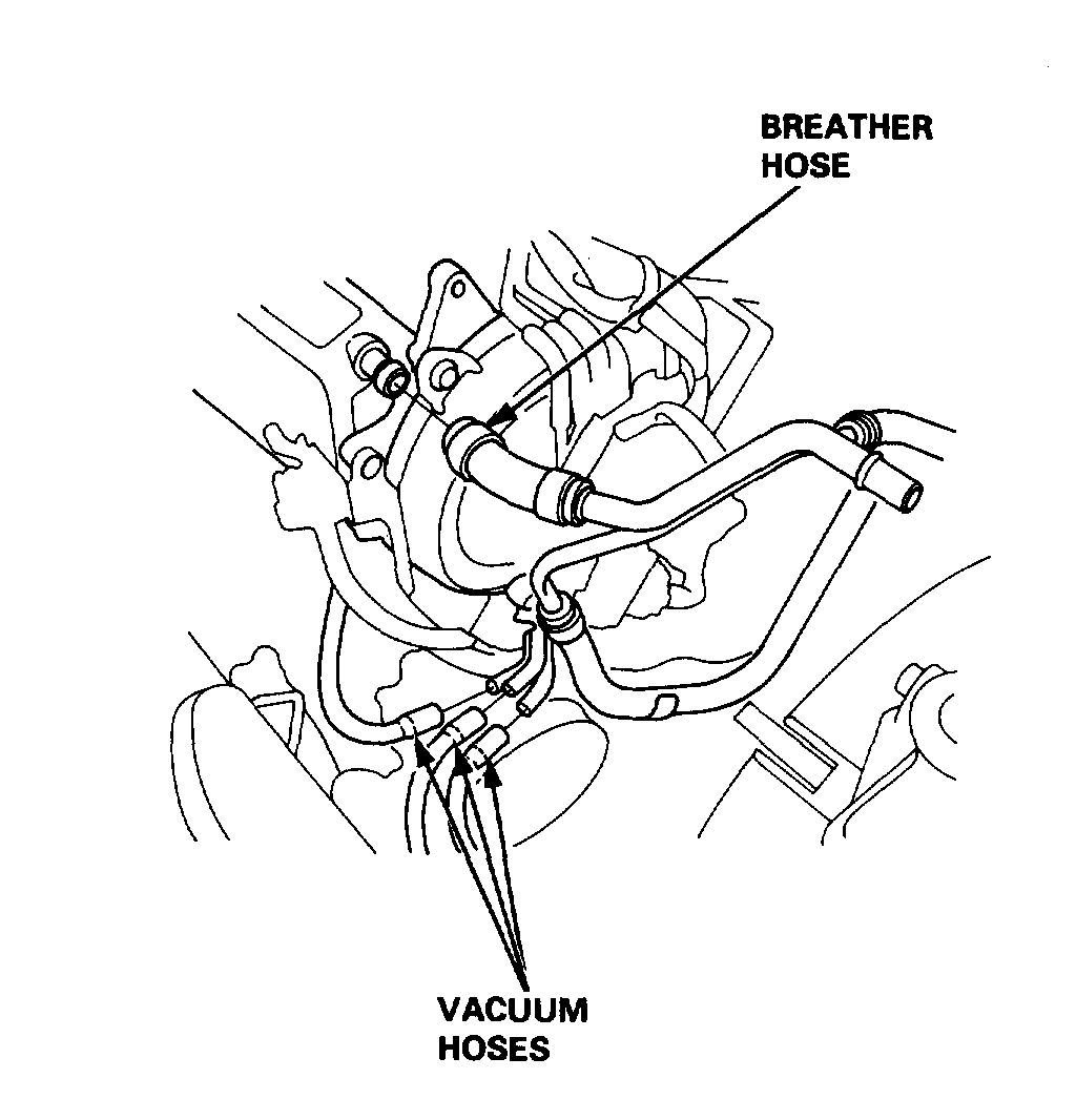

9. Remove the breather hose and vacuum hoses.
pic 8

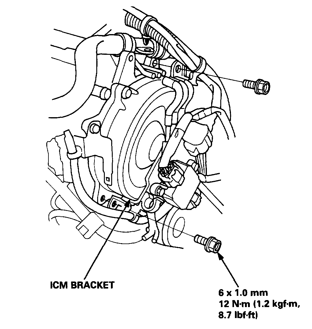

10. Remove the vacuum hoses and ignition control module (ICM) bracket.
pic 9

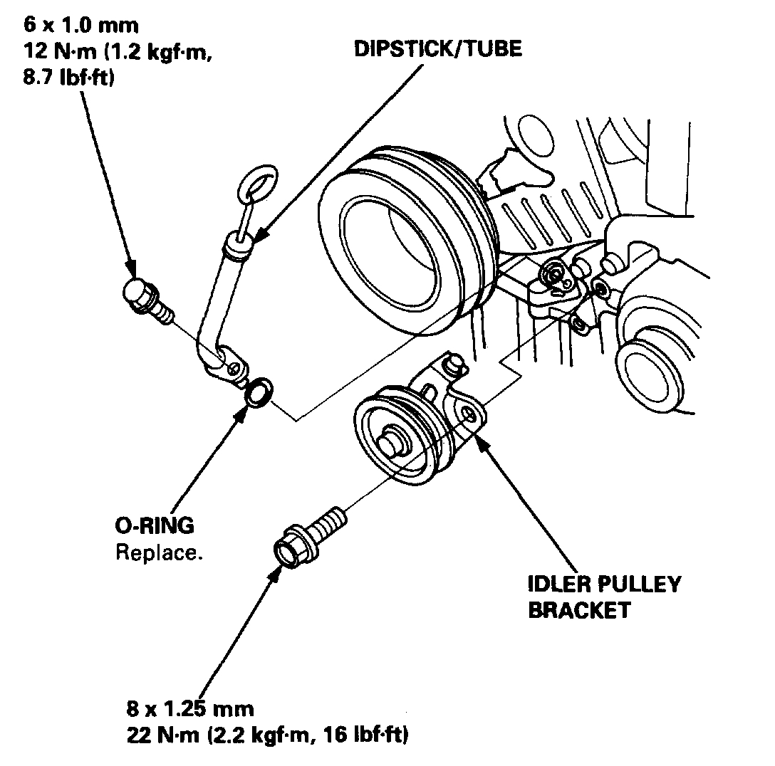

11. Remove the idler pulley bracket, dipstick and tube.
12. Remove the crankshaft pulley.

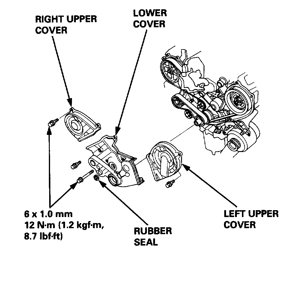

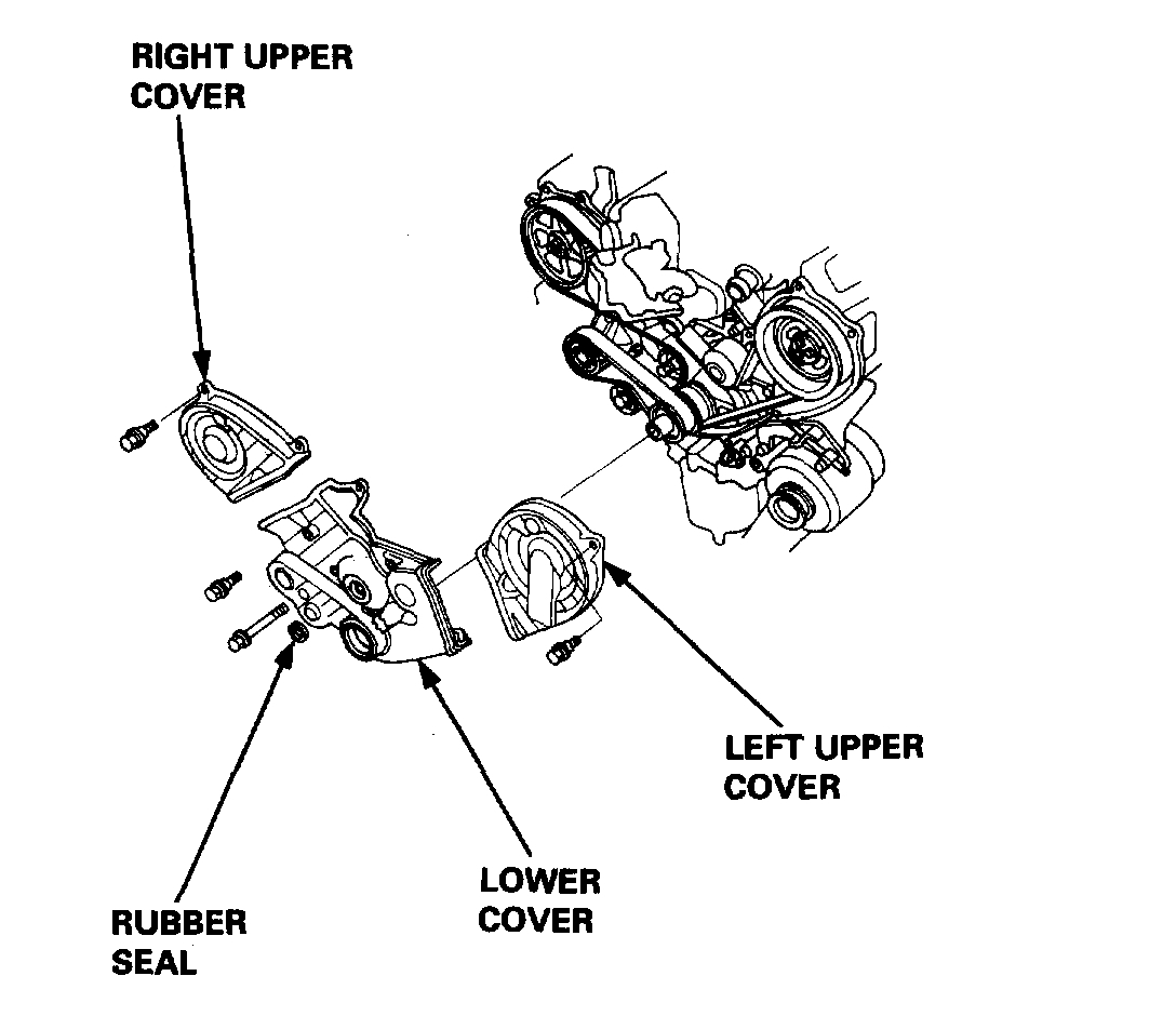

13. Remove the upper and lower covers.
NOTE: Do not use the upper and lower covers for storing removed items.
pic 11

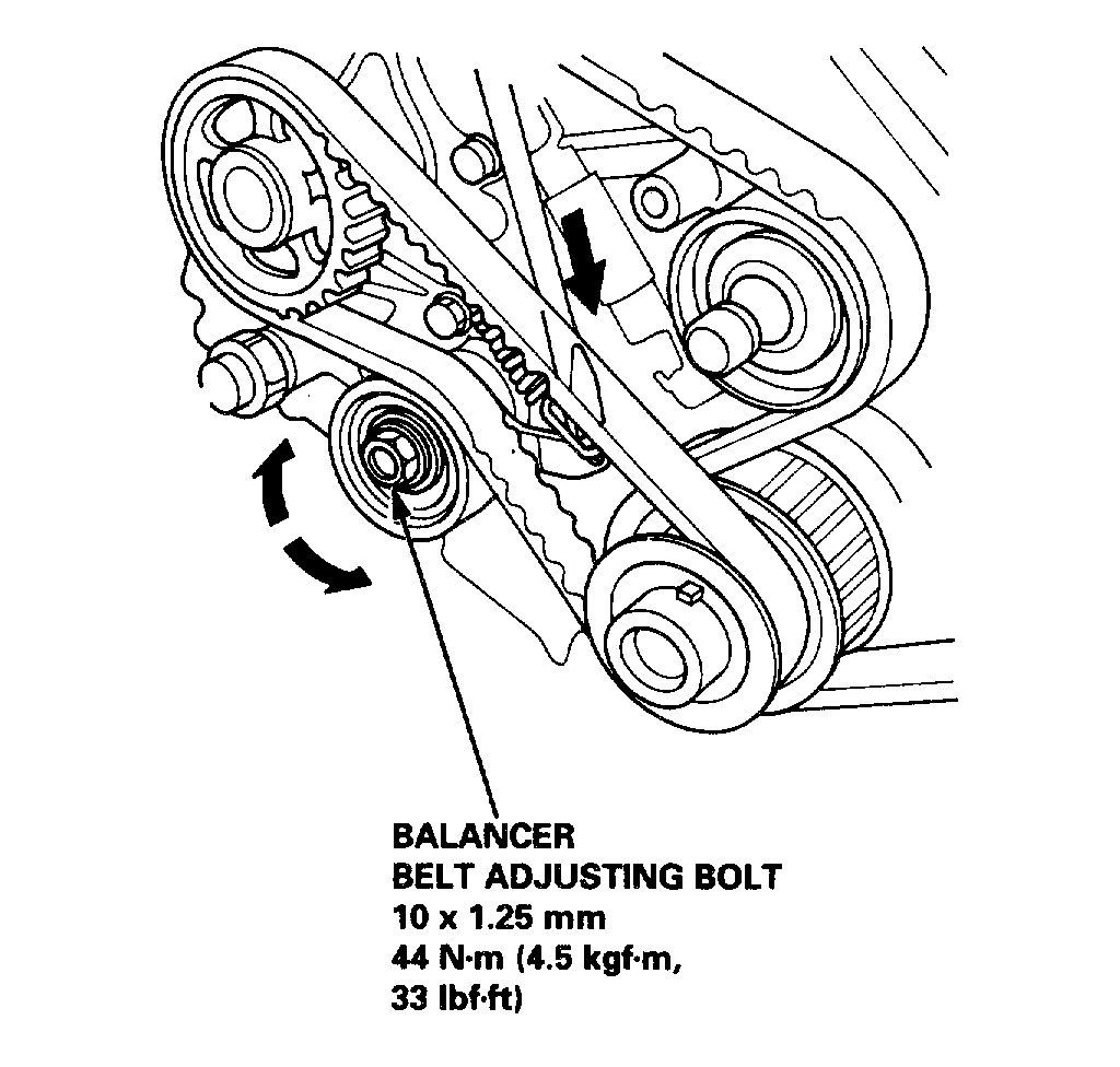

14. Loosen the balancer belt adjusting bolt 180°. Push the tensioner to remove tension from the balancer belt, then retighten the adjusting bolt.
15. Remove the balancer belt.
pic 12

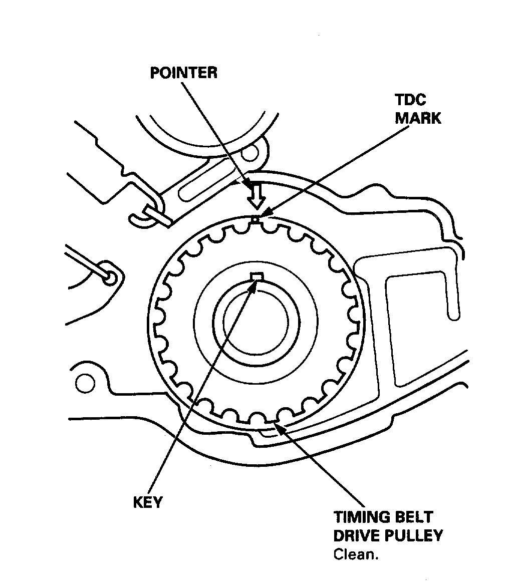

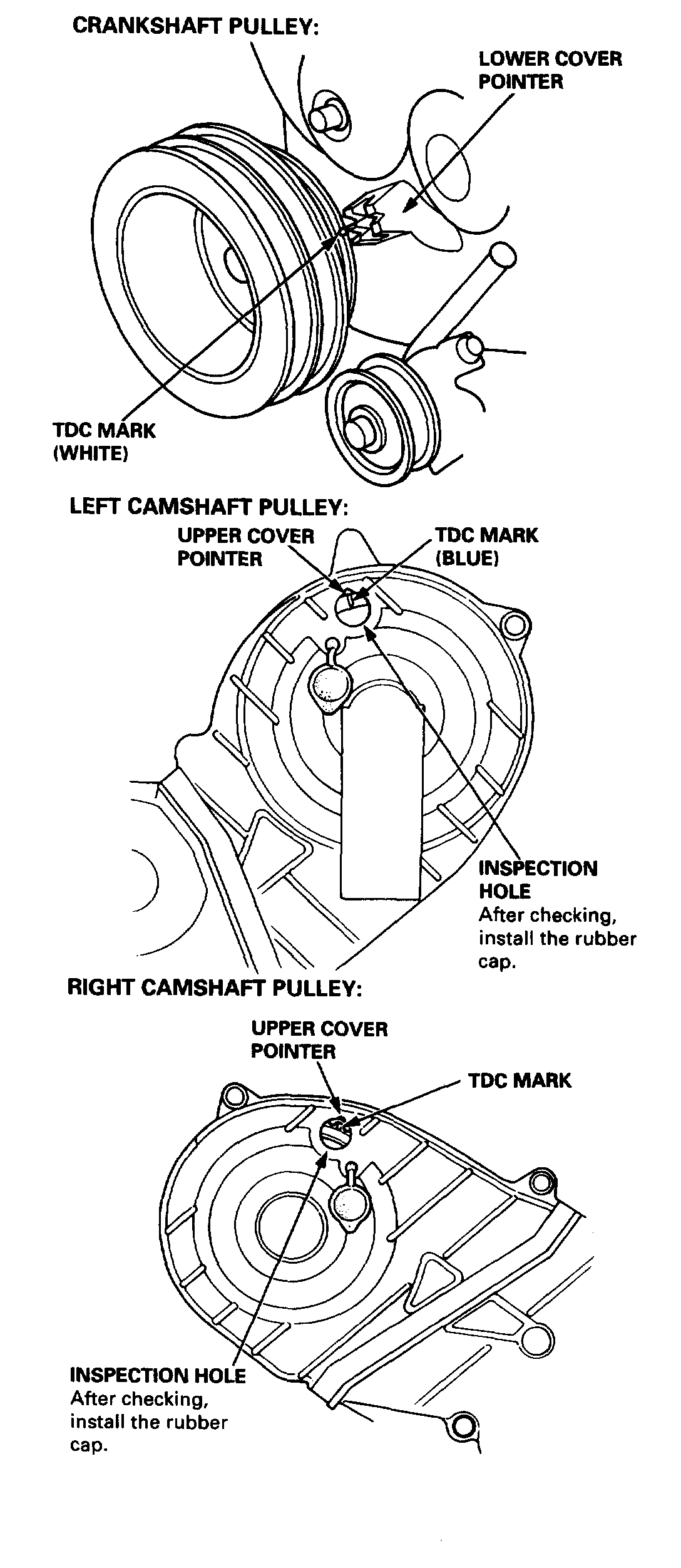

3. Set the timing belt drive pulley so that the No. 1 piston is at top dead center (TDC). Align the TDC mark on the timing belt drive pulley with the pointer on the oil pump.
pic 14

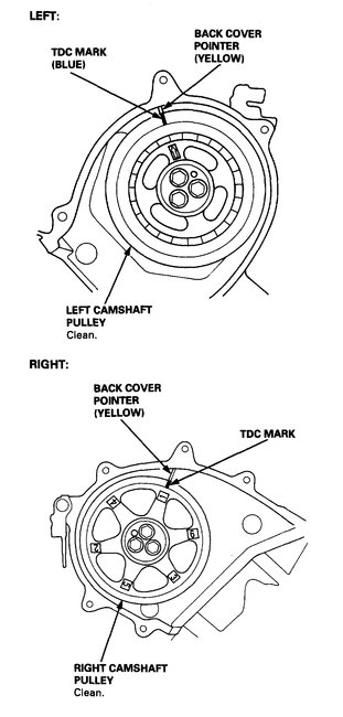

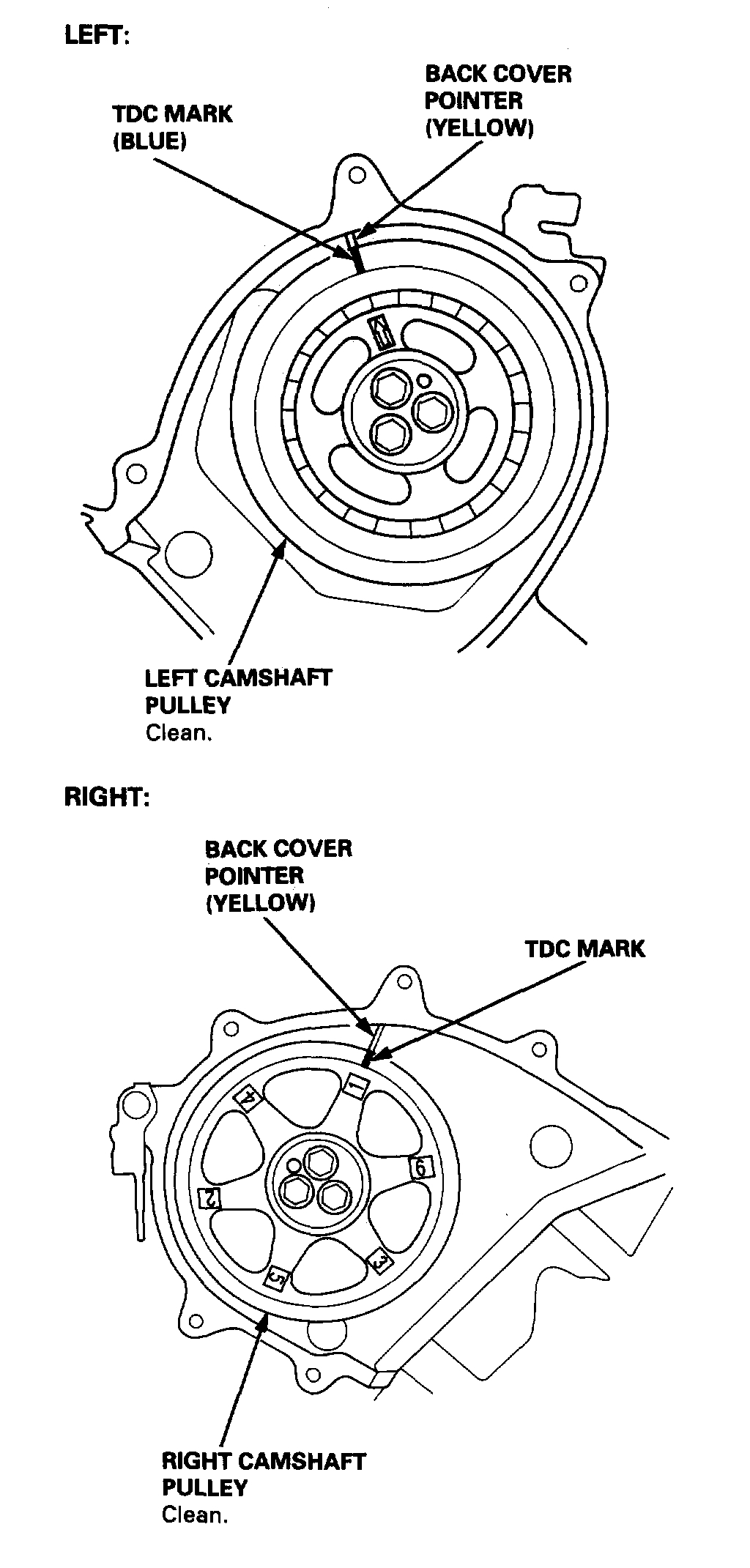

4. Set the camshaft pulleys so that the No. 1 piston is at TDC. Align the TDC marks on the camshaft pulleys to the pointers on the back covers.
pic 15

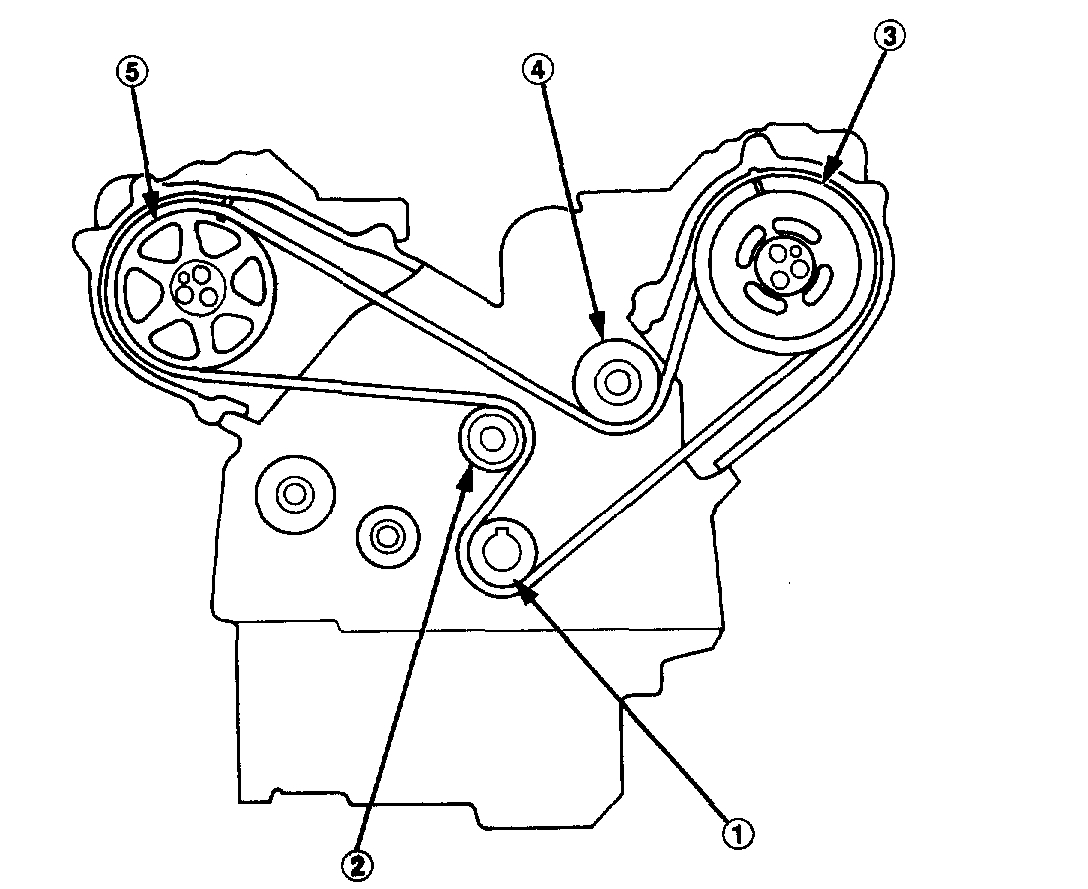

5. Install the timing belt in the sequence.
(1)Timing belt drive pulley (crankshaft) -> (2) Adjusting pulley -> (3) Left camshaft pulley -> (4) Water pump pulley -> (5) Right camshaft pulley.

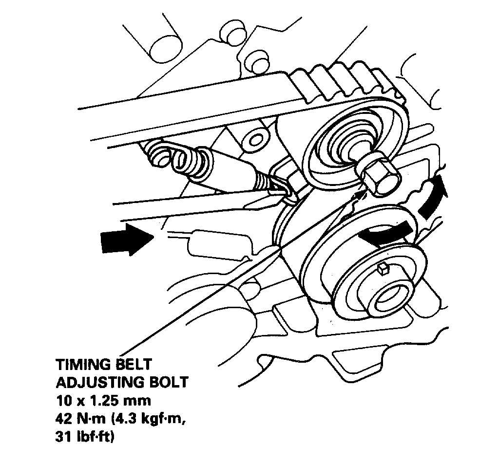

6. Loosen and retighten the timing belt adjusting bolt to tension the timing belt.
7. Install the lower cover and crankshaft pulley.
8. Rotate the crankshaft pulley about 5 or 6 turns clock wise so the timing belt positions on the pulleys.
9. Adjust the timing belt tension.

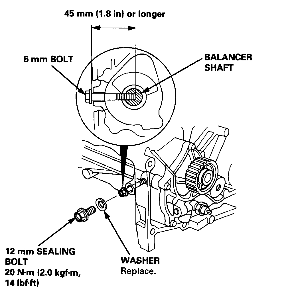

12. Align the maintenance hole and the balancer shaft hole. Insert a 6 mm bolt that is at least 45 mm (1.8 inch) long into the balancer shaft.
pic 17
13. Check alignment of the pointers.
14. Set the timing belt drive pulley so that the No. 1 piston is at TDC.
15. Install the balancer belt drive pulley, then install the balancer belt.
16. Loosen and retighten the balancer belt adjusting bolt to tension the balancer belt.
17. Remove the 6 mm bolt. Install the sealing bolt in the maintenance hole. Use a new washer.

22. Check that the crankshaft pulley and camshaft pulleys are at TDC.
23. If the camshaft and crankshaft pulleys are not positioned at TDC, remove the timing belt and adjust the positioning following the procedure, then reinstall the timing belt.

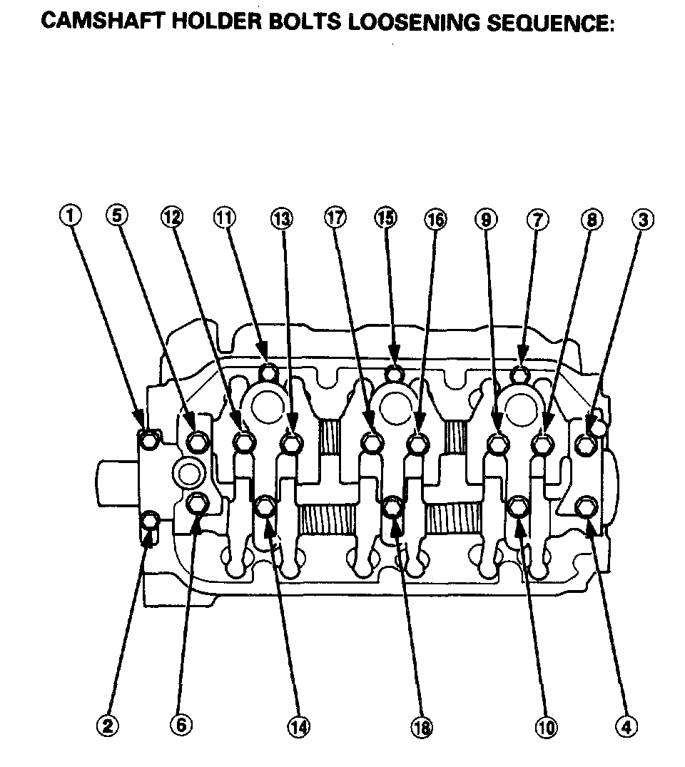

Here are the directions for removal of the rocker arms, which need removed to access the cam.
NOTE: Refer to rocker arm assembly removal. Identify parts as they are removed to ensure reinstallation in original locations. Inspect rocker shafts and rocker arms. Rocker arms must be installed in the same position if reused. When removing or installing the rocker arm assembly, do not remove the camshaft holder bolts. The bolts will keep the holders, springs and rocker arms on the shaft.
Removal
pic 20
NOTE:
- To prevent damage to the valves or rocker arm assembly, unscrew the camshaft holder bolts two turns at a time in a crisscross pattern.
- When removing the rocker arm assembly, do not remove the camshaft holder bolts. The bolts will keep the camshaft holders, the springs and the rocker arms on the shahs.
NOTE: Refer to camshaft when installing.
