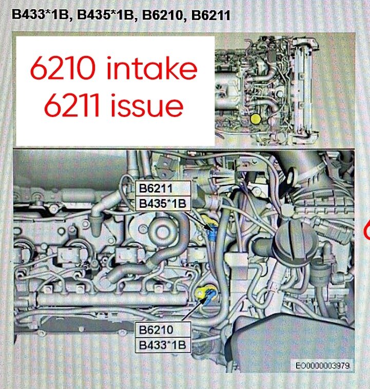

Please where is camshaft position sensor location on the vehicle listed above g05 M50i N63B44D?

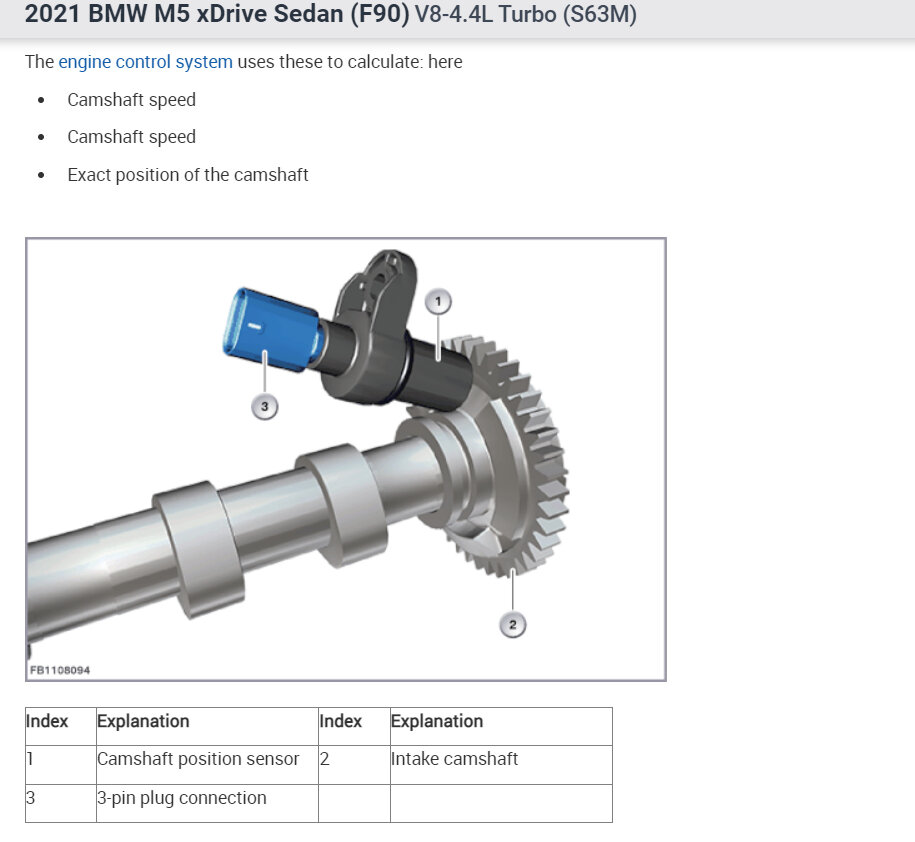

May 15, 2023 at 9:09 AM
CERTIFIED EXPERT
53,854 POSTS
The camshaft position sensor is located near the cylinder head or camshaft assembly. Check out the images (below). Please let us know if you need anything else to get the problem fixed.
