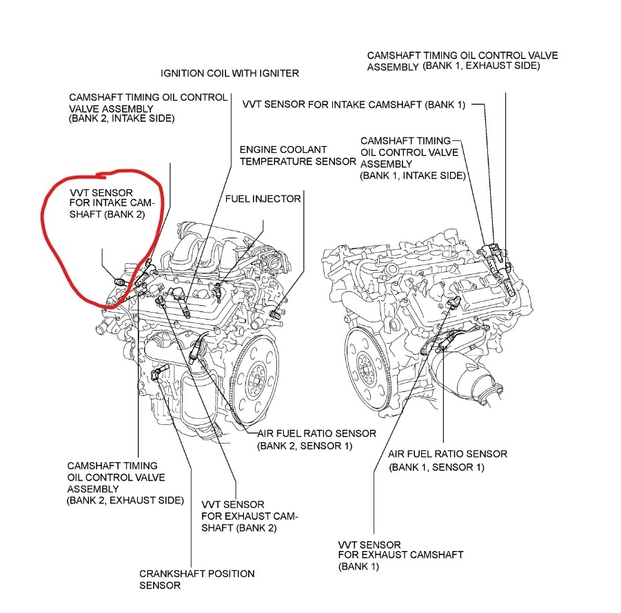

I Need to know how many camshaft sensors are in my car.
And the location of them.

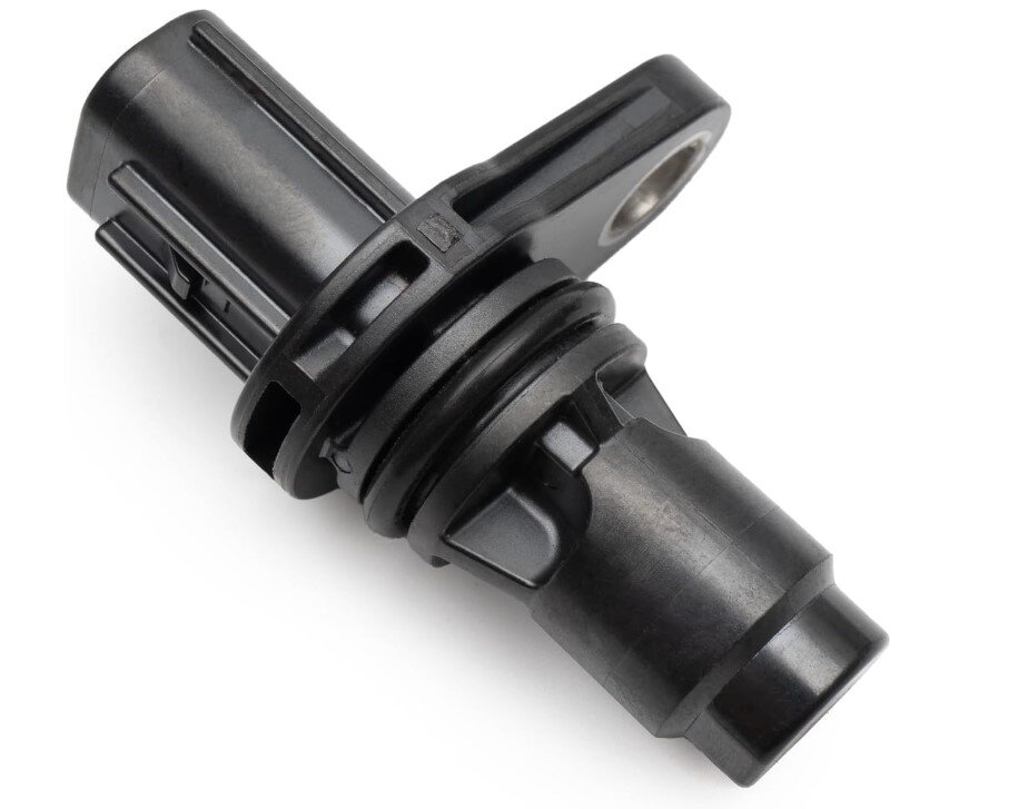

I bought a new camshaft sensor.

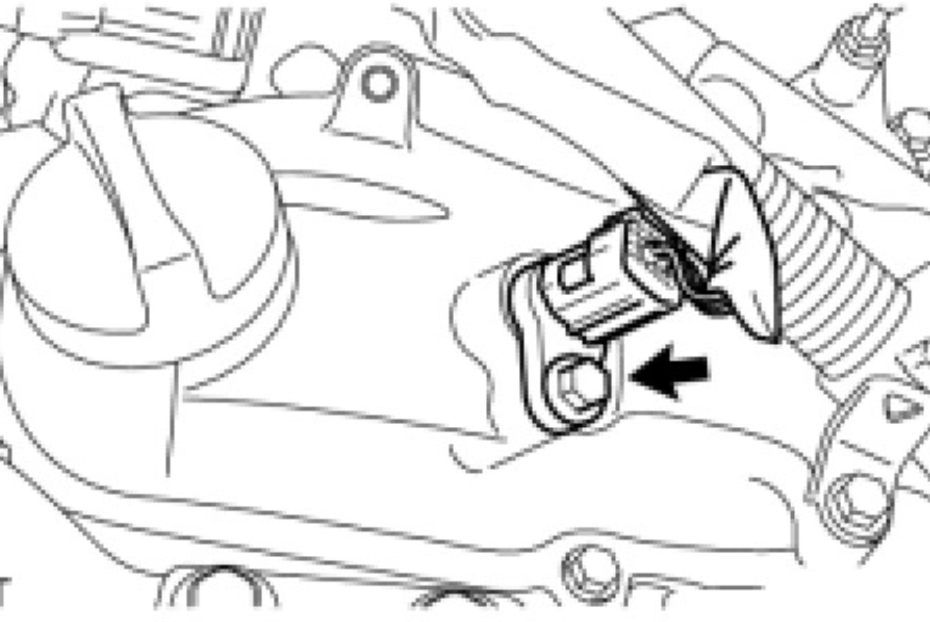

There are a total of 4 camshaft sensors (VVT sensors in Toyota speak) However the code you have show as Camshaft Position Sensor "A" Circuit (Bank 2) Which translates to Bank 2 intake camshaft sensor is showing a fault. The sensor you are looking for is right next to the oil fill on the valve cover. First check the wiring close, if it's damaged it can set the same code. The sensor has a single bolt. When you install the replacement just snug it down good. The spec if 7 lb ft but it isn't critical.
