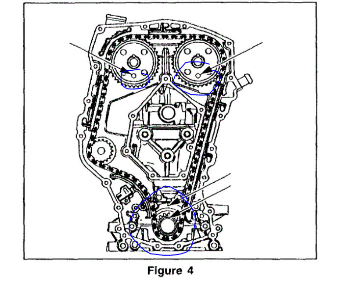

#1 is TDC bottom crank timing mark points north, but the cam tabs were both pointing south. would the motor run with the cams off? always has ran rough at stops.

Can you upload a picture of what you see that makes you think the timing is off?
I attached the correct alignment for the chain with the timing marks.

Okay, if you look at the diagram I sent you, line up the crankshaft marks that I circled. That is top dead center for the piston in number 1 cylinder.

Forget the wrap and just set the marks so they are lined up as in the diagram.
Are or is the mark at 12 o clock?
