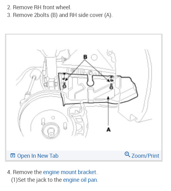

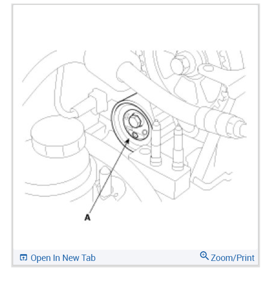

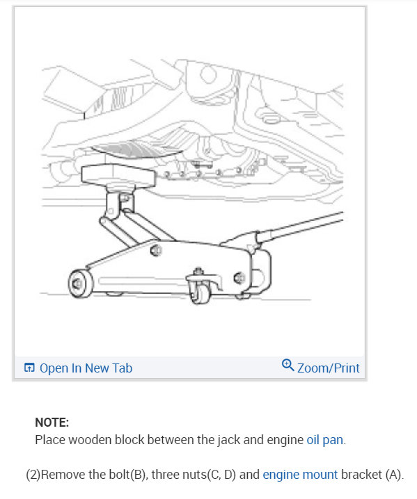

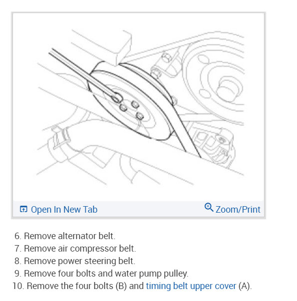

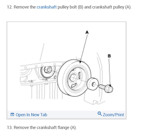

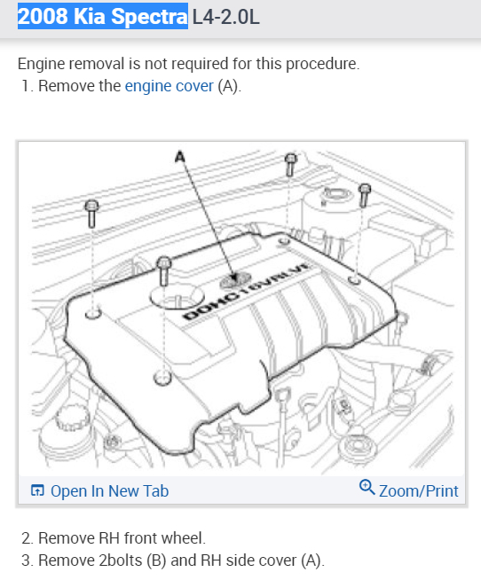

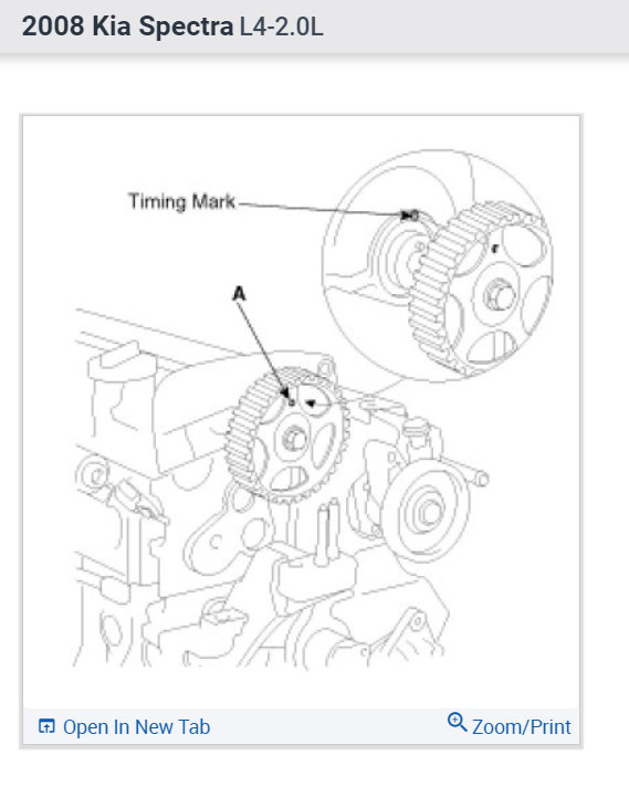

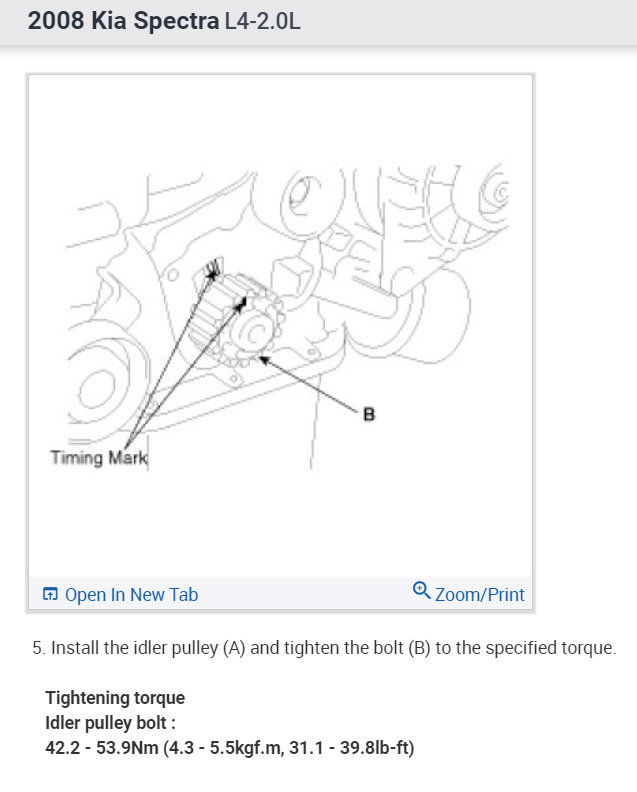

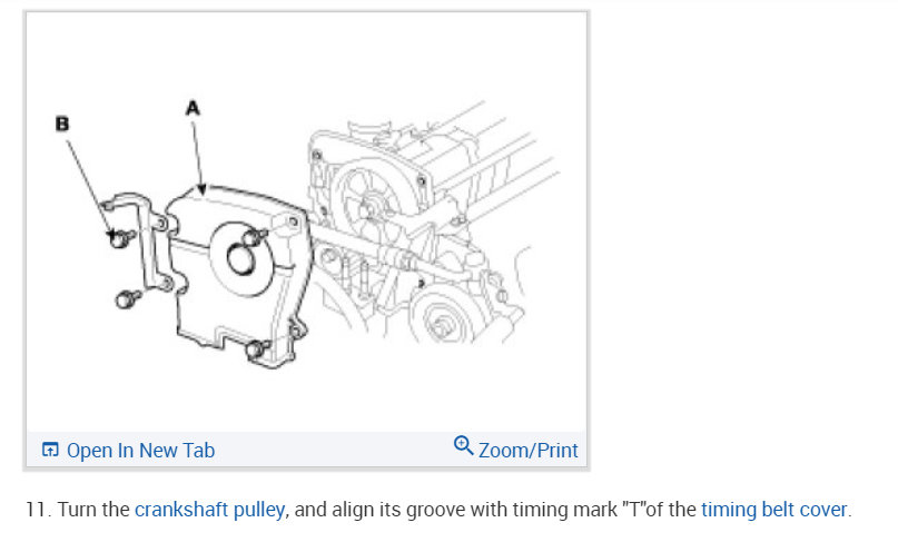

I need cam shaft timing marks?
Aug 27, 2016 at 11:10 AM

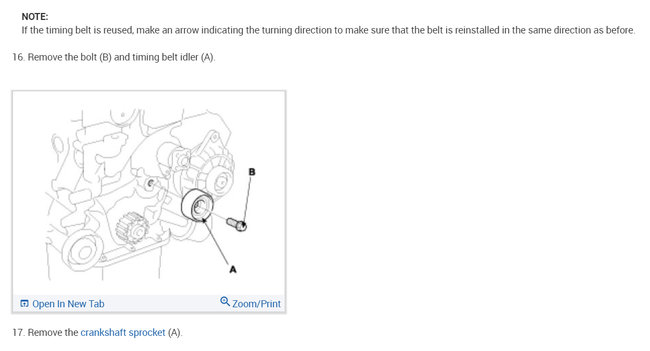

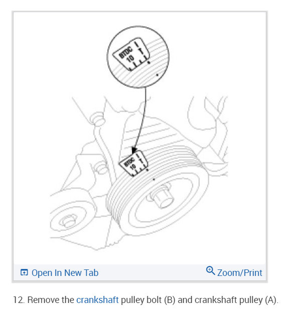

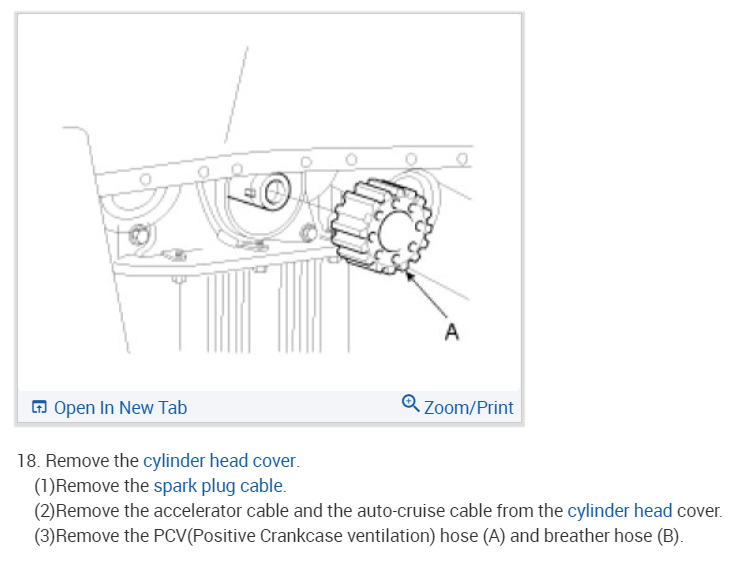

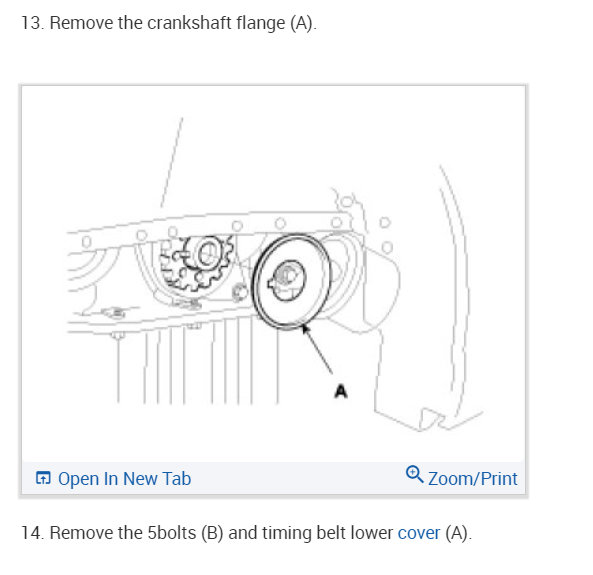

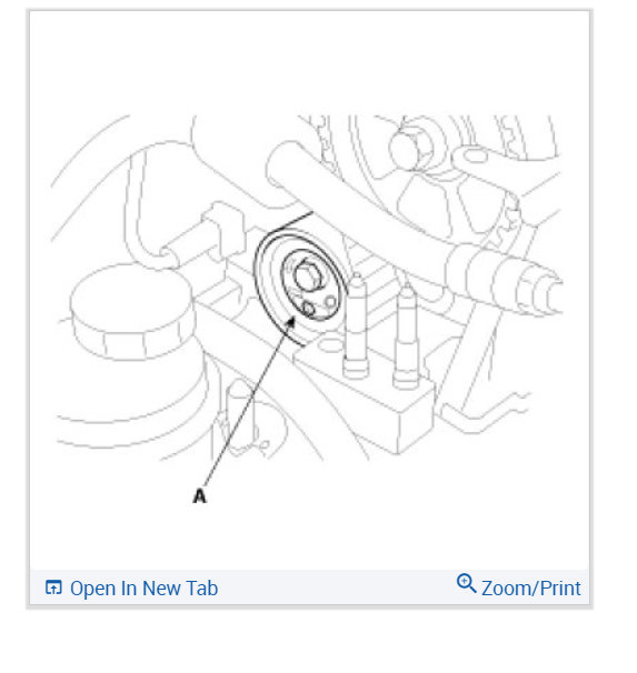

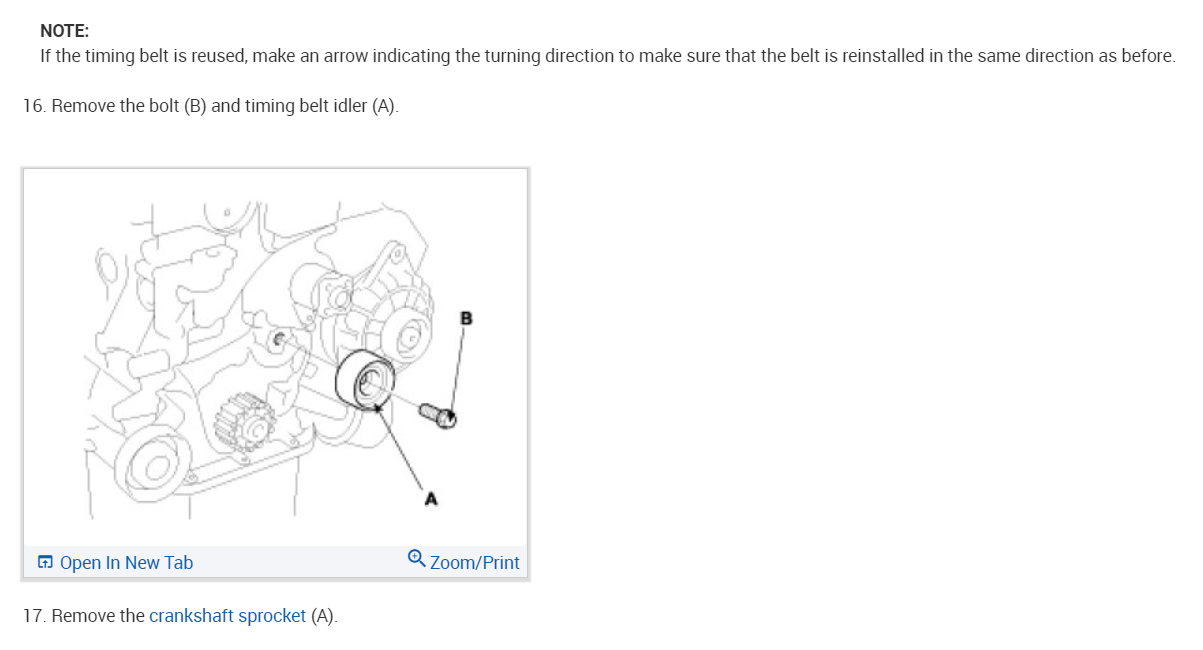

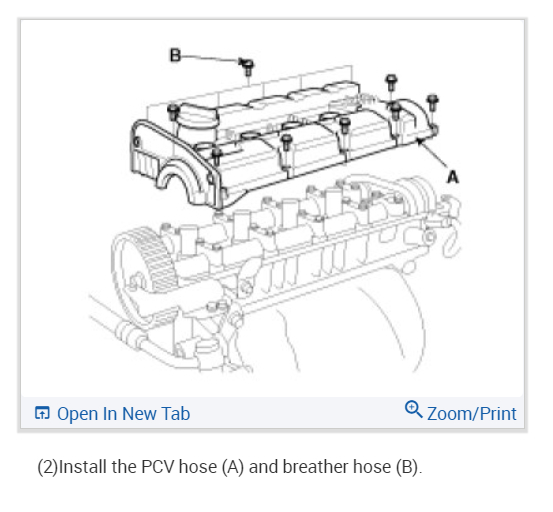

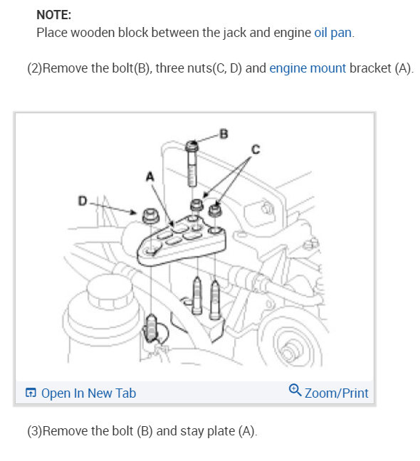

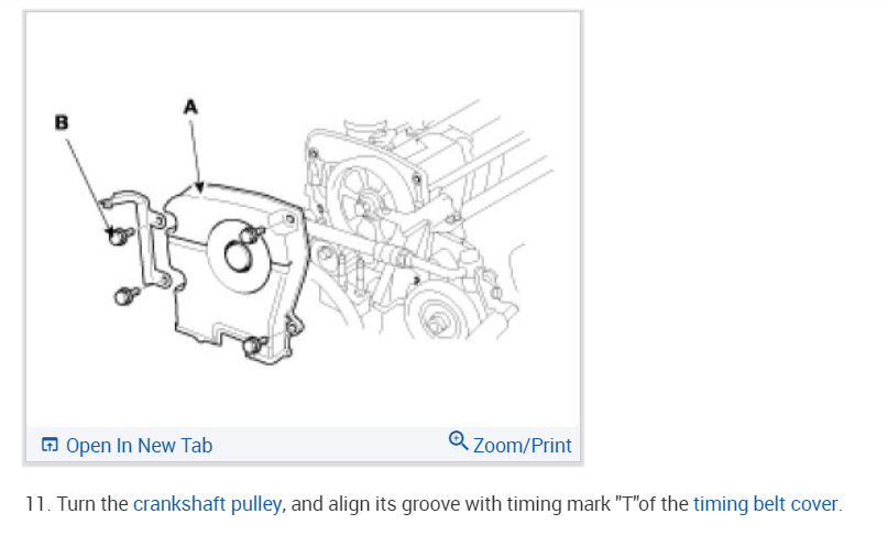

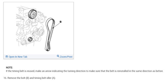

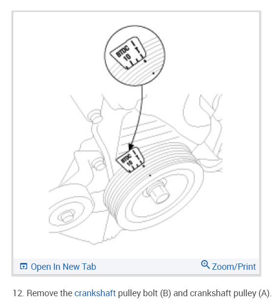

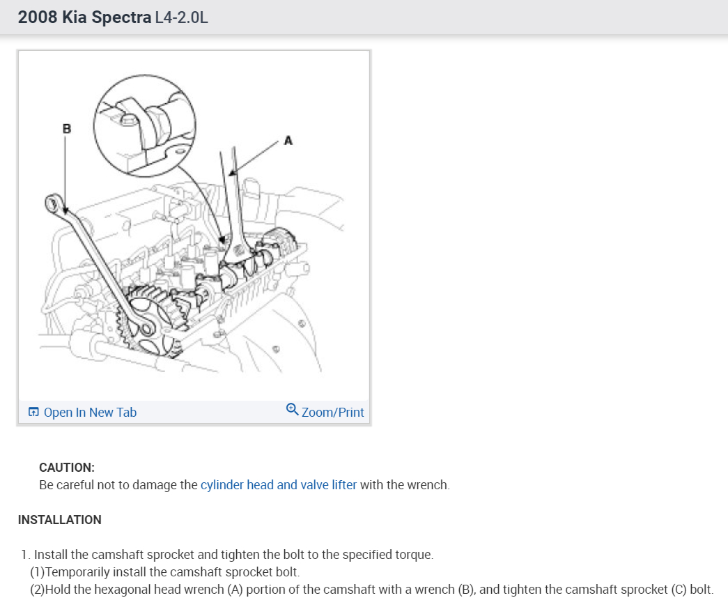

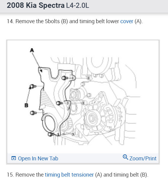

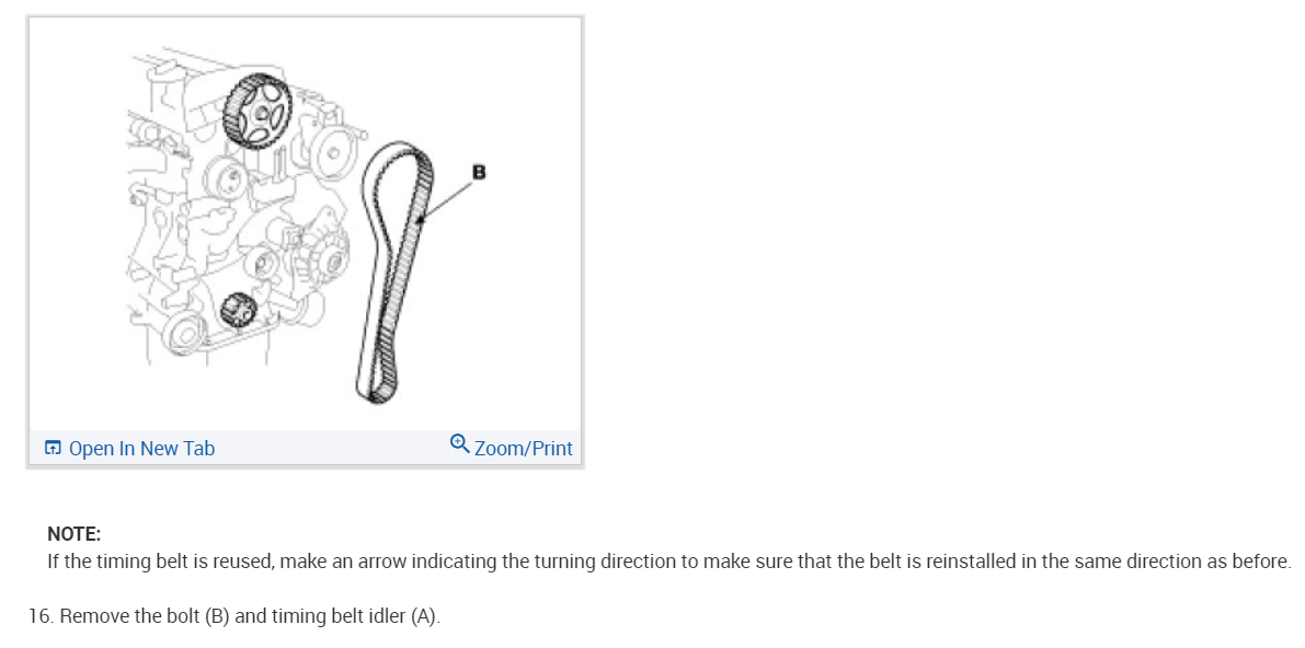

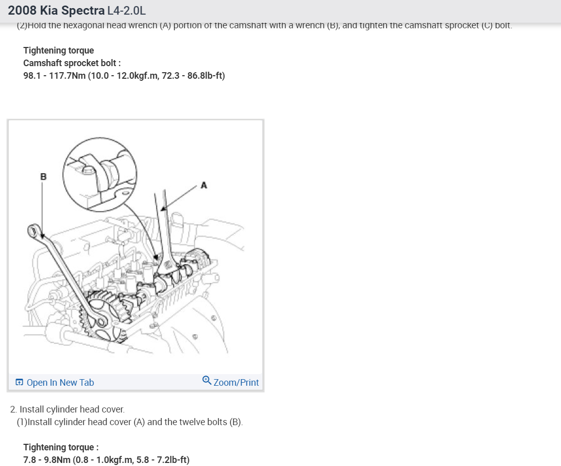

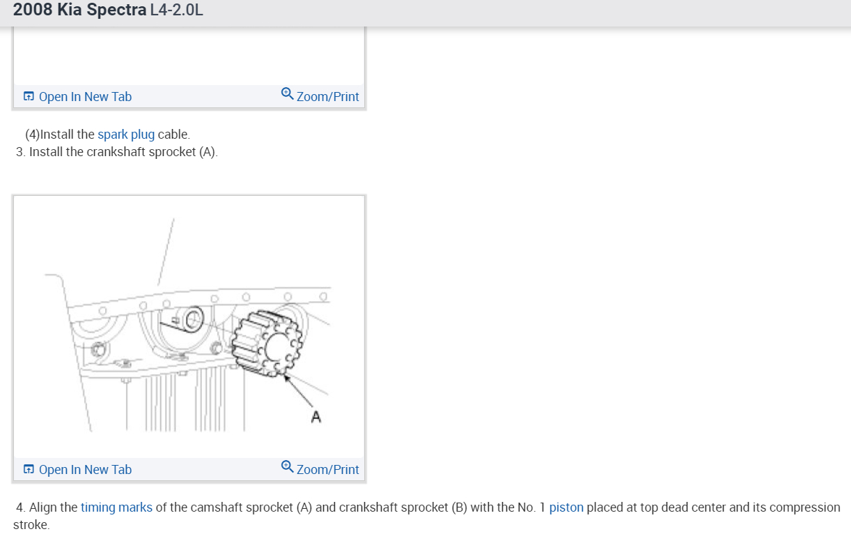

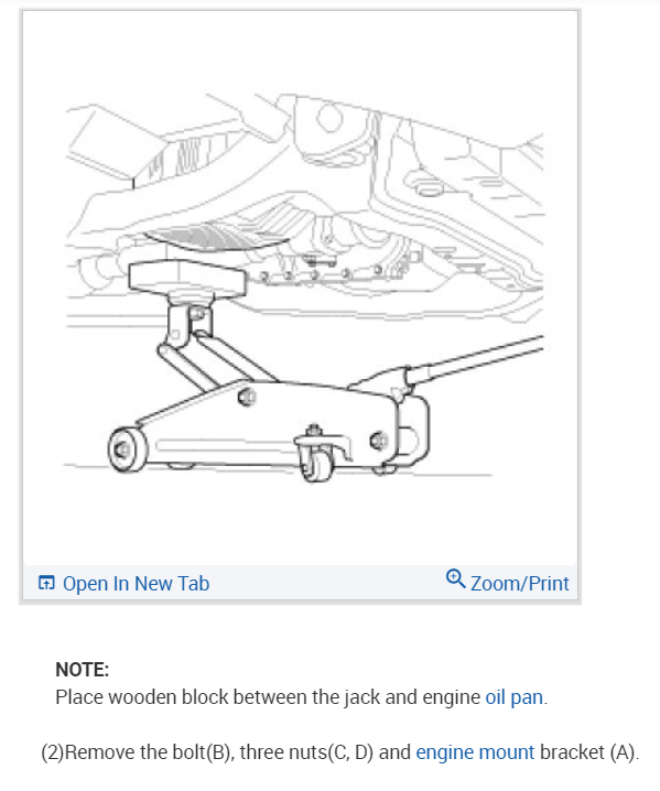

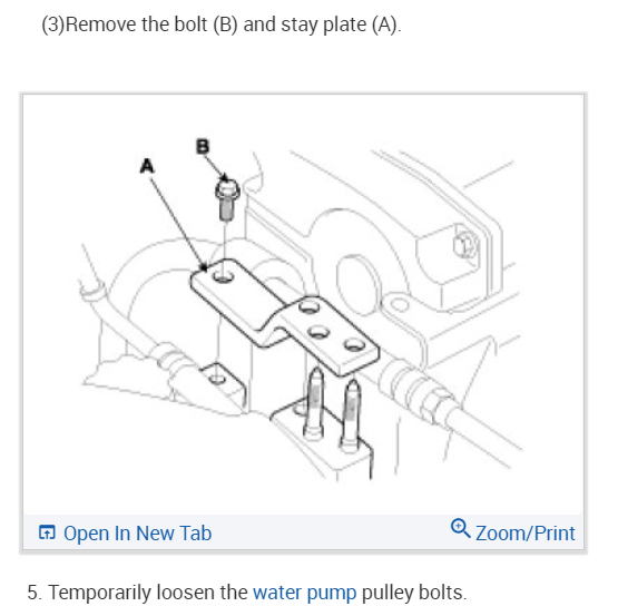

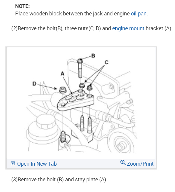

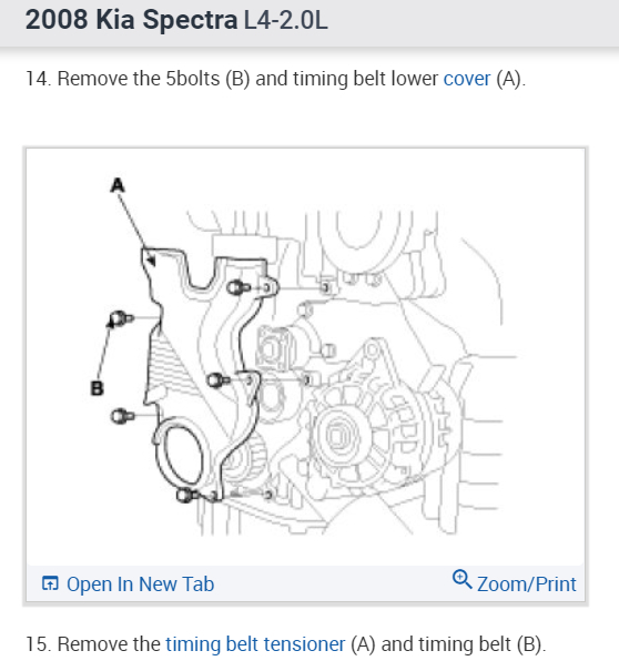

Here are the timing belt and camshaft marks for you car and the instructions on how to change the timing belt out in the diagrams below. Check out the diagrams (Below). Please let us know if you need anything else to get the problem fixed.
