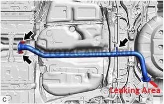

Hello guys i have the car listed above LE model. recently i changed the brake pads i have noticed water leaking in the exhaust pipe. It was a cold start btw.
i see no damage to the area, it's a bit dusty though, but i don't think that's the reason for leaking.
pictures show the leaking location is.
It is the joined location between the pipe and muffler.
i was wondering if should i unscrew those two bolts and clean up the surface area and put some seals on it maybe ?

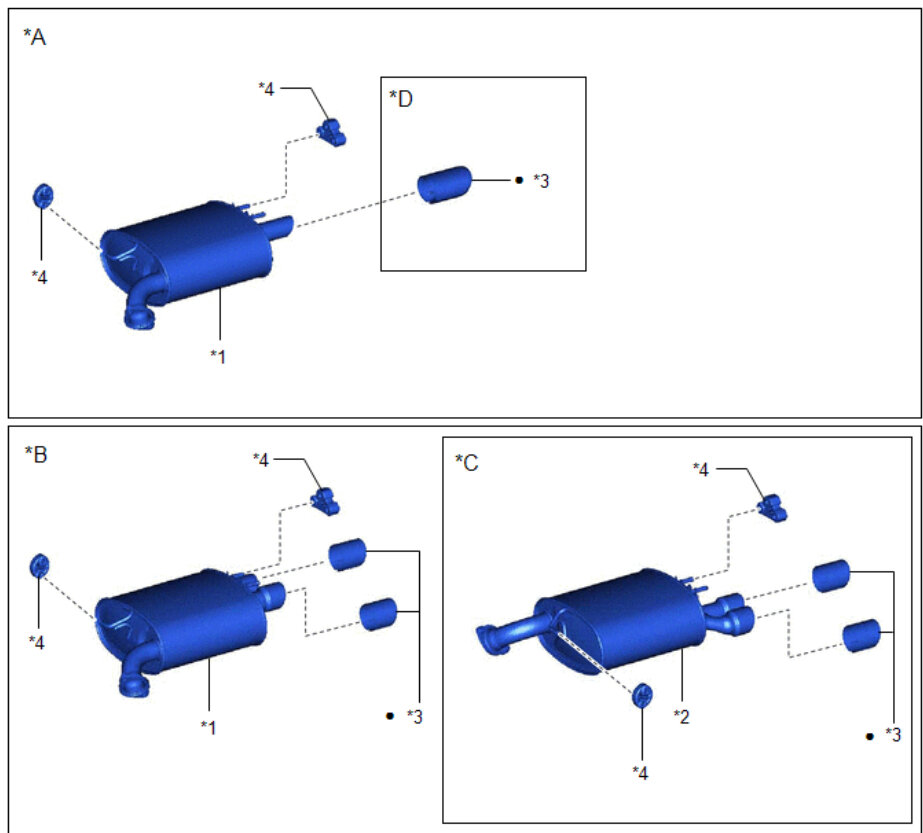

Hello, the actual byproduct of the Catalytic Converter is water, so a little bit dripping out the muffler is normal. But not at the locations you are seeing it. There is a tiny hole in the Muffler only for water to come out, At the locations you are seeing it means those gaskets have failed. I think yes, replacing the gasket if there is one there, if not and it's just a bolt on, then replace the bolts, clean the surface areas where it contacts and bolt it back together. I say replace the bolts because they rust quickly anyway, and this will save on future headaches, I will look over service info for any gaskets that might be there and post the information here shortly.

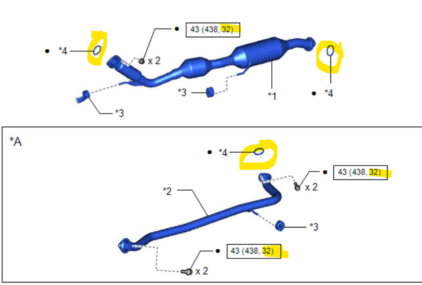

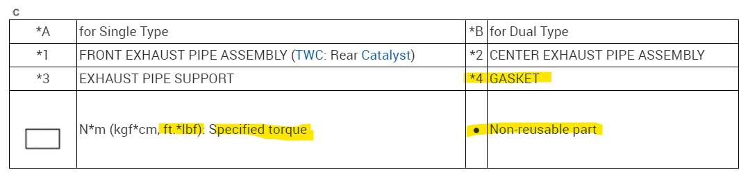

In the 1st diagram, the last number highlighted in yellow is the Torque Spec in Ft Lbs. A regular torque wrench will read in (Ft Lbs), smaller ones read in (in lbs). I have also circled the gaskets for each location.
