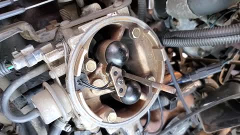

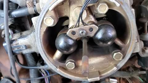

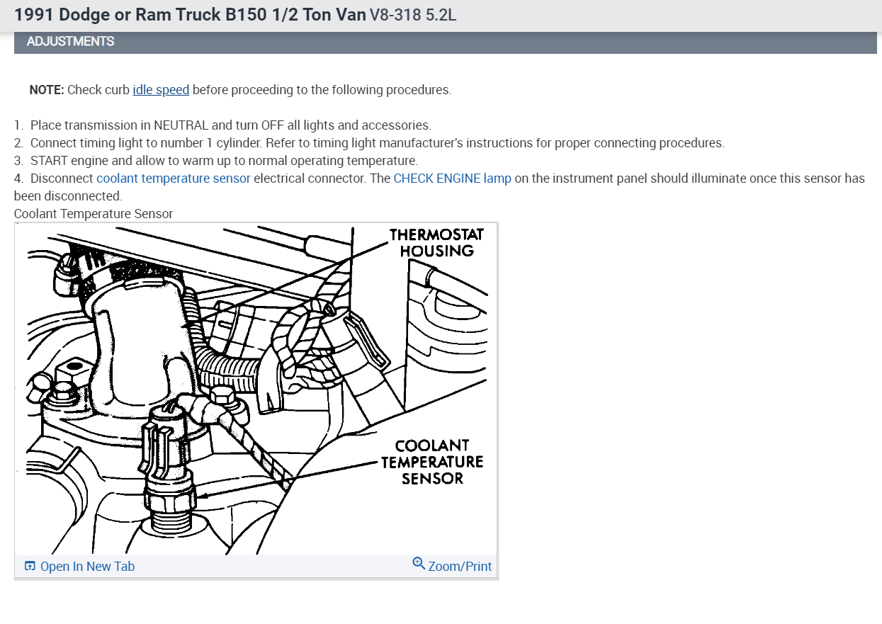

The vehicle listed above is a camper van. Was on the highway doing 70MPH when all the sudden van lost power. pulled over van still running. i turned it off but was never able to start it again. called AAA to bring us home.
installed (assumed) fuel pump and filter, still no start. i loosened and turned the distributor clockwise about 1/8 of an inch. van starts but obviously runs poorly. put the distributor back to where it was.
sometimes i can get the van to start cold but once it stalls, it is hard to restart it again unless i wait a while.
checked all relays and voltage readings at the coil - all in spec.
i appreciate any guidance.
