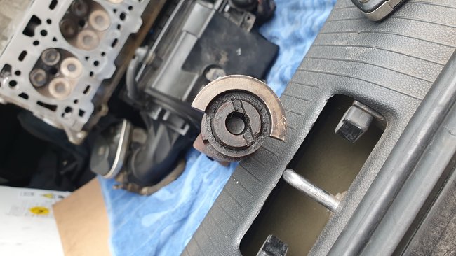

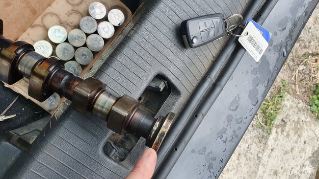

Hi, finger on the bit that rotates.

Hi, if possible would like a picture like this one must be intake cam. thanks
Dave

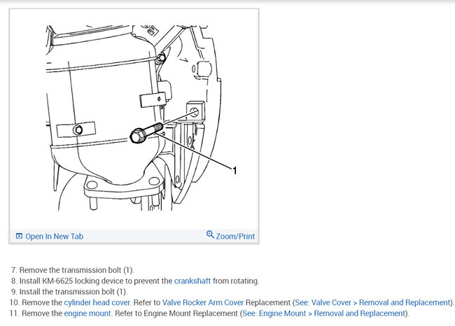

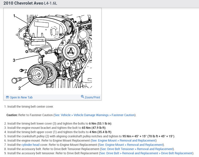

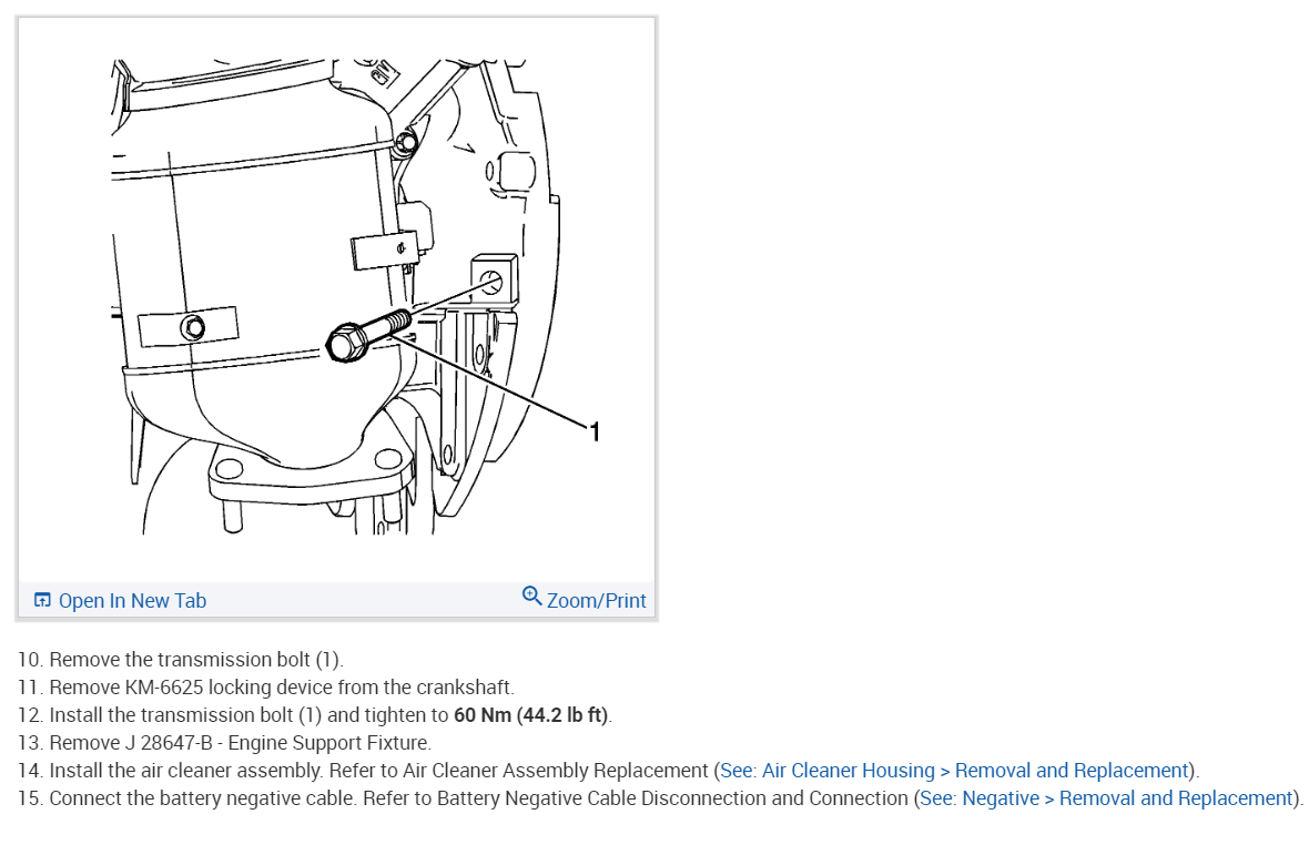

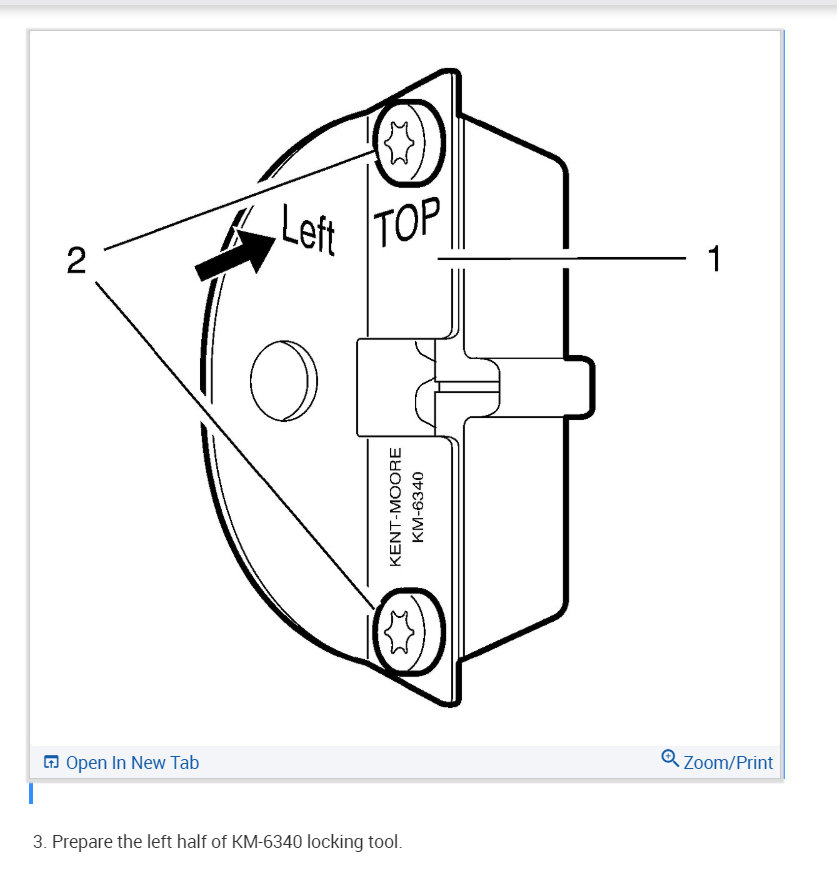

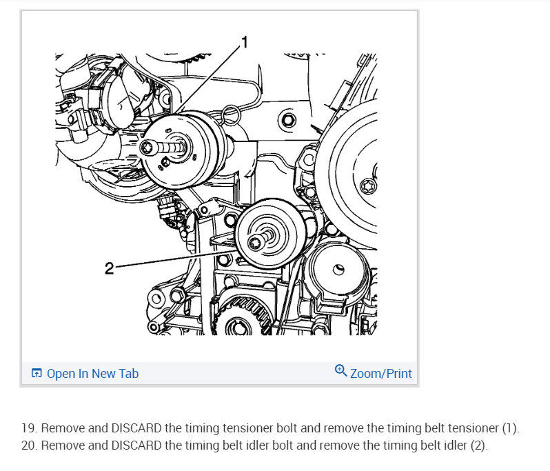

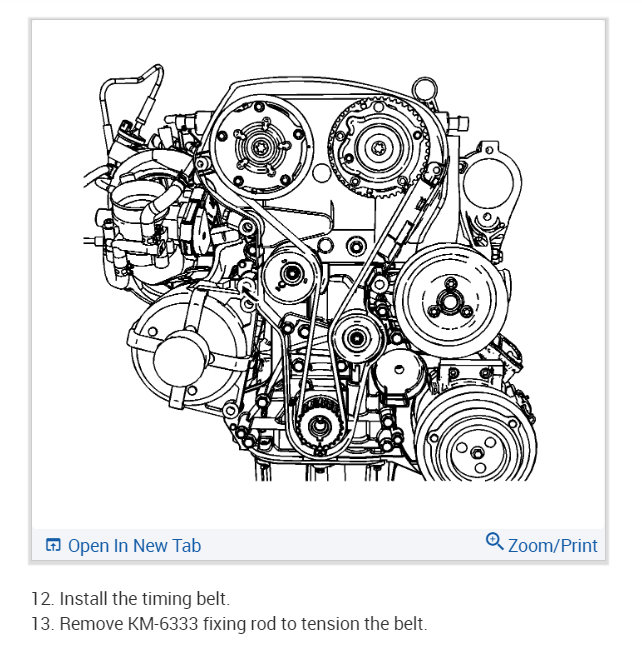

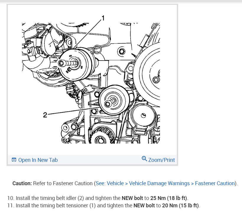

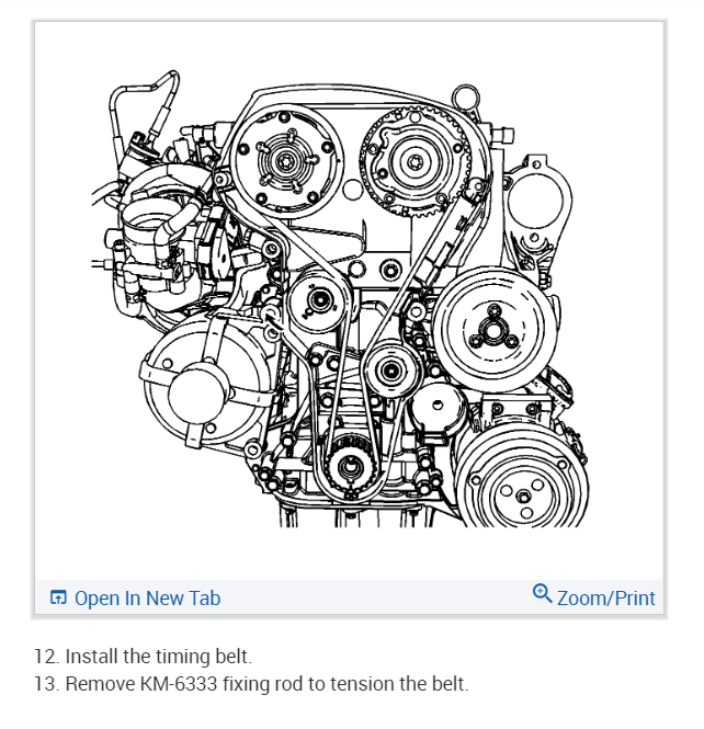

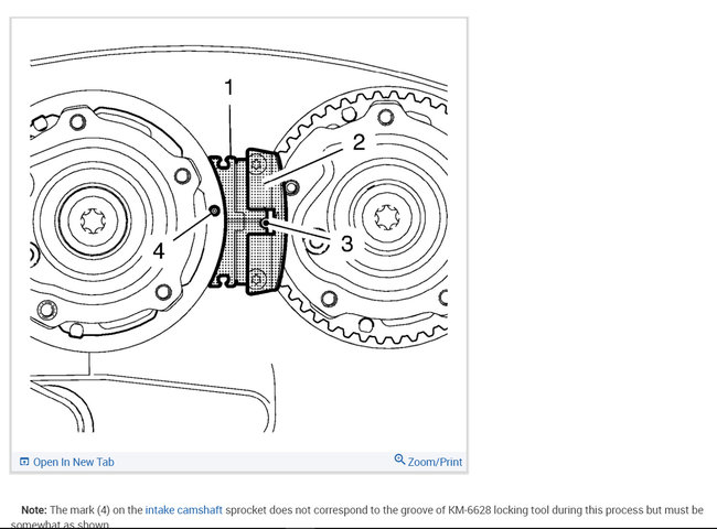

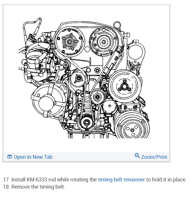

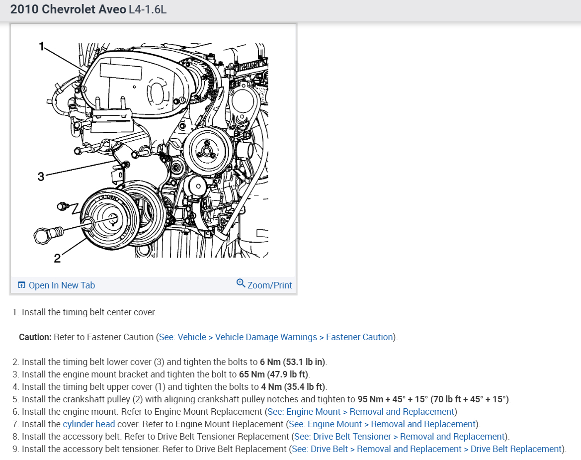

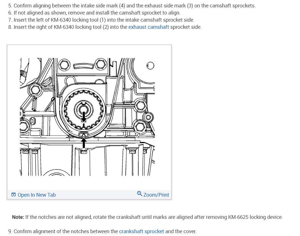

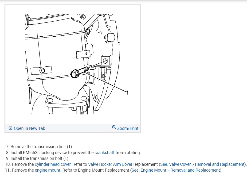

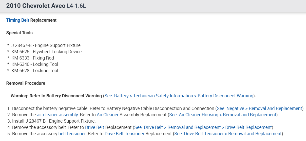

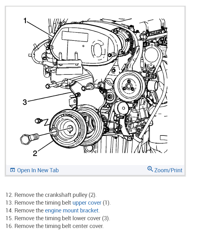

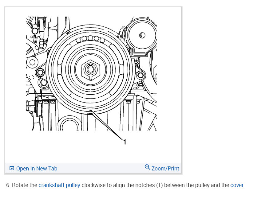

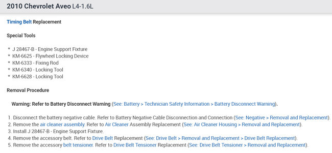

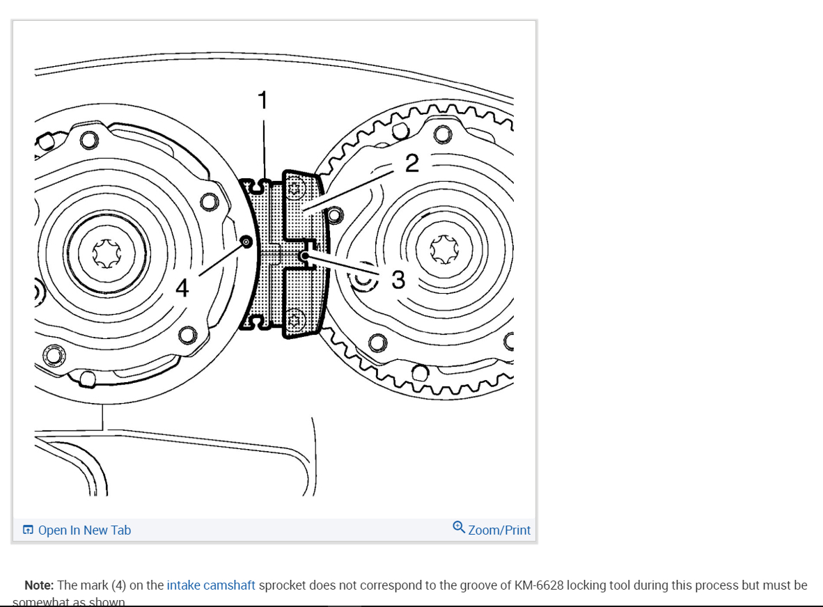

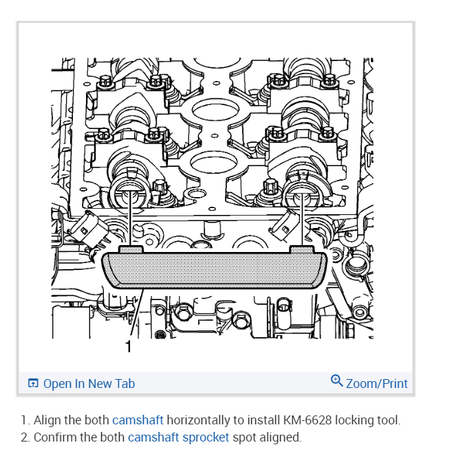

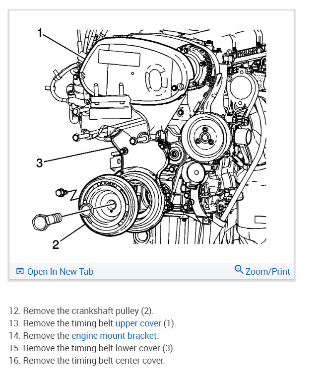

The timing is set by the mark at the front of the camshaft. This engine is the same as a Chevrolet Aveo. here are the instructions to help align the marks and get you the tightening instructions. You should be able to eyeball the marks without using the tool. BTW. Check out the diagrams (below). Please let us know if you need anything else to get the problem fixed.

Hi, thanks for the reply. but sorry not on this engine. the cam wheels are not located on the cams you can put the cam wheels anywhere I am used to a key way so they had to go in the right place but nothing on these cams .
Cheers
Dave

Ken, sorry mate too late already rebuilt. but i can say the ends of the cams were round and smooth and the wheels were round and smooth no slots for key ways seemed very odd to me.
cheers,
Dave
