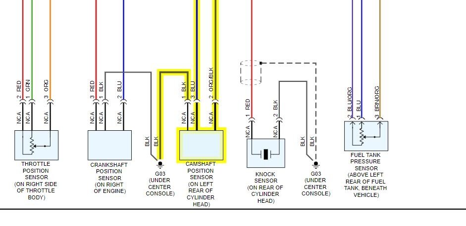

The wiring for the cam shaft sensor should be in what position? we have a blue which is hot orange wire in the middle and black wire on the bottom but the replacement plug show a red for the top black for the middle and green bottom. all the wiring diagram shows the blue top orange center and black bottom. can any one tell me in which order it actually goes?
