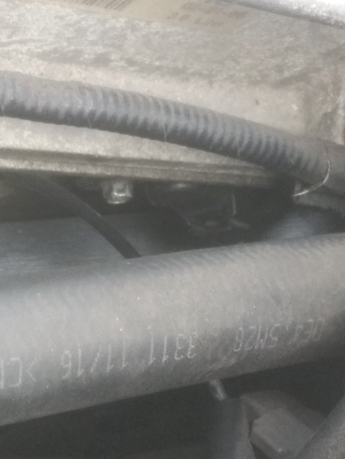

Two days ago check engine light came on. Within an hour, the car started running horribly and engine was chattering. I put the diagnostic on it and it threw several codes. Cam sensor, crank sensor, 02 sensor, EVAP, cylinder four misfire, and bank 1 running lean. I talked to my buddy who said could just be the crank sensor throwing everything off. I changed one but was told there are two. I have checked diagrams but the other sensor is not where they show. Please help. And do you think it is just the cam sensor causing all that? Before this I have had no issues with the car. Oh, the sensor I changed was on the passenger side at the front of the front valve cover.

The camshaft sensor is front of left cylinder head.

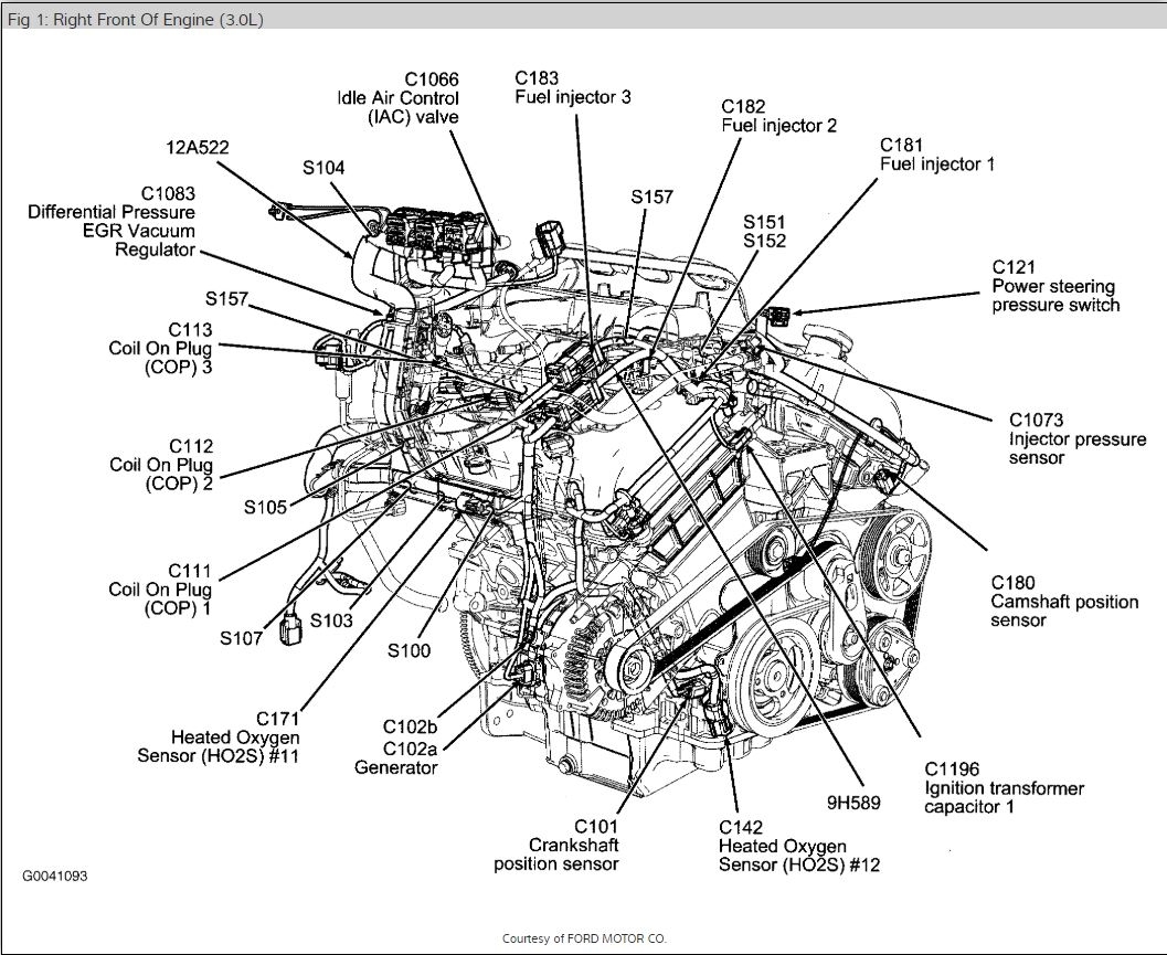

Here is the diagram:
Jun 8, 2018 at 8:32 AM
PATENTED_REPAIR_PRO
  • 1,853 POSTS
Okay, what year engine is that?
Send me the link for that diagram.

I have a 2006. I am not sure what year the engine in the diagram is. I searched up for a 2006. Let me go get the link.

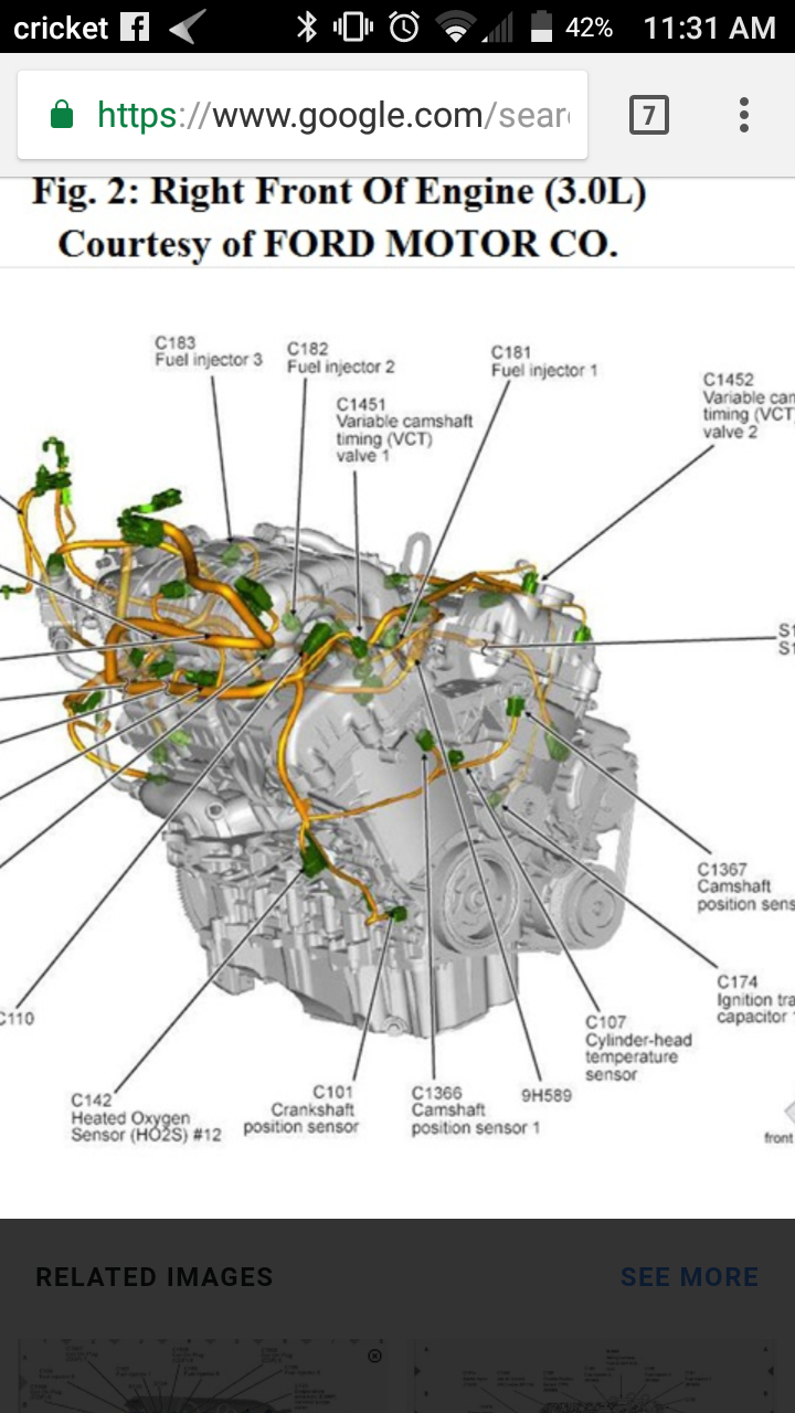

This is what I have.
Jun 8, 2018 at 8:38 AM
JIMM1080
  • 21 POSTS
That is definitely the one I changed. And it is still throwing the code for it.
Jun 8, 2018 at 8:43 AM
JIMM1080
  • 21 POSTS
That is my engine for sure.

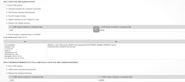

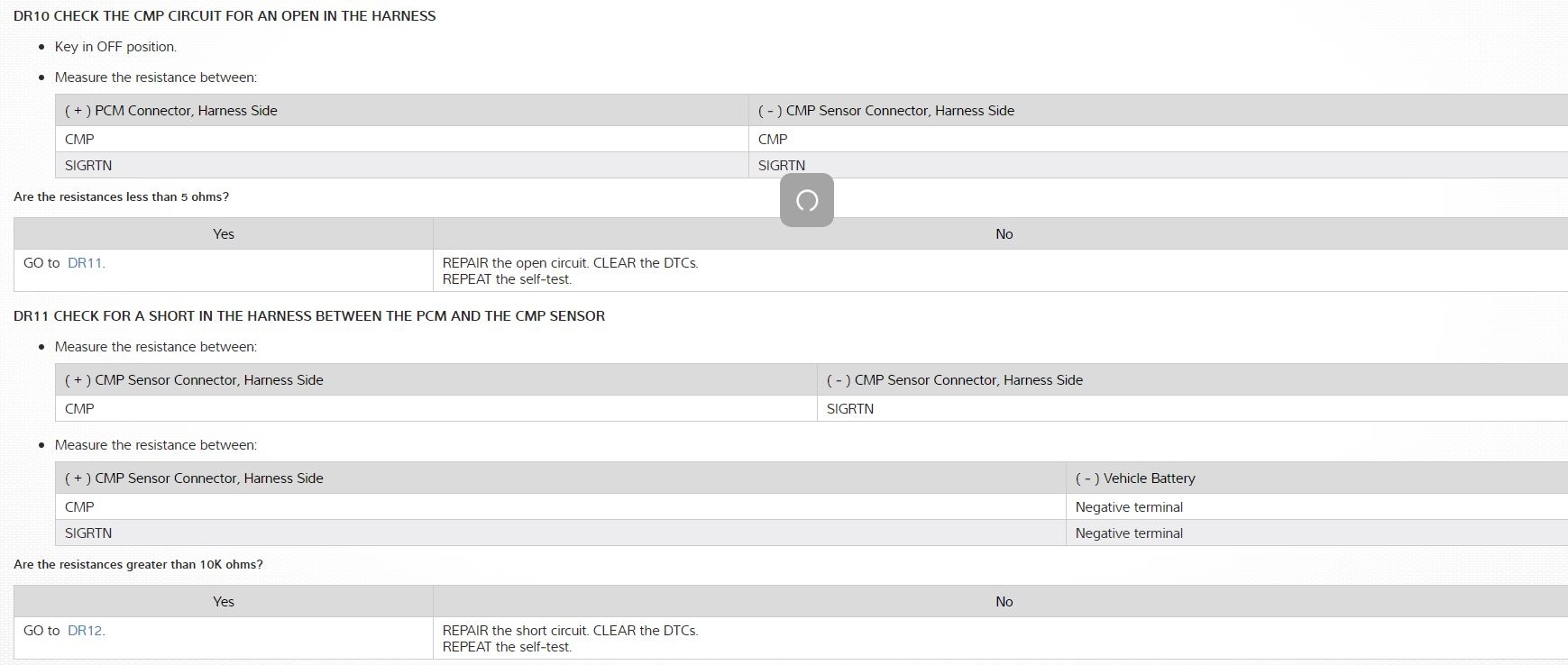

That is good, it should have been 250-1,000 ohms, so that 347 is within that.
Next step:
Disconnect the hardness connector at the PCM, so the crank sensor as no connection to it all.
Then using the DV voltmeter check short circuit to voltage on the harness side of the disconnected crank sensor dark blue/orange wire. If this wire is hot when the key is on run, engine off that find and repair the short, where the hot voltage from a positively charged wire is short circuited to this wire.
If there is no voltage present on this wire, like it should be then move onto step 10.
Let me know your answer and I will post step 10.

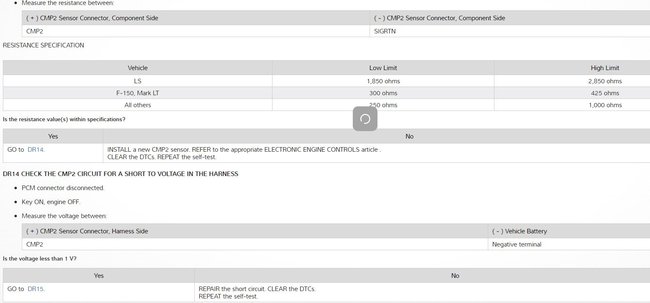

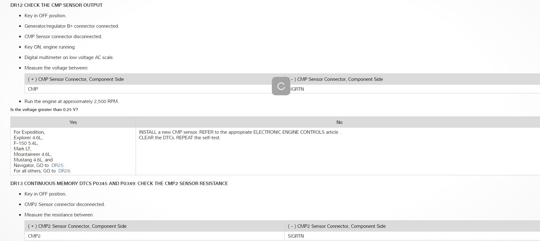

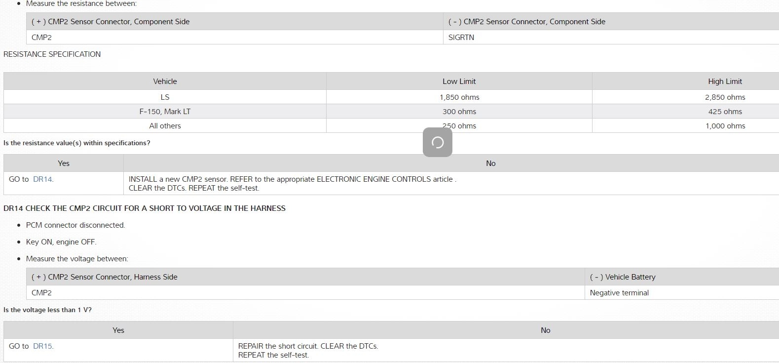

Here are 10 and 11. If you feel okay just having all the steps now then let me know which step you have a problem with or any, I can do that and most likely will anyhow.
12 and 13

We both know that too much noise could cause that code, remember me asking you if the alternator was too loud. I assume they are close to eachother.
If you wan to just skip these steps and replace the cam synchronizer, go ahead. Is it making noise or anything thing else that you know to convince you is it bad?
Just in case he is 13-14.
