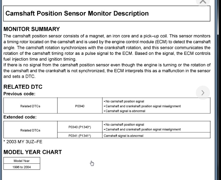

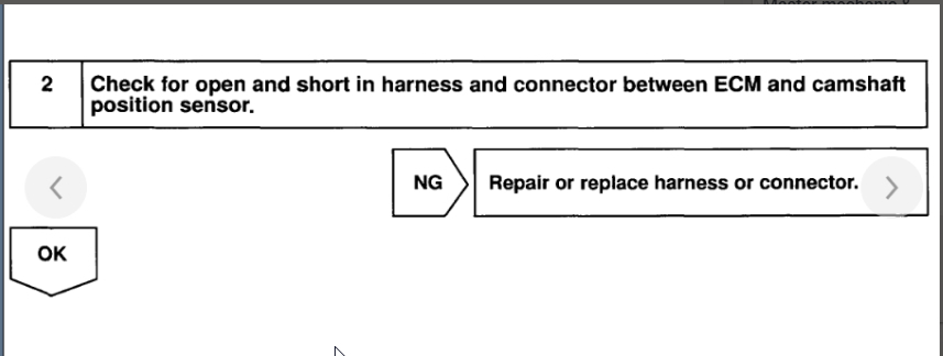

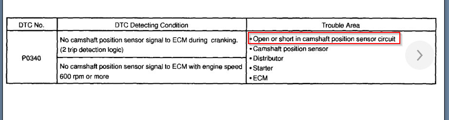

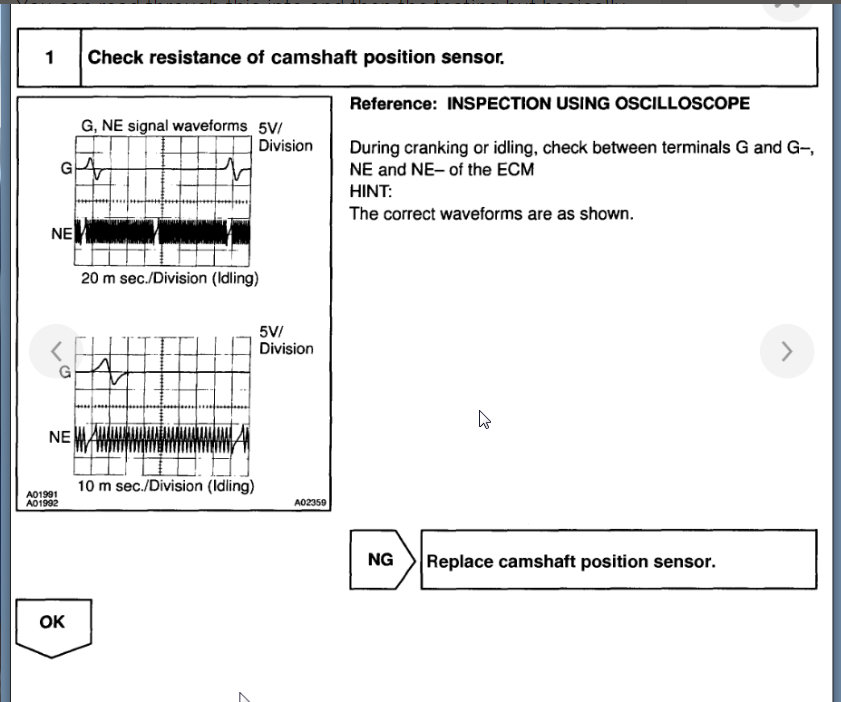

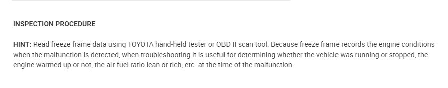

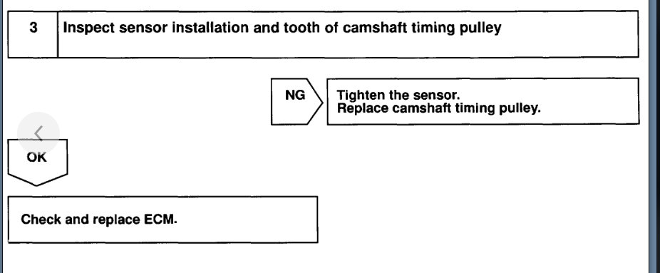

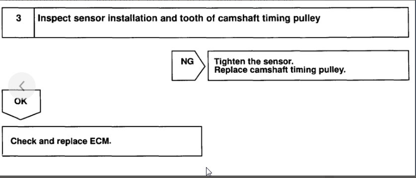

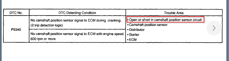

Okay. Great. That is the most common cam sensor code and you are not wrong that it is usually the sensor. However, when that doesn't fix it we need to inspect the wiring and then if that is okay then the ECM is the issue.
You can read through this info and then the testing but basically this test is telling you that the ECM did not get a cam sensor signal. That is either because the sensor is failed, the wiring can't carry the signal or the ECM is failed.
Run through the testing but I suspect step 2 will be your issue. If not, then unfortunately you may need an ECM.

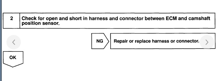

Yes. You can test them by ohm or resistance from the sensor to the ECM. I am not sure which connector it is but it should have 12 wires on it.
This means you need to put one lead at each connector on the same wire. You should have less than an ohm per wire.

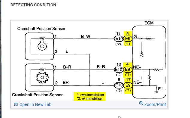

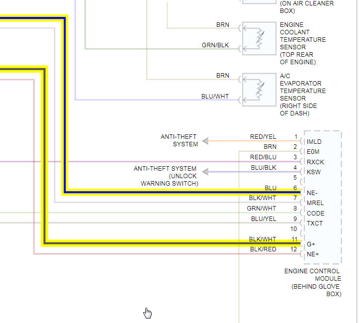

Hi i called about an ECM (used one) and they had all kinds of questions about what the car had and mine is very basic and i don't know if it's japan built or if it has federal or California emissions. My car also does not have anti-theft so is the plug configuration at the ECM different than the picture you sent me. Would you need the serial number from it, because they were saying they would have to run the serial number to make sure they gave me the right ECM.

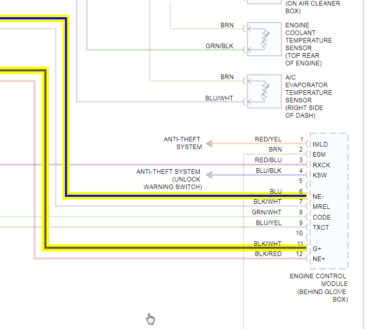

The black/white wire is not where the diagram shows it to be, it's the 5th wire up from the one end, the blue one is different also. The b/w wire had continuity from end to end and not to anything else so i'm guessing it's probably okay but i want to check the resistance yet. The blue one i could not get continuity thru it but when i plugged it back into the computer and checked it to the body it did. I would've done more but my health is not that great so hopefully you can be patient with me. I would like to figure this out myself instead of taking it somewhere since finances are a little tight. Thanks for helping!!
Jan 12, 2020 at 9:04 AM
If they are able to run the VIN to get the right one that that would be sufficient.

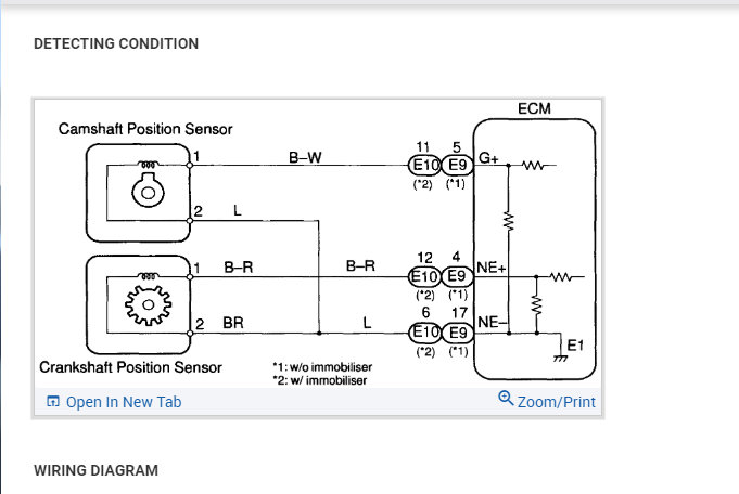

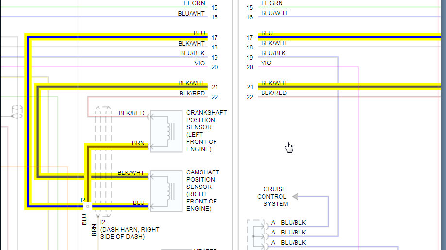

Let's go with this wiring diagram because it has both locations for with immobilizer and without. You will follow the locations that I highlighted.

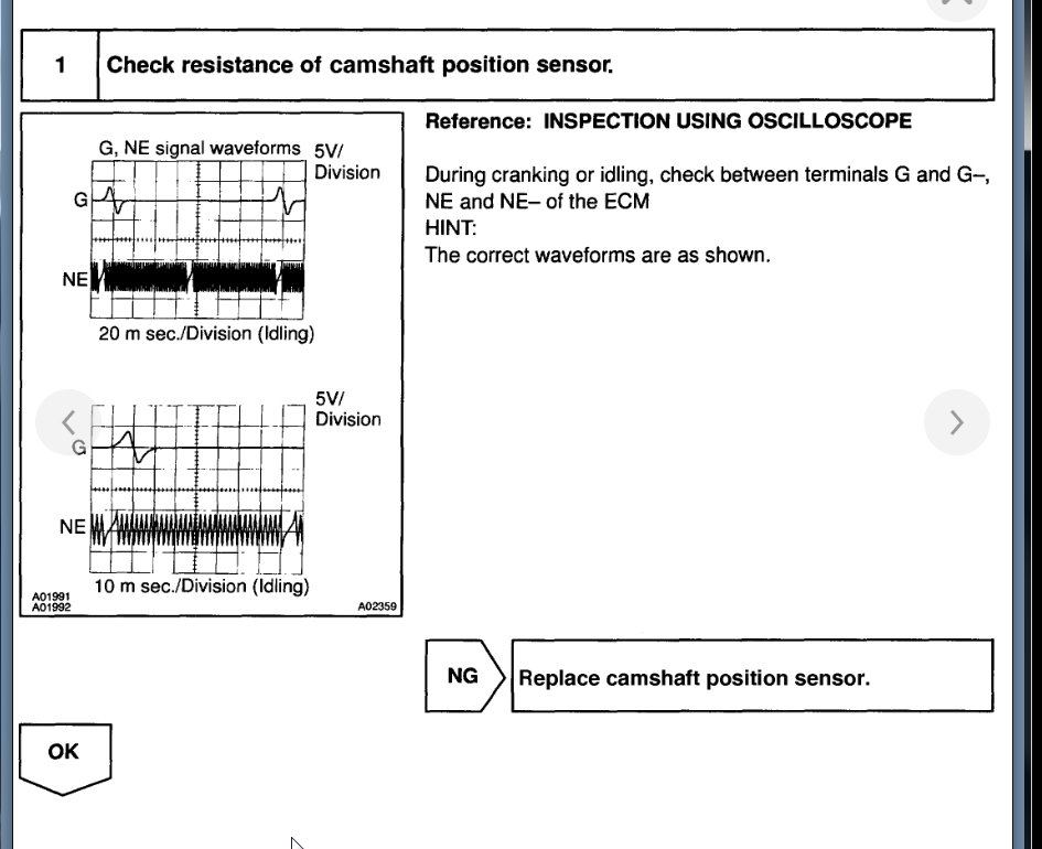

Then just run through this test. Looks like the only thing you have left is checking for a short to power and ground.
However, if you unplugged the wire from the cam sensor to the ECM and did not have continuity then that doesn't sound right. When you checked this did you have the meter leads on the same wire and at both ends at the sensor and ECM?
