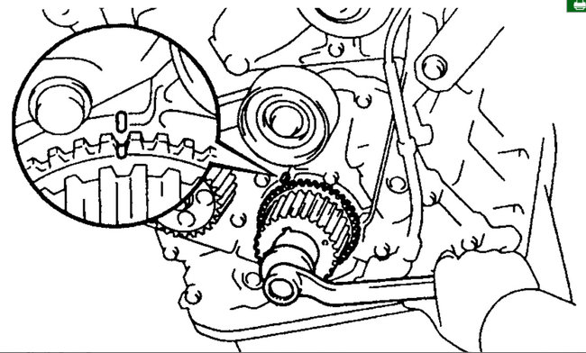

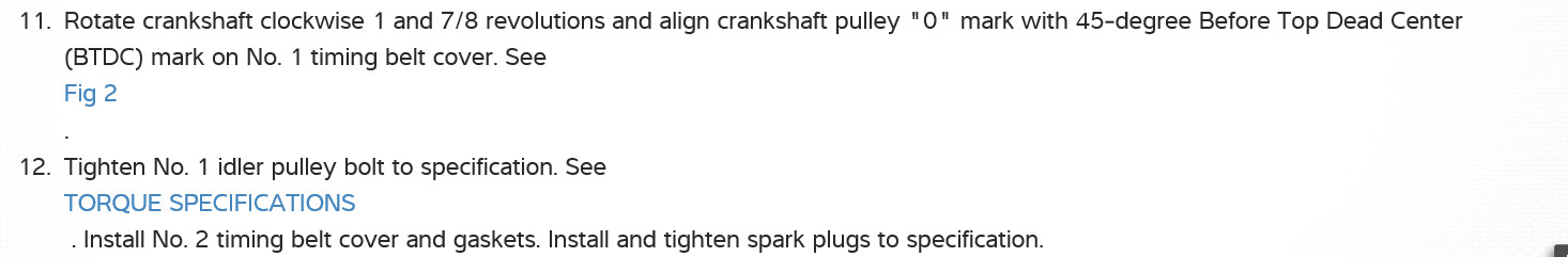

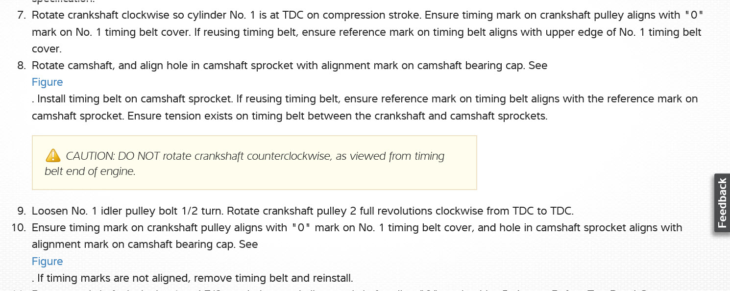

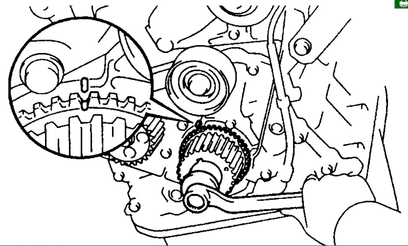

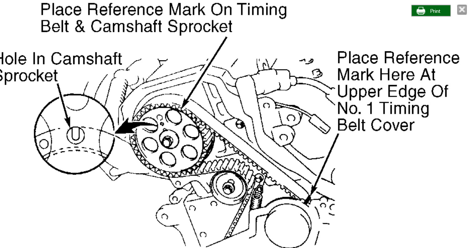

Where are the timing marks?
May 18, 2016 at 11:02 AM
HMAC300
  • 48,601 POSTS
see pics
May 18, 2016 at 12:05 PM
KILL_BOO
Where are the timing marks on the cam and the sequence to take them off?
May 18, 2016 at 1:00 PM
HMAC300
  • 48,601 POSTS
I sent all that in the last reply in the pics. the timing on the cam is done by the pulley and marks.
